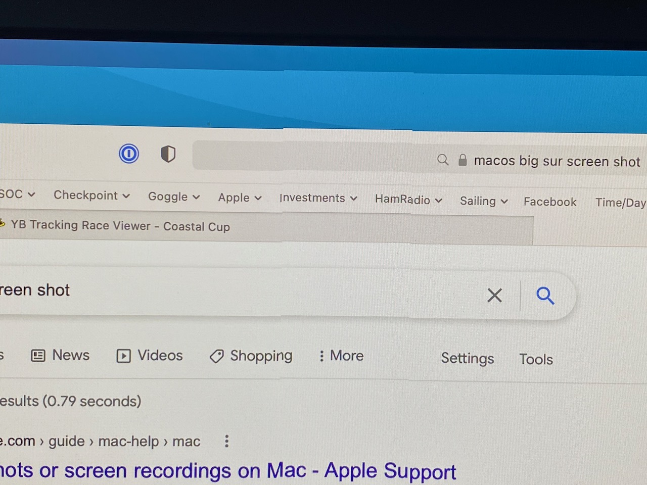

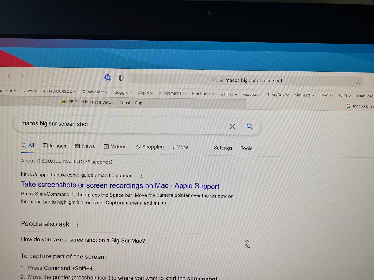

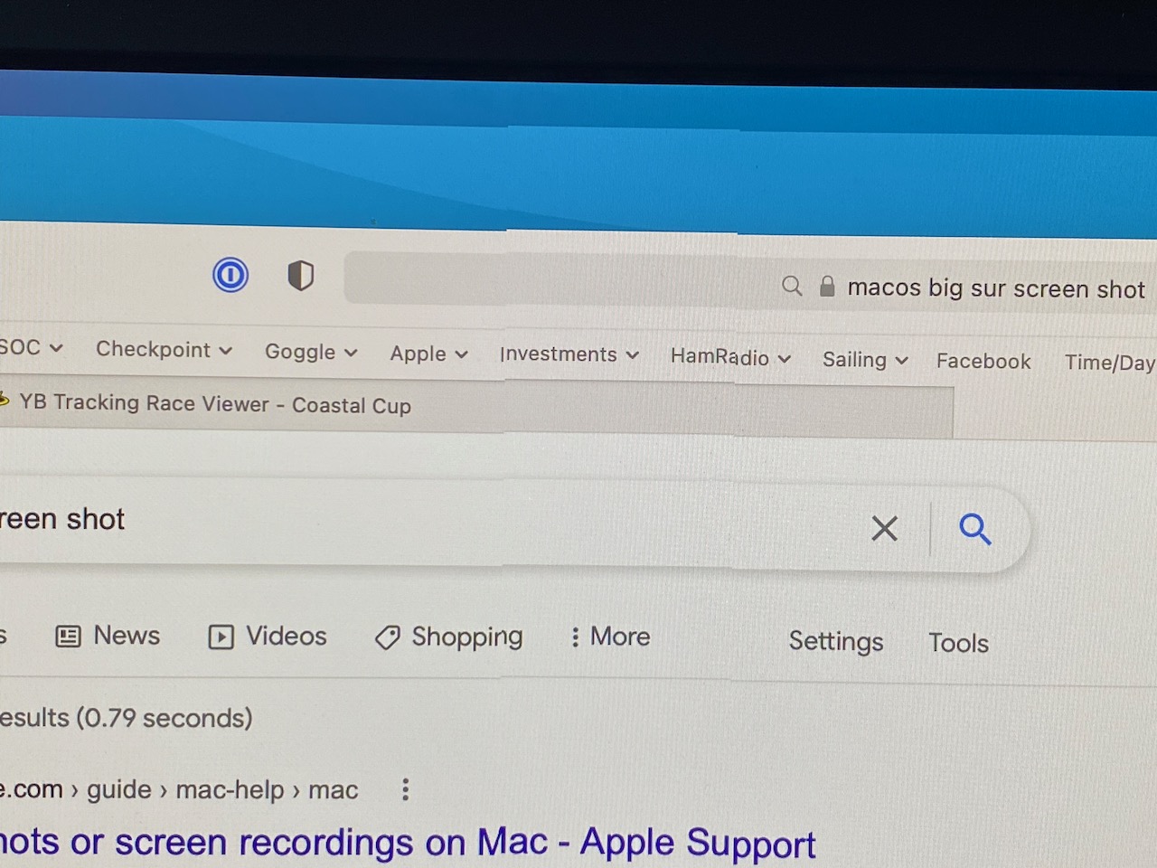

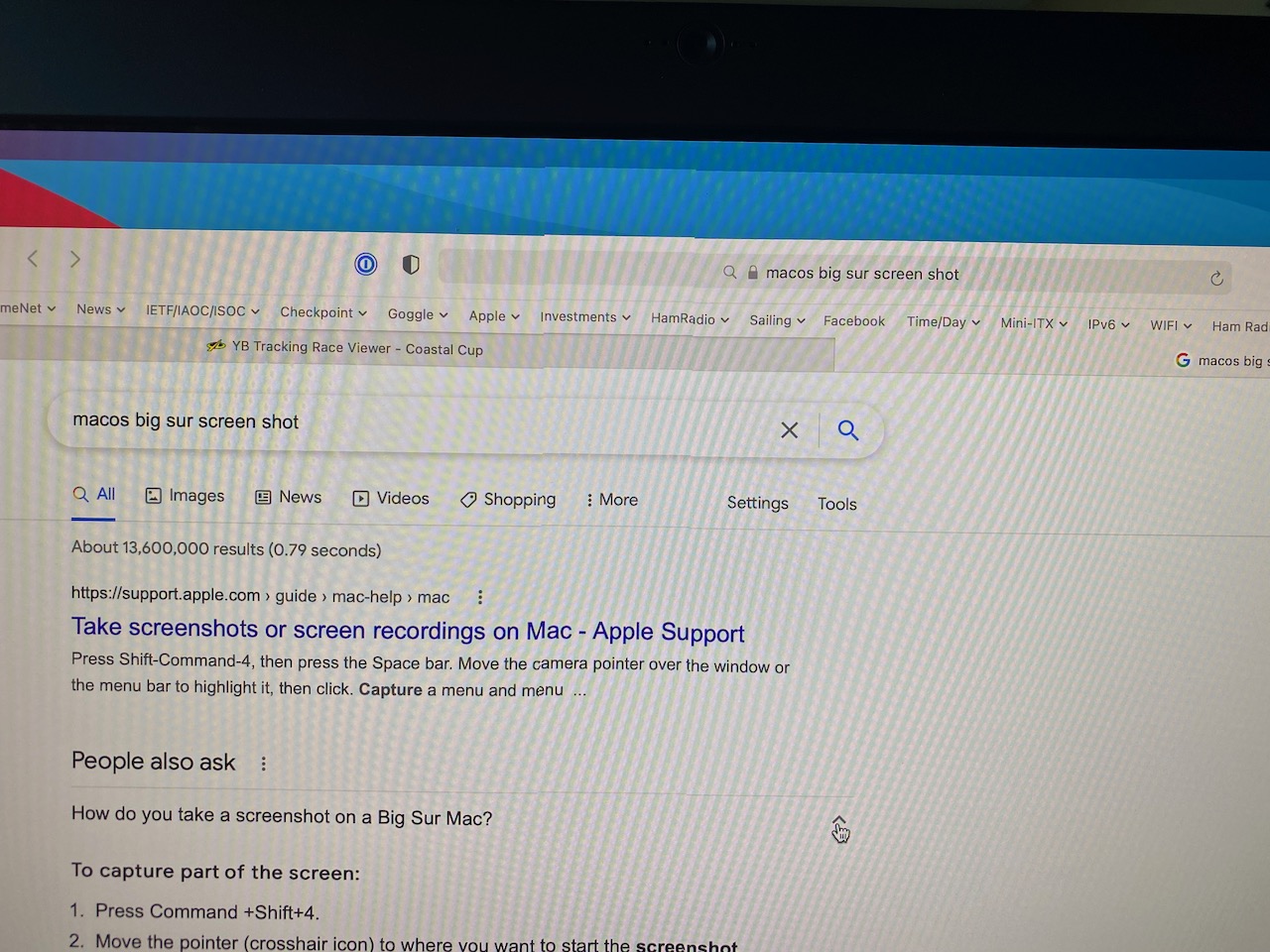

I would like to see more pictures of the pixel shift. Is it exactly in the middle of the display? If so, maybe Apple's drivers aren't syncing the output of the two 2560x2800 tiles correctly. One can imagine that if the outputs aren't within one scan line of each other, then a shift can occur.

Hi joevt,
There are some pictures dotted around the last 20 pages or so of this thread. Likewise if you jump over to Apple's official Support Forum for this topic:
... there are loads over there are well.
Two pictures I took.
That's too weird. I can't understand why it goes up one pixel then goes back down. Does it only happen at 5K timing? If you switch to 4K, it might go away. Maybe if you switch back to 5K then it might fix itself. You have to use SwitchResX to make sure the 4K and 5K aren't scaled timings.
