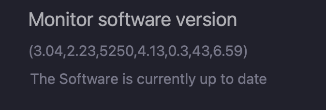

Also what is the latest firmware for the 5k display and how do you update to it? Thanks
Install the LG Screen Manager app to update.
Here is what I am showing as the latest.
