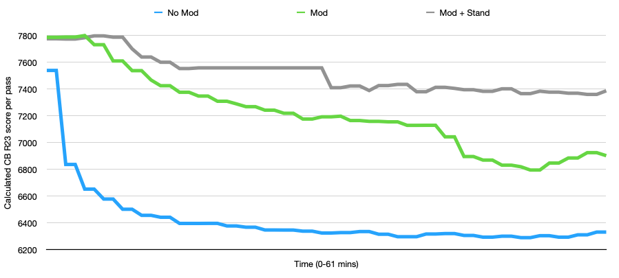

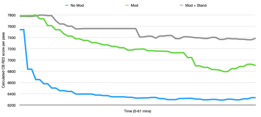

While the Thermal Pad mod will draw the heat away from the processor / memory package more quickly than allowing it to permeate and dissipate, the heat travels into the base of the Air and uses that as a heat sink. Increasing the air flow over the machine will help, even something as simple as raising the back of the machine slightly. I've read of others who just have a silent cooling fan / desktop fan at the side of the machine, gently blowing air over the keyboard.
In my tests, just popping the modded MBA on a laptop stand made a big difference under heavy load, e.g. Handbrake. No fans required. This is the set up I use for serious handbrake compressions running overnight. As the graph shows you get top performance flat out for a few minutes without the stand, essentially until the bottom case heats up. After that the stand and mod does a better job than the fanned MacBook Pro.
Advice: use a 2mm thermal pad. 3mm will have 50% more insulation for the same material.

If your MBA is un-modded (as per this thread), then most of its heat is released through the strip behind the keyboard and the keyboard itself. Clamshell mode clearly constrains heat dissipation.
A wooden desk is an insulator so this too reduces dissipation. This would especially be the case if your MBA has the thermal pad mod.

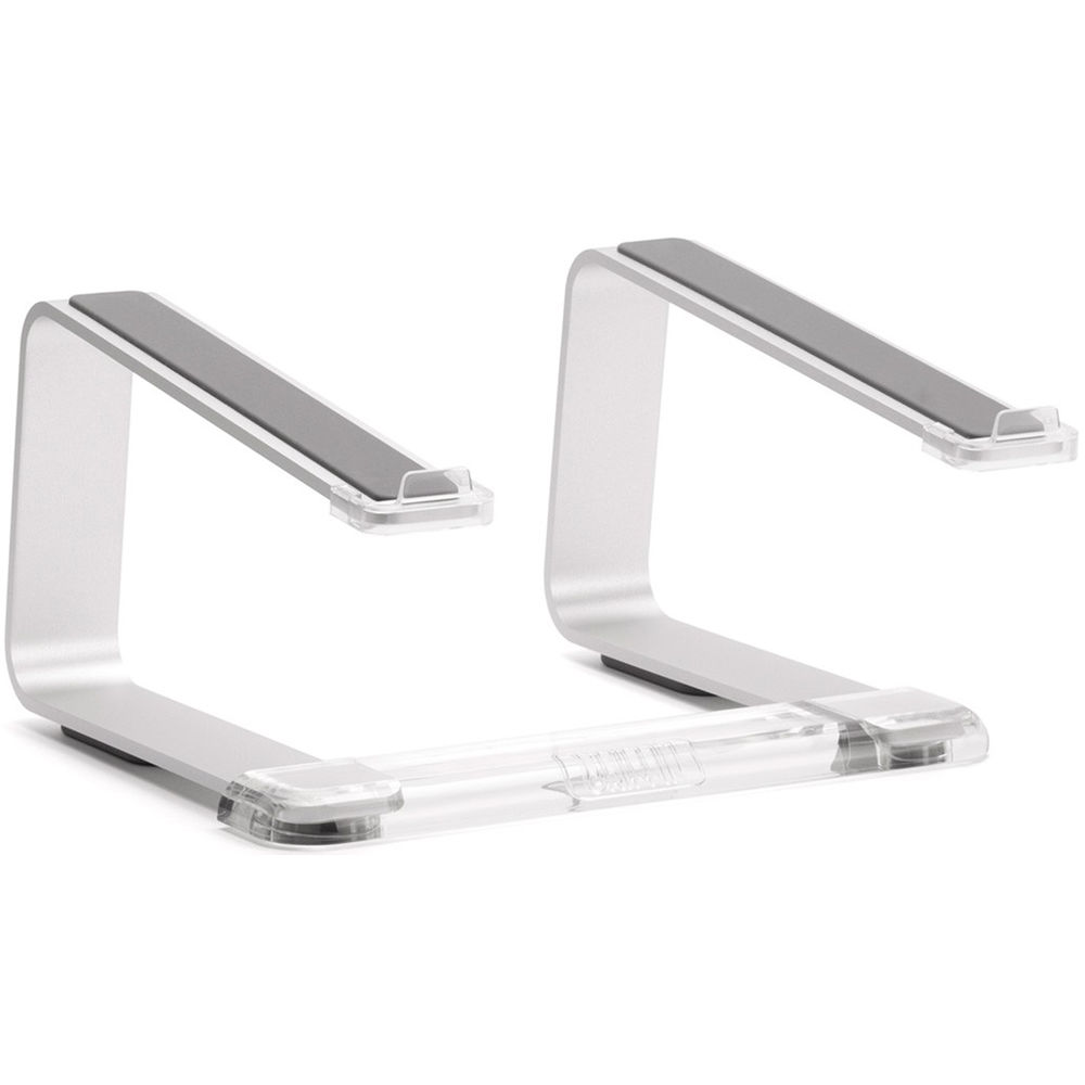

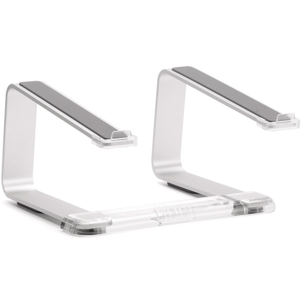

The laptop stand can be found simply by searching for "Griffin laptop stand". I bought mine about 13 years ago on someone else's recommendation simply to make my MacBook better to use in a 'hot-desk' scenario. With Apple's Magic keyboard & trackpad, it is also the ideal travelling companion. I am using it now as I type this travelling in Greece. With the modded MBA, the stand performs the perfect extra duty of lifting the fan-less MBA off the desk and provides an incline to allow heat to escape from the bottom case. I have detailed the percentage improvement in performance the stand alone achieves in the charts and my comments earlier in this thread.
A 'vertical' stand would have the issue of keeping the MBA in clamshell mode and therefore not allowing the heat to escape through the keyboard plate. Maximum air circulation is the key for extracting the potential of the M1 MBA. Others in this thread have used external fans. To me however, one of the beauties of the MBA is its total silence. Besides obvious sound-recording applications without the need for separate booth, it is amazing just how much of the natural environment you can hear without even a quiet fan constantly masking so much of it.
Hope this helps. Tim.

The M1 MBA is designed to release most of its heat through the keyboard plate so, even after the mod, it is a major factor - heat rises! We are talking percentages only. Whatever suits you should be paramount.
I usually keep my M1 MBA on a wooden desk in clamshell mode with a big external monitor. When I need performance, I get out the laptop stand and open the MBA up. It also has a transparent keyboard cover - I am prone to spilling drinks - which I also remove. Those percentages add up (actually they multiply:)) and together they make a huge difference for heavy work.
So yes for top-speed, do the mod (2mm thermal pad - read previous posts) open it up and put it on an inclined stand. Take your compromises as suit you best.
Tim.
