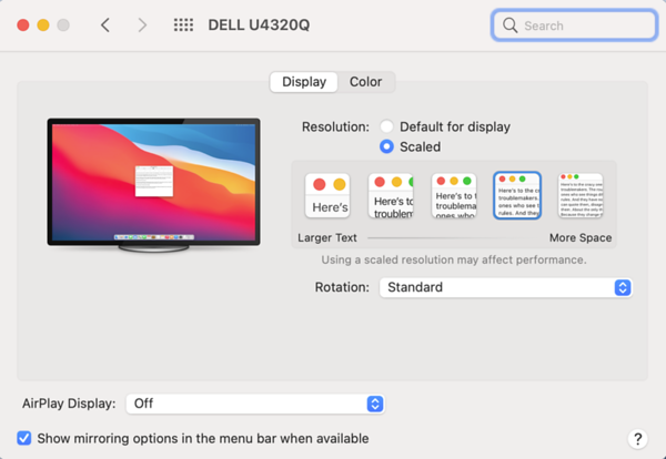

OK, so your monitor is 4K, so native resolution is 3840x2160 and this is non HiDPI resolution. All others (except those marked “‘low resolution” are HiDPI ones. Which one are you using now?
I have it set to the default which is 3840x2160. Does that mean I should change the resolution to something else? Thanks again for your help. I'm having trouble understanding what resolution should be used.
Default is native non HiDPI 3840x2160, I would try 3008x1692, which is highest HiDPI resolution for this monitor and see if you like font sharpness better at the expense of screen real estate (also depends on how far you are sitting from the screen).
For 4K screens, some people prefer HiDPI 2560x1440 or even 1920x1080, depending on distance from screen and the need for screen real estate. You have big monitor, so 3008x1692 makes more sense, IMHO.

Okay thanks. I just changed it to 3008x1692 using the scaling thumbnails and the font does seem quite crisp. I'm sitting about 3 feet from the monitor and I can comfortably read the text.

Cool. This means MacOS is rendering screen at 6016x3384 (and then down sampling to HiDPI 3008x1692), which I think is the maximum resolution for M1 (so that it can work with Apple’s Pro Display XDR).

Nice! I think I'll stick to this resolution and try it out. For some reason, I thought that native was the best quality but it sounds like its better to select one of the scaled resolutions.
