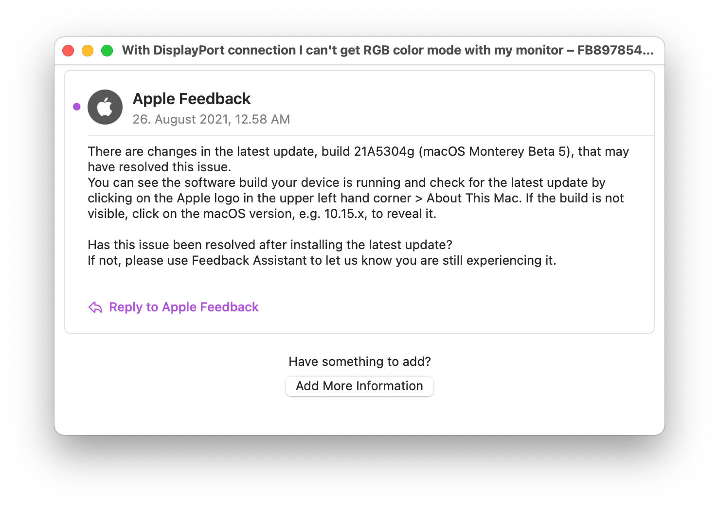

Seems like MacOS 12 Monterey fixed the issue for you so it stays on RGB.
Anyone else who upgraded to MacOS 12 can confirm this as well?

Is this a trap to get me on Monterey beta-train? 😅

Can confirm now that this was bullcrap... Nothing is fixed in Monterey regarding RGB mode detection. It still defaults to YPbPr if I for example change display orientation. Luckily plist editing still works.
Glad to hear plist editing works in Monterey too because I read somewhere in this forum someone saying plist format was changed in Monterey and was not working anymore and that got me worried.
