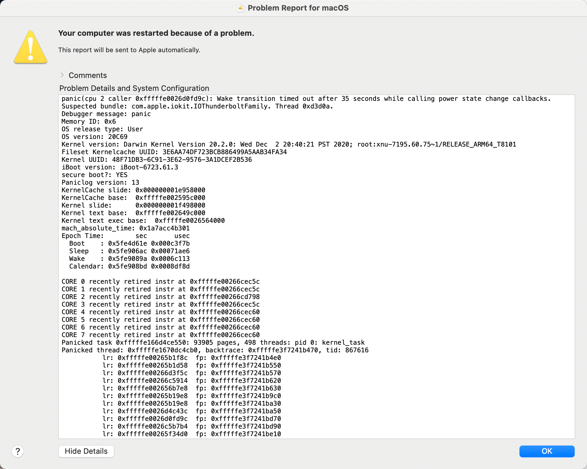

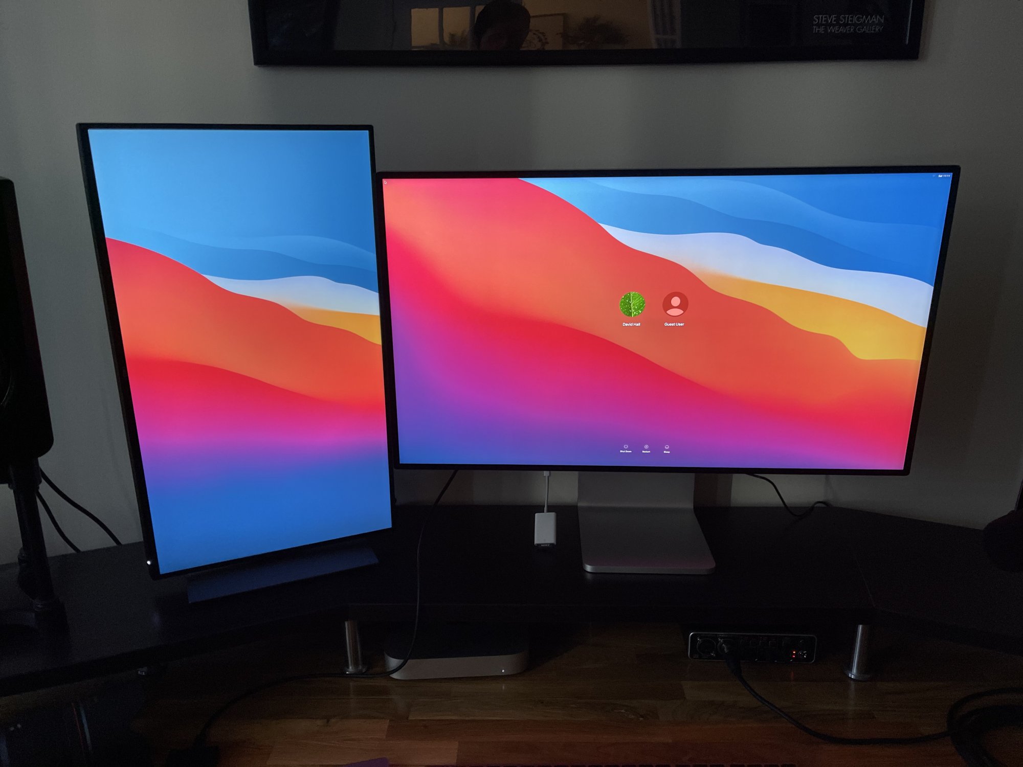

I noticed something very strange after receiving my M1 Mac Mini. Normally I don't turn off my computers and I use sleep instead. I noticed that my M1 Mac Mini crashes while sleeping. Twice when I woke up I was welcomed by turned on monitor and page where I should enter my account password. After booting to macOS I was told that my Mac restarted due to some serious problem.
Am I alone with this? I must say that I've stopped using sleep mode because of that and I'm waiting for some macOS update to fix this problem.
TL;DR - sleep mode on my M1 Mac Mini is completely unusable right now. It should be okay when you're using it for short period of time, but you shouldn't do it when using sleep mode overnight.

The first few days on my M1 Mac Mini had a reboot every night, with a Crash Report showing a kernel panic when I logged in again in the morning. Looked like it had something to do with Bluetooth running out of threads when system went to sleep. I set the system to not sleep as a workaround and the problem went away. Hopefully fixed with the next update. Apple has probably received LOTS of crash reports on this issue!

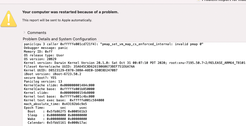

This was the mysterious one - a kernel panic message after it went to sleep and then restarted:

Having the same kernel panic on M1 Mac Mini overnight. Wake up to to both monitors on the login page and the panic report once I login. So from November til now they have done nothing. seems hopeful lmao

M1 Macs are having massive problems with kernel panics while attempting to put thunderbolt devices to sleep via power management. Apple is receiving TONS of kernel panic logs but pretends they've never heard of the issue when called via tech support. It appears Apple is pretending the issue isn't real.
You can find instances all over the internet with people complaining about kernel panics and many thunderbolt devices (monitors, raid arrays, TB hard drives, thunderbolt docks, soft raid programs loaded onto external raid arrays, etc). People are also complaining about monitors connected via HDMI. Apple has a massive M1 problem on its hands and so far is pretending it doesn't exist.

Same as others describe, I woke up to the monitor on login page, and the report after I log in.
