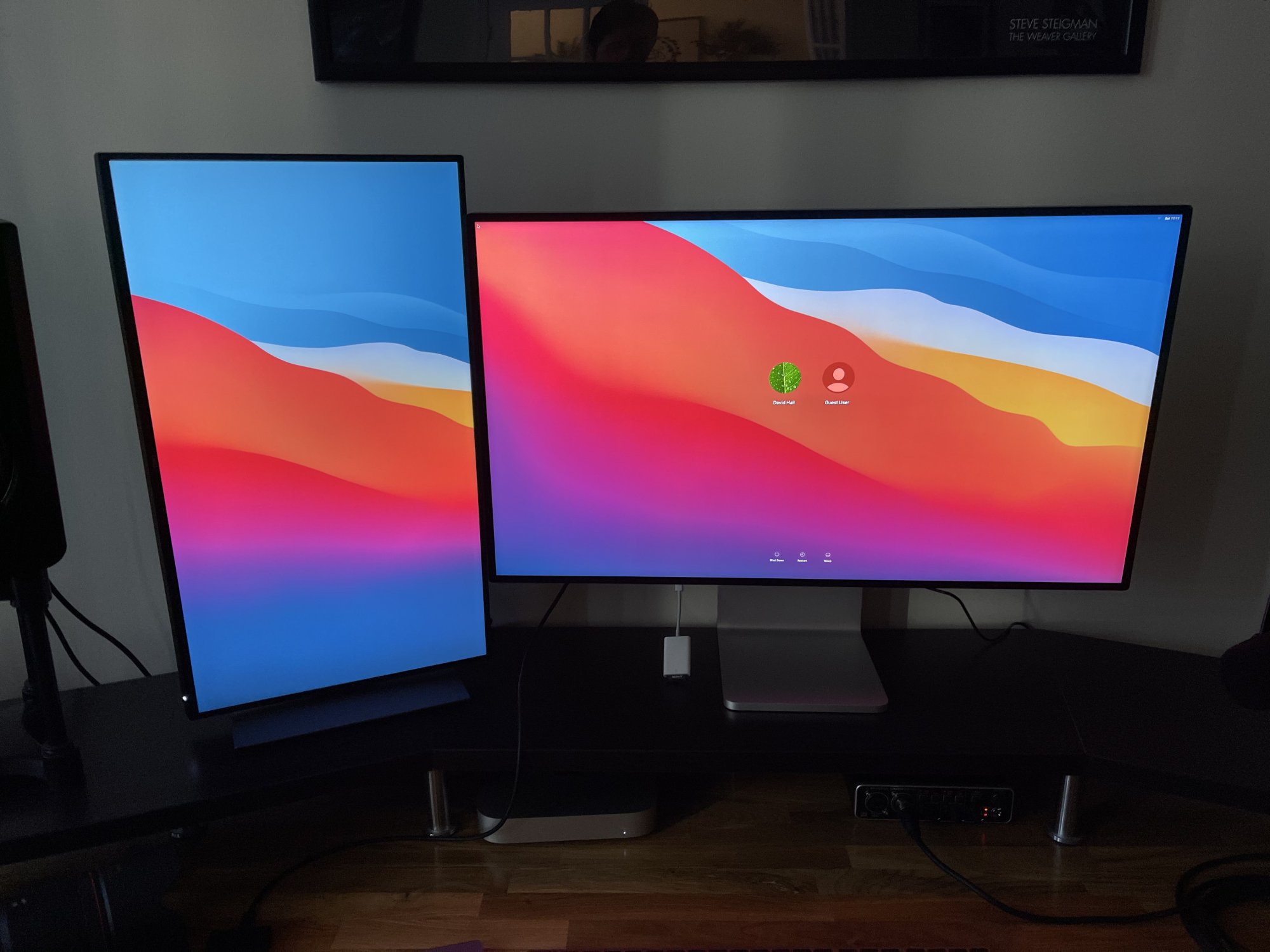

Also to note, every so often, I'll see the little pink pixel squeares spread-out across the screen as seen here: https://www.macrumors.com/2021/02/21/pink-squares-external-display-m1-mac-mini/
I'll do a test tonight by unplugging the dongle to see if the problem still occurs.
Yes, I chose APFS (Encrypted). However, it worked already without encryption, so simply reformatting from scratch and reinstalling made a difference. Encryption is not a factor in this case I think.
After more than 2 weeks it happened again. I went in into my room stunned by creepy login display 😱 not again... seriously can one return the mac mini m1 with this issue to apple? I bought it 3 months ago and because of this I’m seriously thinking switching to iPad Pro and say goodbye to mac 🖥 for good...
