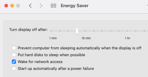

Okay quick update on the wake from sleep issue--I went into settings last night and unchecked "Put hard disks to sleep when possible". I left my computer on so that it would go to sleep over night and when I woke up this morning, the monitor woke up along with my M1 Mac mini when I pressed on my keyboard.
Can someone else test this and see if it solved your problem? I'll continue to monitor this situation as well in case the problem comes back again.
Edit 1: I've had my computer fall asleep due to inactivity 3 times so far today and it has woken up my monitor successfully each time. Unless the problem returns again, this seems to be the solution to my sleep-wake issue.
It was good while it lasted. The problem came back again.
Interestingly this time, I was not able to get my signal back on the monitor by unplugging the HDMI cable on the monitor side and plugging it back in. Instead, I had to unplug the HDMI on Mac mini's side and replug it. This further leads me to believe that there's something wrong with Mac mini's HDMI port or drivers.
Sorry I'm new to MacOS, but are there any system logs on MacOS that I can view to diagnose what's causing this?

Good suggestion. My energy saver setting was off already, but I didn’t even think about that.
This is difficult to troubleshoot because I can’t reliably reproduce the phenomenon.
