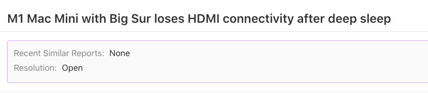

I would encourage everyone to log an issue with Apple about this, providing as much details as you can:
I logged mine under macOS -> Sleep/Wake -> Display did not turn on at all
Based on the "Recent Similar Reports", the right people may not even be aware.
