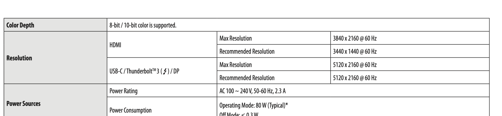

This is a hell of a long thread! Im sure my answer is in here somewhere, but I cannot get my 34WK95U to display in 4K resolution using an HDMI 2.1 cable. What could I possibly be doing wrong? I AM able to get Hi DPI, but its in a super weird aspect ratio that doesnt cover the entire screen. Even using BetterDisplay and SwitchResX, no dice. It works properly with a DisplayPort -> USB-C cable, but I want to use HDMI for my use.
The monitor does not support it's full resolution using HDMI, no matter what cable you use :/
