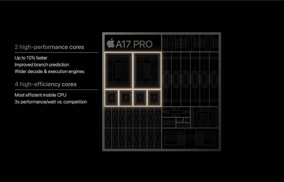

Didn't Apple say that the A17 Pro was designed on a new micro-architecture with it being wider or something like that?
Reactions: quarkysg

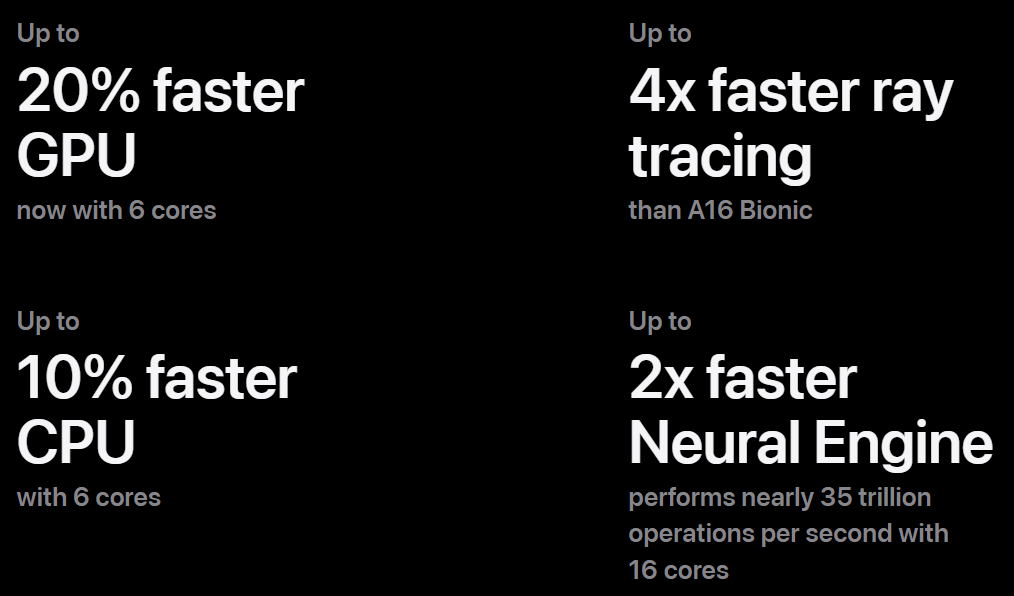

Apple didn’t even claim the a17 pro cpu (not gpu) is 10% faster. They only stated the performance cores are up to 10% faster. There’s no performance gain for the efficiency cores, which according to Apple are used “most of the time”. In other words, most of the time there’s no performance difference compared to the a16, and only some of the time there’s a meagre up to 10% performance gain.

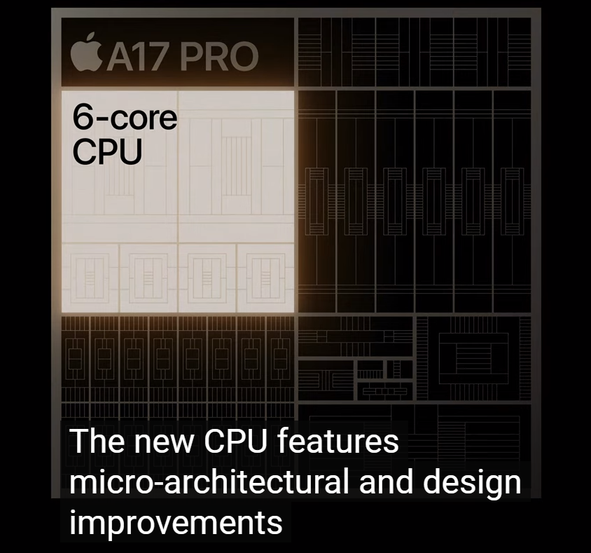

They specifically called out on a slide that there are changes to branch prediction (and we have a pretty good idea what those are) and increases to decode and execution width.
Point is not that these are the only changes, but that these are changes that you don't get from "just a die shrink".

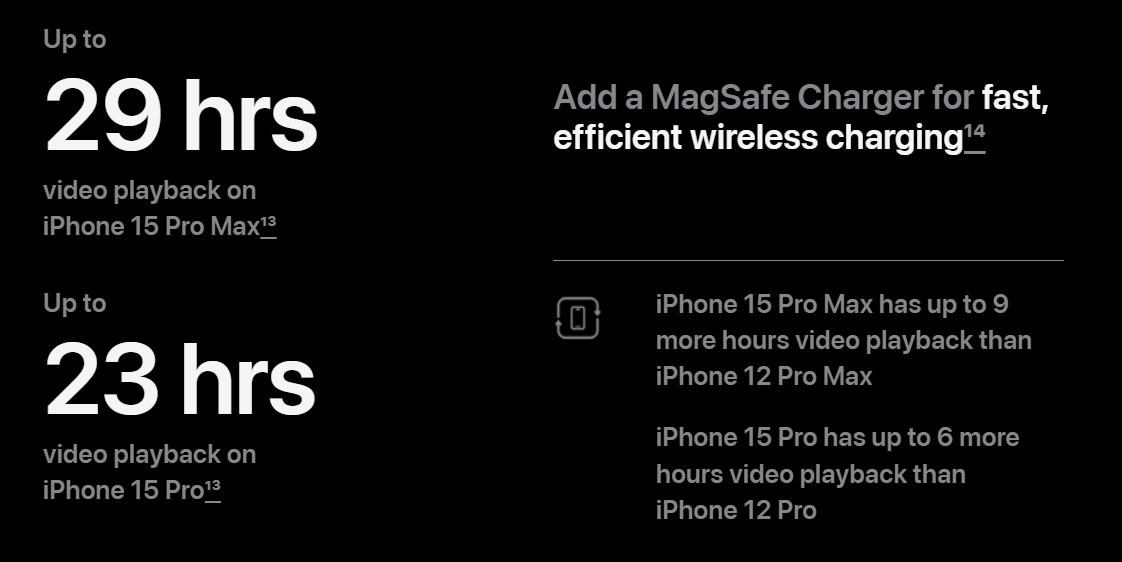

Battery life is now "problematically" correlated with better CPU/GPU efficiency. Look at what Apple tells you on the Tech Specs web page:
Video playback (in both versions) depends on screen, media block, and network – NOT on CPU or GPU. Same for Audio playback.
They matter (insofar as they are useful info to people, eg going on a flight) but they are NOT for example

Not true. Apple shows the improved CPU and battery life on the website.
