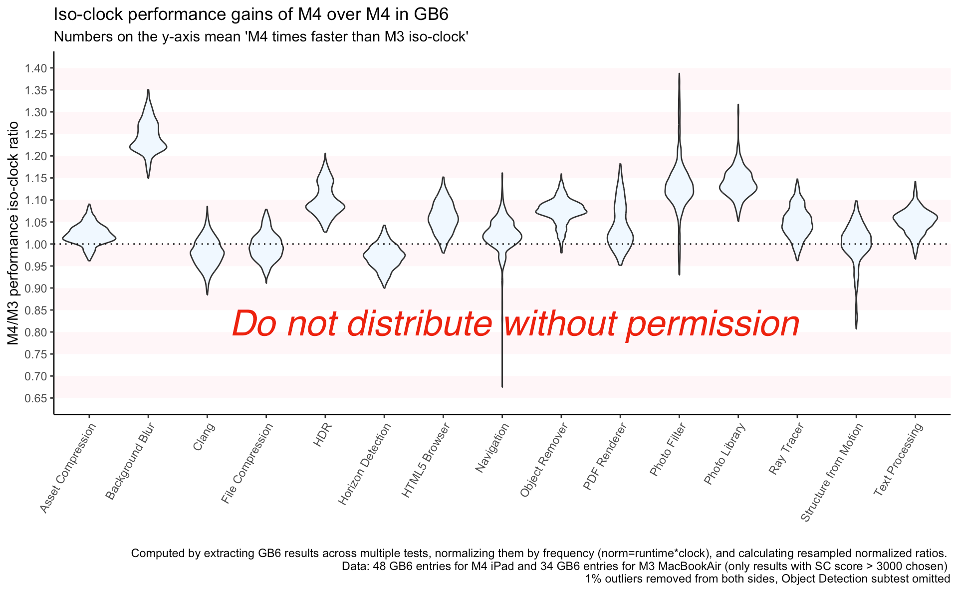

Here is a slightly refined version of the analysis @crazy dave did. I took multiple GB6 results, normalized them by frequency, resampled the values, and plotted the resulting ratios. Here, 1 means same iso-clock performance, >1 means M4 is faster, <1 means slower. For tests where M4 is consistently faster than M3 the bulk of the distribution will be over 1.

Great work, but if possible for future efforts, I'd suggest shade-banding on the Y axis. That would make it much easier to follow as your eye moves right along the X axis. Even two alternating backgrounds every .15 or .2, say, would be great. If that's not feasible with your software, maybe just dark grid lines every so often.
That’s a great suggestion. I didn’t have much time to tweak the plot, hence default settings. I agree I should have at least highlighted some of the ticks.

A line at y = 1 would be easy to add. But how do you compute M4 minus M3 performance given that data aren't paired?

Resampling. I pick 10000 data pairs at random with replacement. And I calculate ratios, not differences.
Yes ratios of course.
I wonder how I would proceed if I wanted to estimate a ratio between independent variables. I don't think reviewers would like the idea of generating artificial pairs, but a bayesian estimate would be much more complex to obtain.
Nice plot overall. If I'm allowed to nitpick, I would put the line a y = 0 behind the violin plots.
What I am doing is essentially comparing the distributions, and resampling techniques like these are fairly commonplace in academia. So I don't think reviewers would mind that particular bit, after all, the observations are not correlated.
If you want to apply statistical testing to it the trick would be finding a suitable model. I suppose one would look at Cauchy distribution since it describes the ratio of normally distributed variables, but I am not knowledgeable in that particular domain and don't have an intuition.
For simple estimates however working with the bootstrapped empirical distribution like what I use works very well. E.g. you can easily evaluate how much of the probability mass is > 1 or < 1, which will give you an idea about a possible effect strength and its direction. This particular application of probability follows the spirit of Cox's theorem in the sense that we can quantify our certainty about a variable by exploring the contrasts in its behavior.
Do you mean y = 1 (the no difference baseline)? I updated the plot this morning adding the baseline and a shaded background to make the plot more readable.
