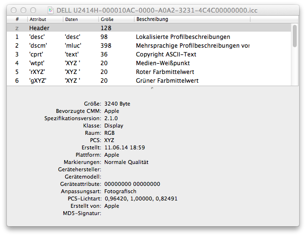

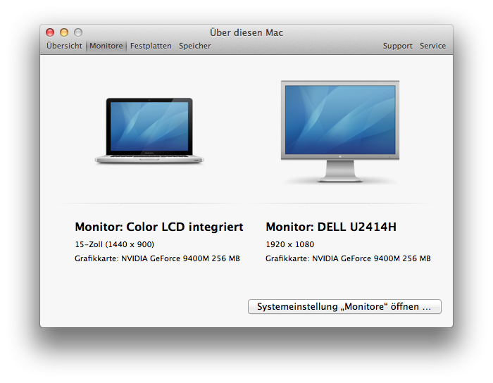

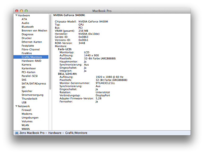

Hello everyone,
this is my first post and sorry for my English.
I bought the Dell U2414H and hooked it up with my MacBook Pro Mid 2009. It has the Nvidia GeForce 9400M inside. In near future the display will be connected with a 2012 Mac mini with the Intel HD4000 inside.
My question is: how do I recognize that my setup suffers under the problem that is discussed here? By now, I can give you following details.
On the monitor side:
  • I own the revision A00
  • I use the original Display Port to Mini Display Port cable
  • When I first connected the monitor with my MacBook Pro the Display Port Mode 1.2 was automatically disabled
  • The Dell OSD menu tells me that the monitor is running with RGB input format, Mac Gamma and sRGB mode
  • For my eyes, everything looks fine
On the MacBook side:
  • I runs OS X 10.8.5
  • "About this Mac > Monitor" tells me that I'm using "Monitor: Dell U2414H"
  • "About this Mac > System > Grafik/Monitor" tells me "TV: Yes"
  • "System Preferences > Monitor > Colours > Open Profile" tells me "Colour Room: RGB"
I added some screenshots of all this stuff. It would be great if somebody could help me out with this so I can settle down and don't have to worry anymore about a wrong display setup.
Thank you very very much in advance,
Martin

Hi,
I am sure your problem must have been sorted out by now, but for all current and future buyers for the dell U2414H and having an apple computing device, mac, macbook, pro etc, the monitor works perfectly out of the box when I connected with a mini DP(thunderbolt port) to HDMI output (U2414H), it just ran out of the box, without any issues, it even worked simply for my bootcamp windows. So no need to fret before purchasing one, simply go ahead and get it, it's the Monitor with most appealing edge giving you only a screen to view at, I was also considering between the U2412M and the U2414H, I think I've made a great choice. :)
