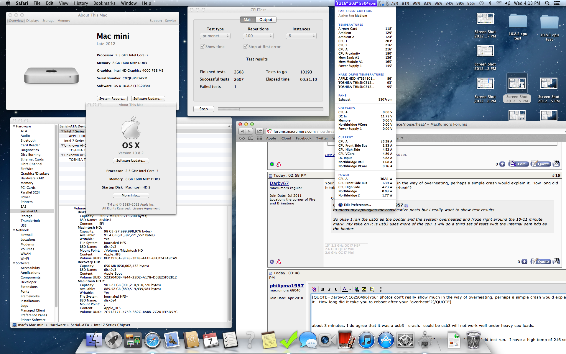

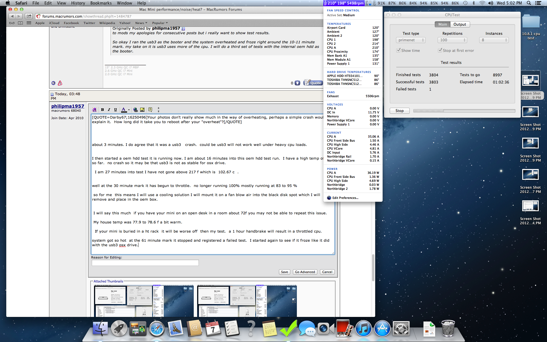

CPU throttle starts at 105C, right?
Any idea why it isn't throttling while it did a couple of days ago? :confused:
(I haven't done any further tests yet.)
I have done tests with 3 different booters.
the toshiba in the lacie it passed a 15 minute test 100 % or 99%
I did it with the samsung 830ssd in the usb3 system shut down.
finally on a longer test with the oem hdd i got throttling.
I even had the test fail twice.
this is not supposed to fail. it is a legit test for high load use.

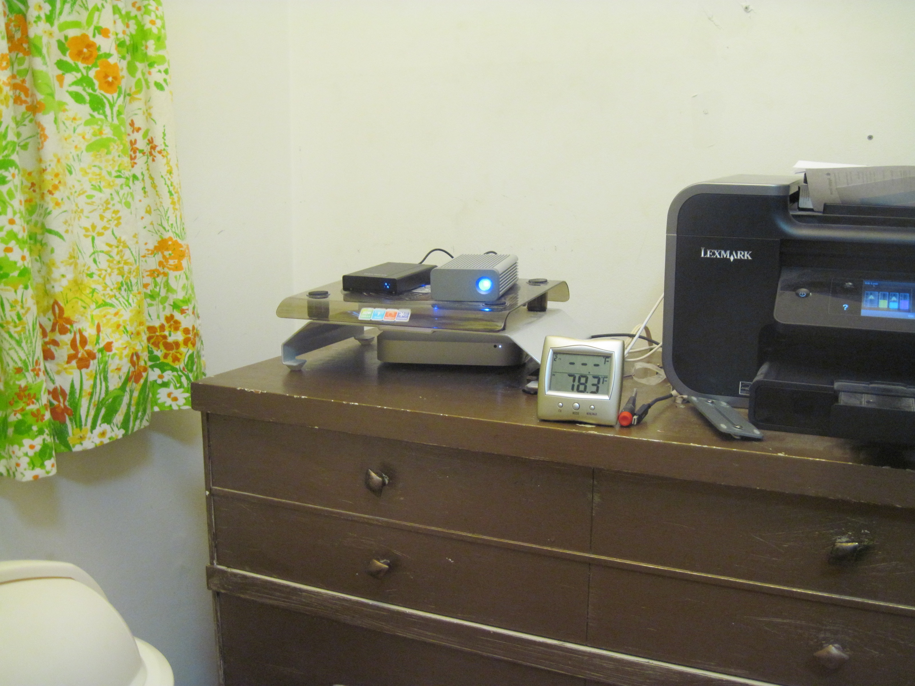

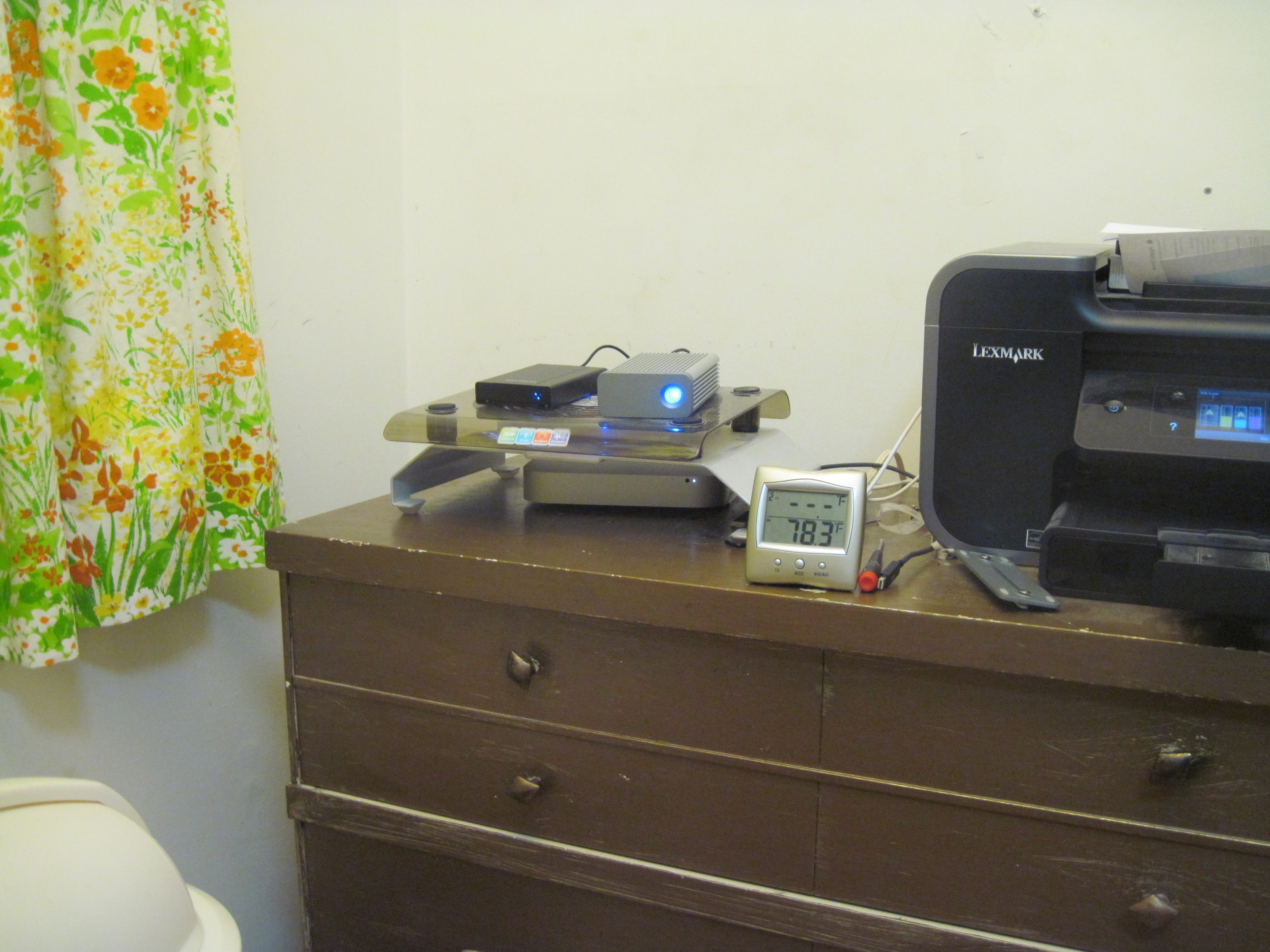

here is a photo of my room temp.
it took about an hour to get good clean evidence of throttling. my home temp has been 77.9 to 78.7.
my guess is the hardest way to run osx is with usb3. usb2 stressed cpu more then fw800 or fw400.
my tests with really fast throttling the other day were all with usb3.
today I started with t-bolt as the booter.
t-bolt is supposed to use very little cpu so the 15 minute test was too short or it could be that I found out the best way to run handbrake is with t-bolt booters more tests are due.
the second test was usb3 i was annoyed that the first test was no throttle so I knew something was up I went back and saw I had done usb3 for the old test. well no throttle just a crash at the 10 minute mark at 216 f.
I figured let me do a longer test if you run 2 or 3 movies in a que handbrake can run for 3, 4 or more hours.

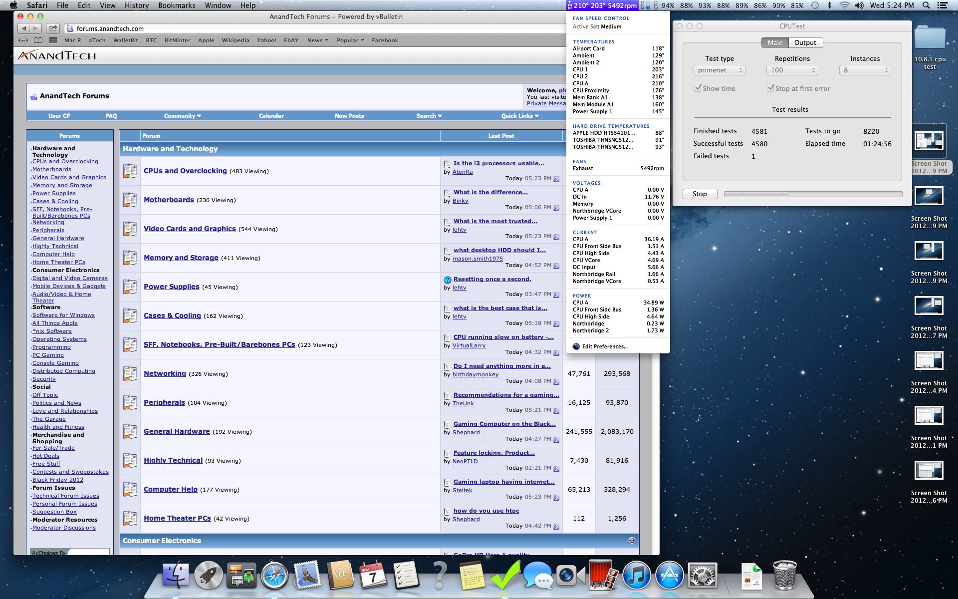

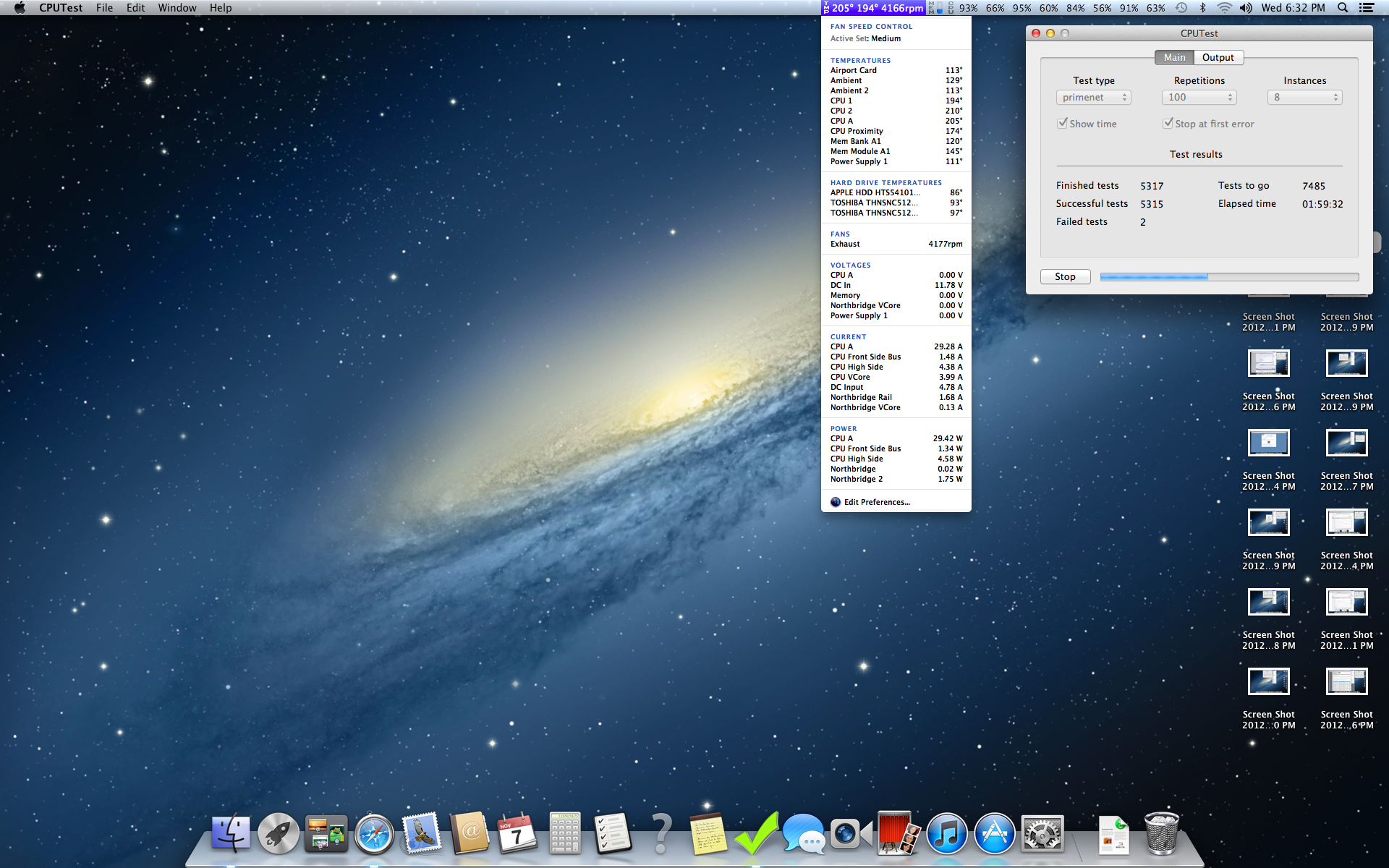

so I am running a 4 or 6 hour long test throttling started at the 30 minute mark mark a fail at 1 hour.
restarted throttling started at 1 hr 10 minutes a fail at 2 hours. still running I am at the 2 hr 30 min mark.

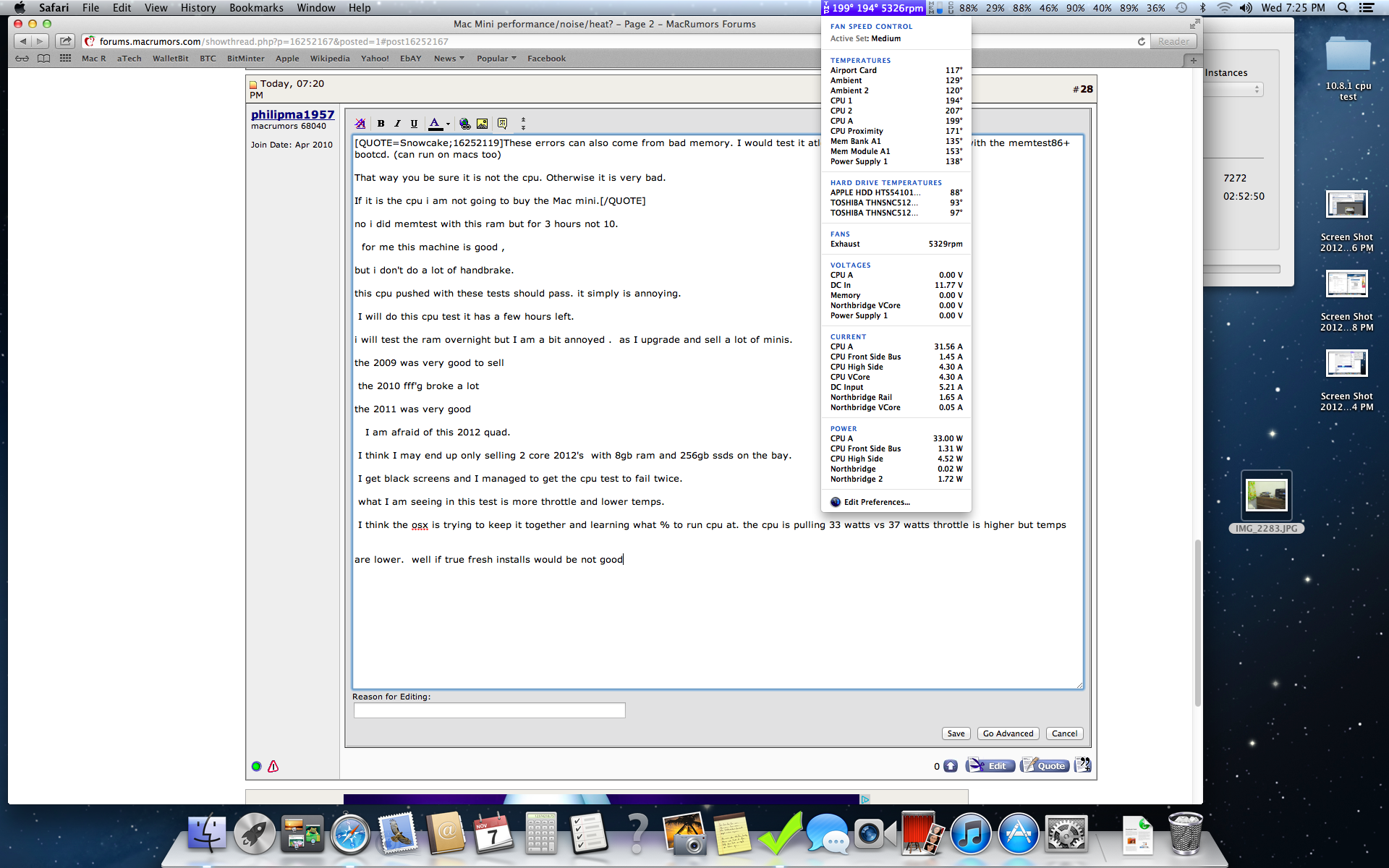

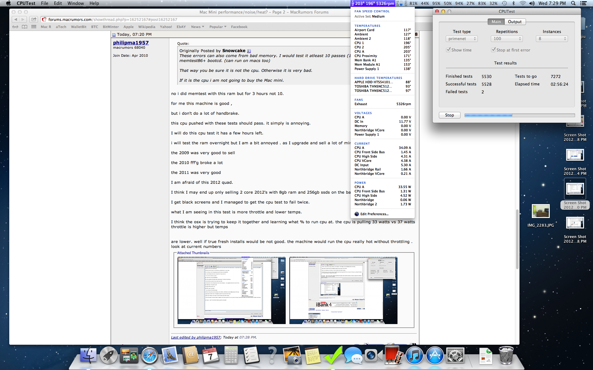

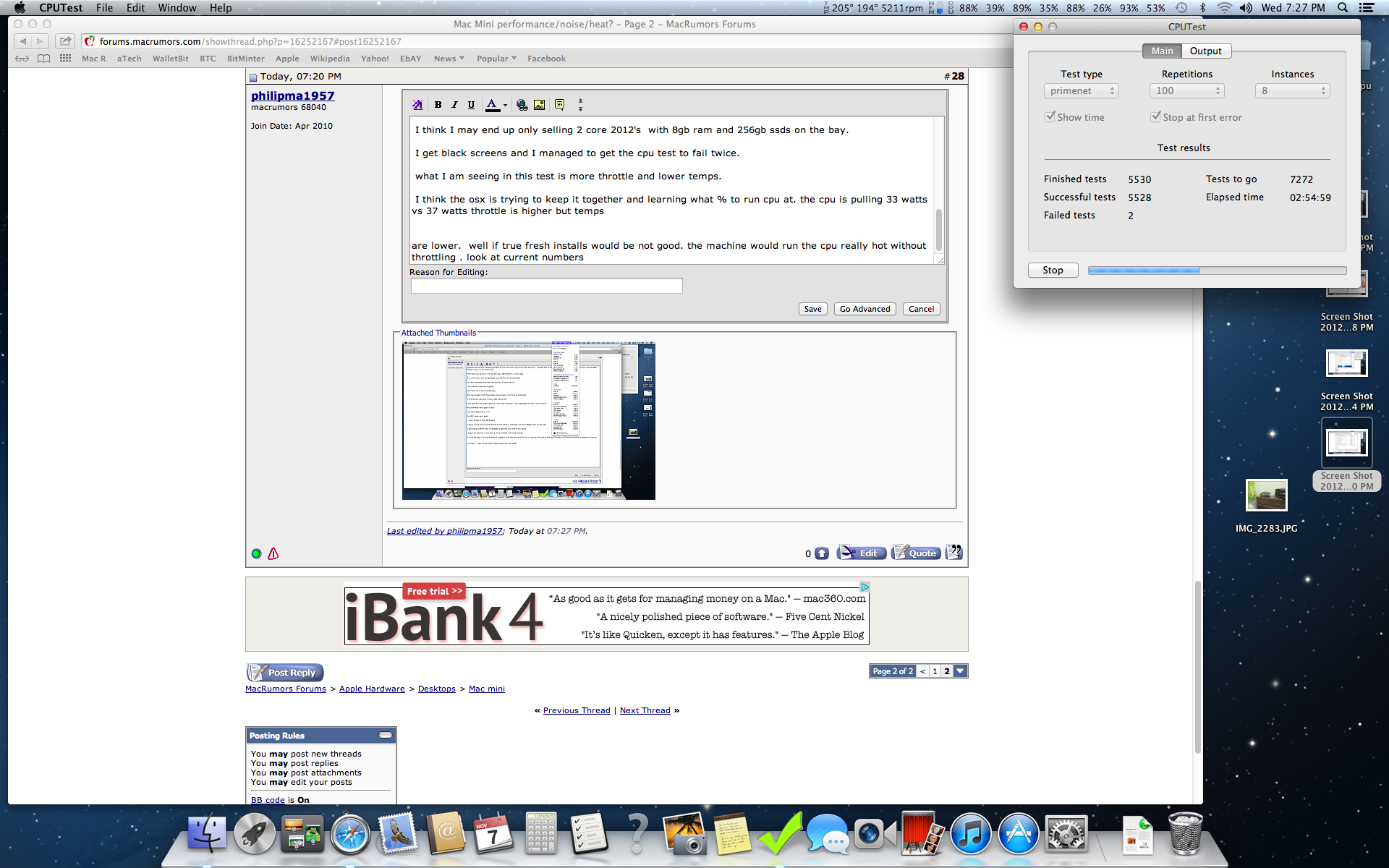

I get black screens and I managed to get the cpu test to fail twice.
what I am seeing in this test is more throttle and lower temps.
I think the osx is trying to keep it together and learning what % to run cpu at. the cpu is pulling 33 watts vs 37 watts throttle is higher but temps
are lower. well if true fresh installs would be not good. the machine would run the cpu really hot without throttling . look at current numbers

As for the oem drive… Can't believe this is actually happening. I gotta do some more tests but I'm full of work right now so can't. Mine is the SSD though.
What i wanna try is:
1. Putting the Mini in a different location, as it seems to be around 3ºC hotter in where I have it now plus the Mini being surrounded by wood on one side and two hard drives in the other.
2. As soon as I receive the bottom cover I ordered off ebay, mod it to get free air intake in the antenna plate area. (I'll install a dust filter). Compare it to running the Mini bottomless and see.
My prediction is the Mini on the table with more ventilated atmosphere will do fine with no throttle, so my intention is to put it right where I have it now with the modded bottom cover. I assume it'll do just fine. As a last resource I can always add a USB and quite fan to move the air around a little bit more and help the Mini cool better.

I wanna make clear though that my mini doesn't suffer any instability. The thing is it gets too hot therefore the CPU has to throttle itself avoiding it to work at 100%.
Not a big deal as I haven't seen it at 100% except for when I run these benchmarks, lol. But still annoying.

OK. Did a quick test.
Put CPU in Primenet, 8 threads, unless run. Hit start. CPU immediately went to 100% CPU use.
After 1 minute CPU was at 98ºC approx, fans still at 1800rpm (lol).
After 1 minute and a half, it was at 103ºC and fans started to spin up. It got to 5100rpm and temps started to drop a little bit. (CPU still at 100%, no throttle at all).
After 5 mins, temps had droped to 96-98ºC and fan had slowed down a little bit to 4400rpm. It's been running like that until temps had gone up a little bit (97-99ºC) and fans went up again to 4800rpm. Temps then stayed in the 96-99ºC bracket.
The thing stayed like that until min15 of CPU test, no throttle or errors at all.
Gotta say room temp is a little lower right now. Maybe 20-21ºC. Also house's heating is not on yet (obviously, lol), and I got one room window slightly open so there's ought to be a better ventilation.
Pretty happy to see it do just fine. Only problem I see even if if doesn't throttle is fan noise. What I noticed with the 2010 Mini, aside from temps being lower with no bottom, is that fans needed to run much slower in order to keep temps.
So hopefully when I mod the bottom cover I'll be able to get lower fan speeds therefore less noise at 100% of CPU use.
OHH!!! And something else. This CPUtest is buggy all the way. Remember what I said when closing it? Well, I had only testes with my 2010 Mini which has just 2 threads.
When stopping it in this 2012 Mini this happened:
1. "Stop". CPU use goes down to 88%. I guess it stopped 1 thread.
2. "Stop" again. CPU use goes down to around 75%.
3. "Stop" again and app crashes. I ignore the error message and CPU stays at 75% and temps pretty high.
Checked top processes and they there still were 6 processes consuming 100% of the CPU. Saw they were are called glucas, just opened terminal and ran:
$ killall glucas
CPU went down to 0% and temps dropped to regular idle temps.
I spent a lot of years in Linux so I don't care messing around with Terminal, but hey, not everyone would've known how to stop those processes!!

I have come to the conclusion that cpu test has many issues. my ram tests are fine.
I do have a question do you get the black screen issue?
I wonder if this has a link to the throttle or none throttle at 100C-105c.
We have posters that ran 48 hours of handbrake with no issues. I wonder if that poster has 0 black screen problems. I wonder if 0 black screens means no throttle.
Anyone that has used intel cpus for oc in pc's knows that some oc better then others the nickname is "a golden chip". It can oc higher with less power then normal.
So if you got a normal chip the mini is just short of proper cooling. And you get more black screens.
If you got a better then spec cpu you don't throttle and you don't get black screens.
Well back to testing I am going to run a big handbrake on some eyetv later today. maybe I get 100% or 99% right across the board. I will post on this sat morning.
