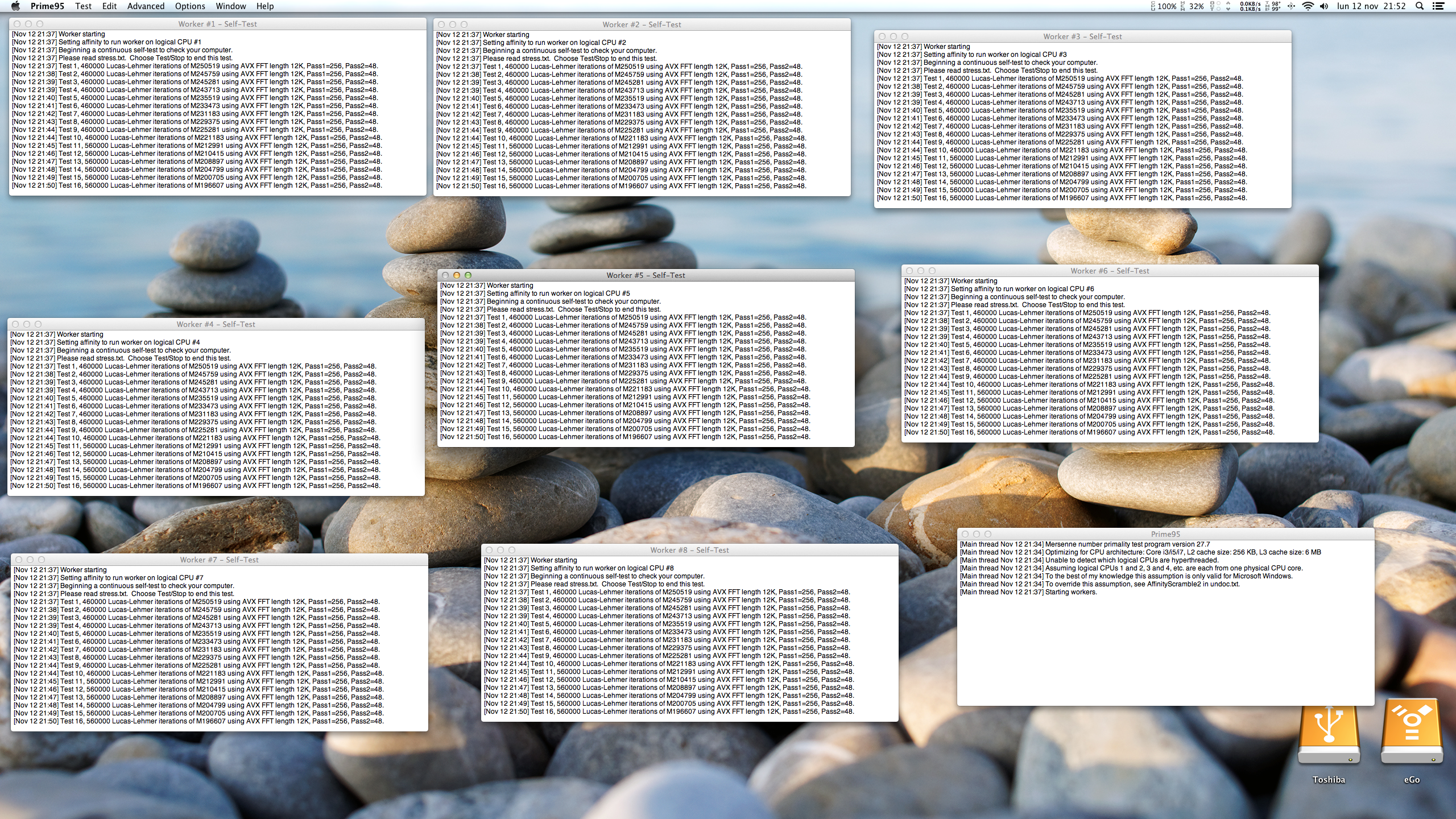

OK, ran it for 15 minutes. 8 threads. No problems at all.
Temp stable at around 98-100ºC (208-212ºF). No CPU throttle, all time at 100%. Fans at 5500rpm all the time. Incredibly loud, sooo noisy.
Ran Torture Test just for CPU. The way I used to when overclocking windows based machines.
