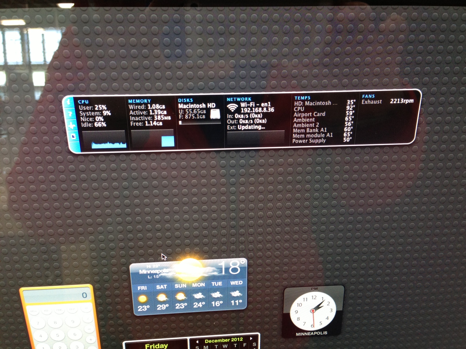

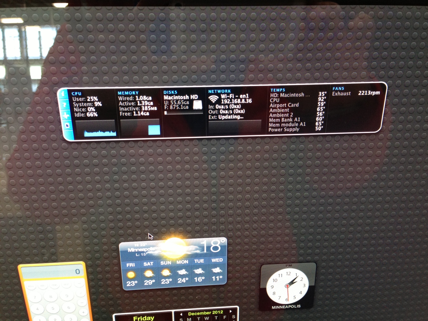

I'm experiencing this loud fan issue with Mac Mini 2012. Got this last week. Noticed the following; 1. Copying files 20GG 2. Rendering 3mins movies from iMovie. Fan would go as high as 5500rpm.
So I went to a local BBY store to check their mac mini demo display. Asked the sales guy if I can install iStat pro so I can check the fan rpm and cpu heat reading. I ran the iMovie, and export a 15mins movie. Attached image is the screen shot of the CPU and FAN reading.
The only difference between the mac mini is;
Mine: i7 2.6 Ghz, 16GB RAM, 1TB Fusion
BBY: i7 2.3 Ghz, 4GB RAM, 1TB (stock)
What is this telling?
HALF the story my guess is the photo is from the best buy computer. so where is the photo from your computer BTW the cpu is 92c with only 25% of the cpu in use that is a lite cpu load. all I can say is show us a photo of your computer running the same stuff. it should be a little hotter. why your cpu is hotter and you have 2 drives not one. fusion is 2 drives more power. oh you have more ram more power used. so your machine should pull 5 watts more then the best buy machine ,5 watts is a guess but close at least 3 maybe 7 more.
