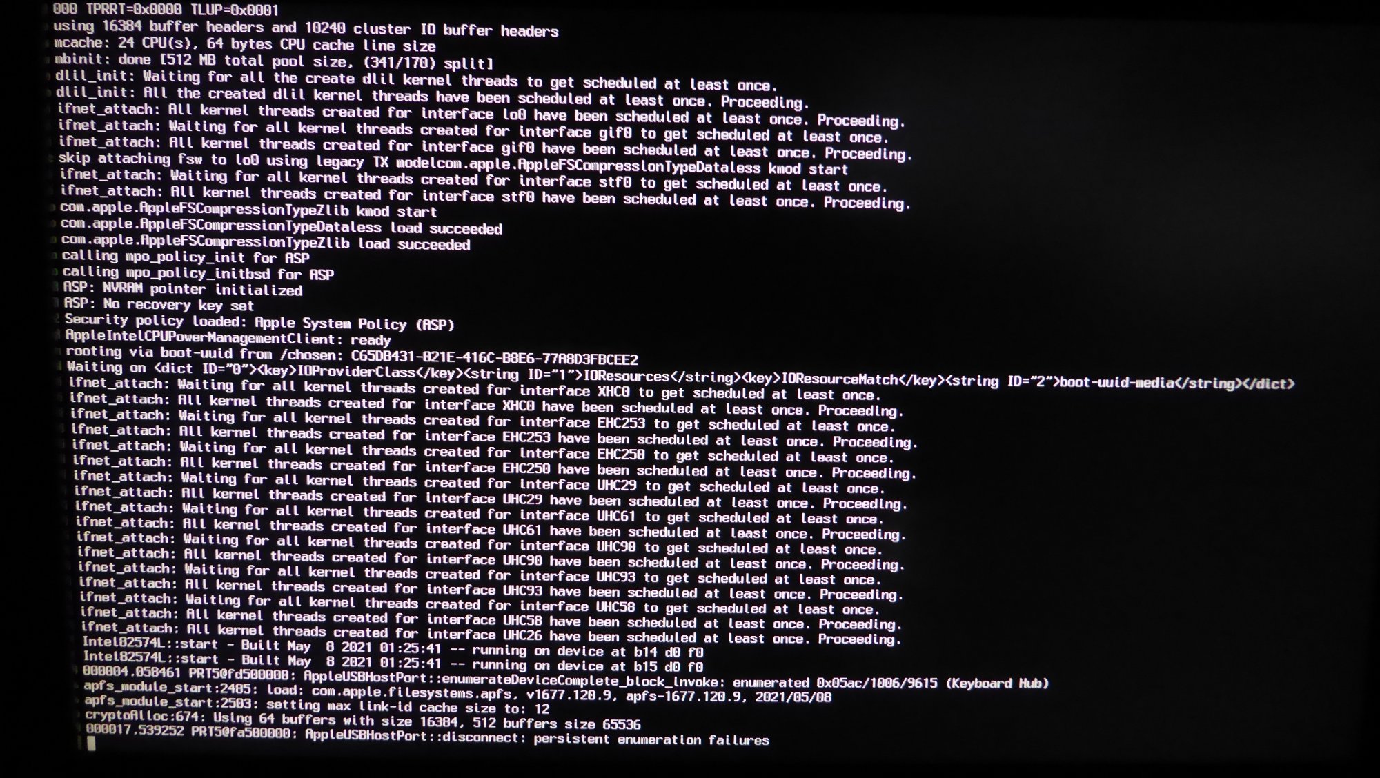

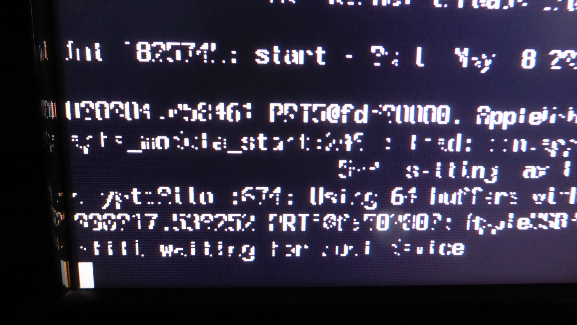

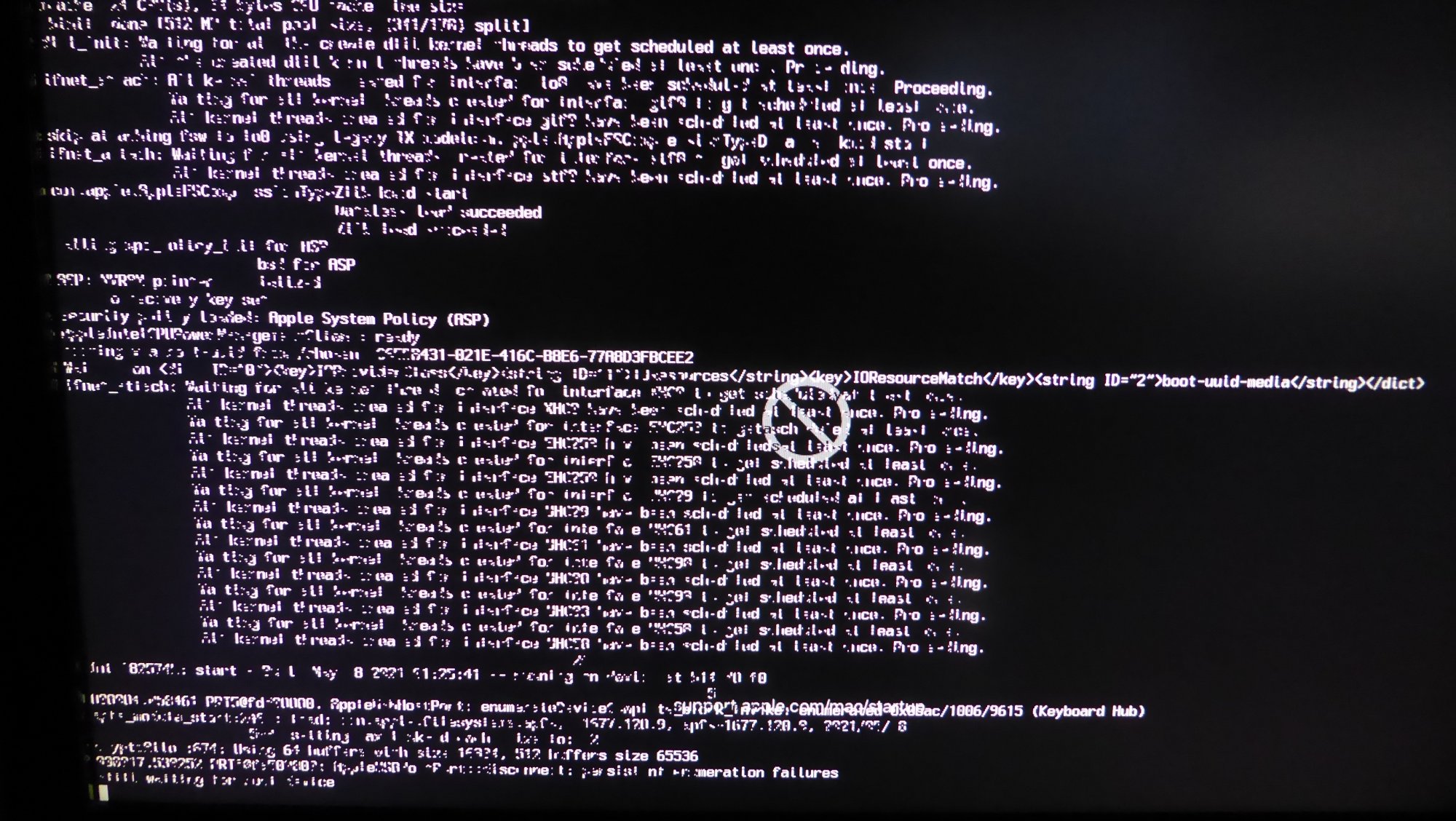

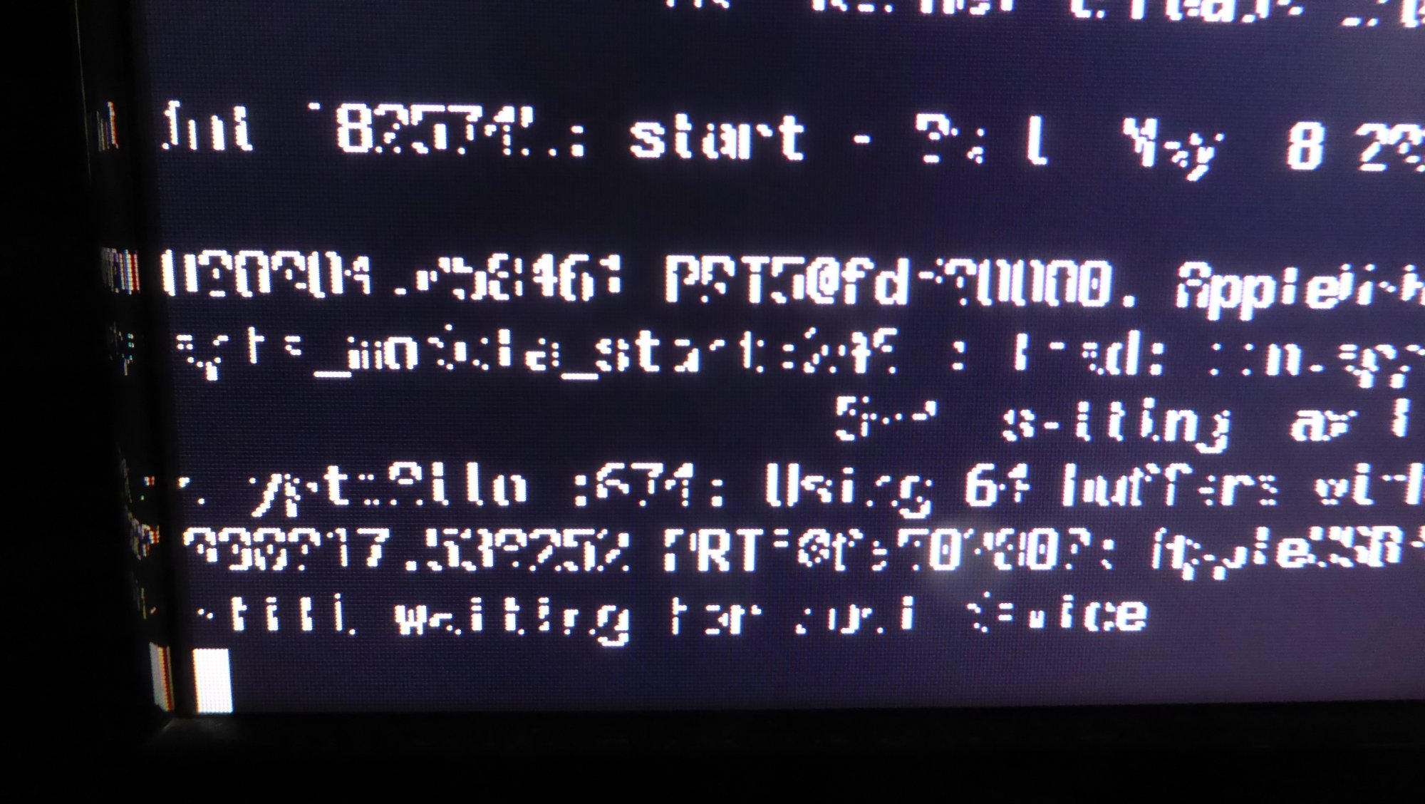

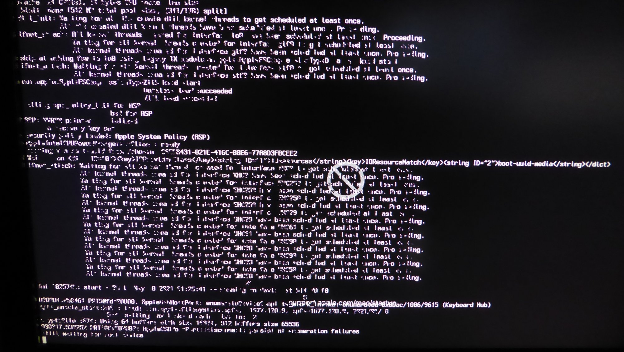

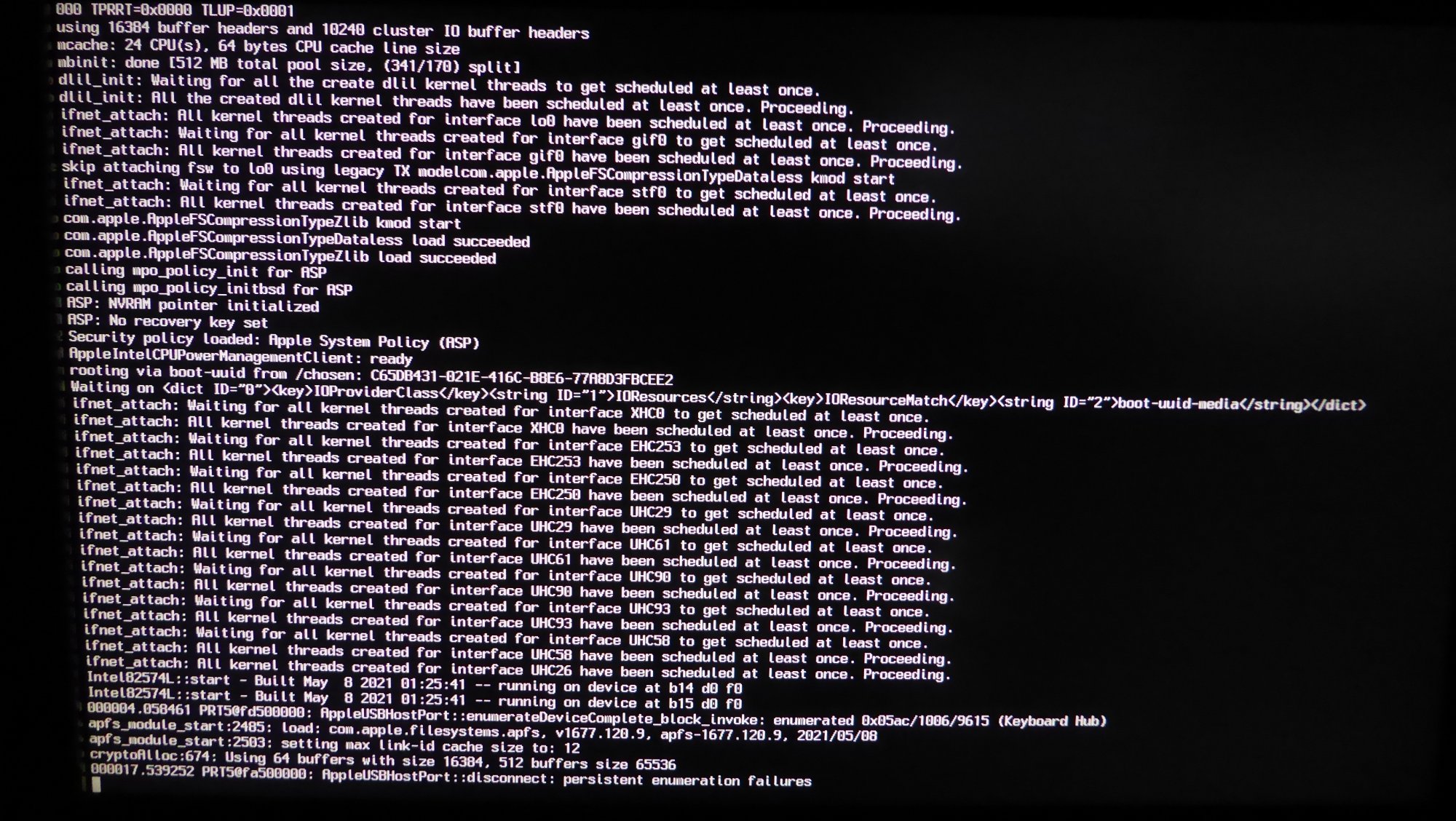

Not sure if someone already posted something similar but here's the Verbose of where my 4.1/5.1 dual westmere cpu with Big Sur 11.4 hangs every now and then when booting (using the Martin Lo opencore 0.6.9 folder). In the last picture the verbose gets artifacted after a couple of seconds on the first image.
The only drive on it is a Sata SSD where I'm booting from. I don't know how to interpret the log on the verbose, but maybe one of you can and will be able to shed some light about what's happening. (I understand some of you are suggesting something to do with the NVRAM - not sure if my verbose log suggests the same thing). Is it possible the Opencore team might have a clue about what's happening - or might be able to work on a custom solution? Does anyone have direct access to them?
Is it possible it might have to do with the cpu Nehalem/Westmere architecture? Would be interesting to know if these hangings on boot also happen to a hackintosh with the same type of processor. Just some food for thought.
Adjusted the first post, but TL;DR it's not related to Nehalem/Westmere. Penryn is affected as well and is replicable both on Macs and PCs. Sandy Bridge and newer don't seem to encounter this issue however unsure if architectural difference or simply speed and number of PCI devices present in the device tree

The different set of instructions (or their specific order) fixed the Penryn 4,1 machine problem. Is it possible a similar solution for the 4,1/5,2 MacBook can be replicated on the cMP 4.1/5.1 (2009/2010-12)? What's so different between the Penryn Macbook4,1 and Penryn Macbook 5,2 initial set of instructions? (Also having in mind Penryn Macbook 5.2 and Nehalem cMP 4.1 were both launched in early 2009)
Thanks for that, tho as @Larsvonhier mentioned on another thread (link below), he managed to fix his Penryn MacBook 4,1 (2008) Big Sur hanging problem by preparing the EFI OC for a Macbook5,2 (2009) instead (also a Penryn machine - using your OCLP solution
MacBook4,1's issue was USB based, not PCI. As I mentioned, can replicate this issue on every pre-sandy bridge Mac I own. Reliably? Not really, but 1 every 10 times it'll pop up
Almost all Macs from the 2012/2014 timeframe have the exactly same SPI flash memories from MXIC, just bigger sizes. When I reversed the SPI interface of MacPro5,1 I've started with a mid-2012 MacBook Pro schematic and it's almost identical, seems Apple just copied that whole part of the circuit for a lot of Macs.
I never read any reports of booting problems with now unsupported Macs like late-2012 Mac mini or mid-2012 MBPs that have the exact same SPI flash memories but double size.
The still supported late-2013 Mac Pro also have the exactly same one as used in mid-2012 Mac Pros, but the 64Mbit version instead of the 32Mbit one.
FWIW I've got 2 2012 Mac mini running BS 11.4 (and we're running 11.3 for that matter) on OC 0.6.8 (the BoardID is the 2014 mini). Both were updated OTA & are running fine without issue, though the boot process seems longer than before.
Fair enough, tho on my cMP4.1/5.1 system Verbose boot crash (sorry if I'm a total nob on this but it seems to hint towards the same), the log ends with "... AppleUSBHostPort::disconnect: persistent enumeration failures. Still waiting for host device' as you can see from the pictures below.
Side note/idea: If it's PCI related, just a silly idea, can perhaps some of the Mac Pro 7,1 2019, or iMacPro1.1 Big Sur Smbios instructions be replicated and adapted to the cMP EFi OC folder?
I'm just saying this because I've also got a Hackintosh, and when choosing the right SMBios configuration for the Opencore folder of my system, I had to choose between iMac Pro 1,1 and Mac Pro 7,1 on the config file. Surprisingly, and regardless of the amount of PCI ports on my Hackintosh - 6 PCI ports on the full ATX board in total + the resemblance to a tower/desktop format - I had to opt for the ImacPro1,1 SmBios configuration instead of the Mac pro 7.1 one. I was also able to boot with the 7.1 configuration but it was causing some pci detection errors - perhaps because effectively my system has less PCI ports than the Mac Pro 7.1 (12 PCI ports). With the imacPro1.1 SMBios the system never complained and enumerated all the PCI ports just fine. Would it be possible to tweak the cMP 5.1 OC folder to potentially include the PCI enumeration/instruction code from IMacPro1,1 or Mac Pro7,1?
