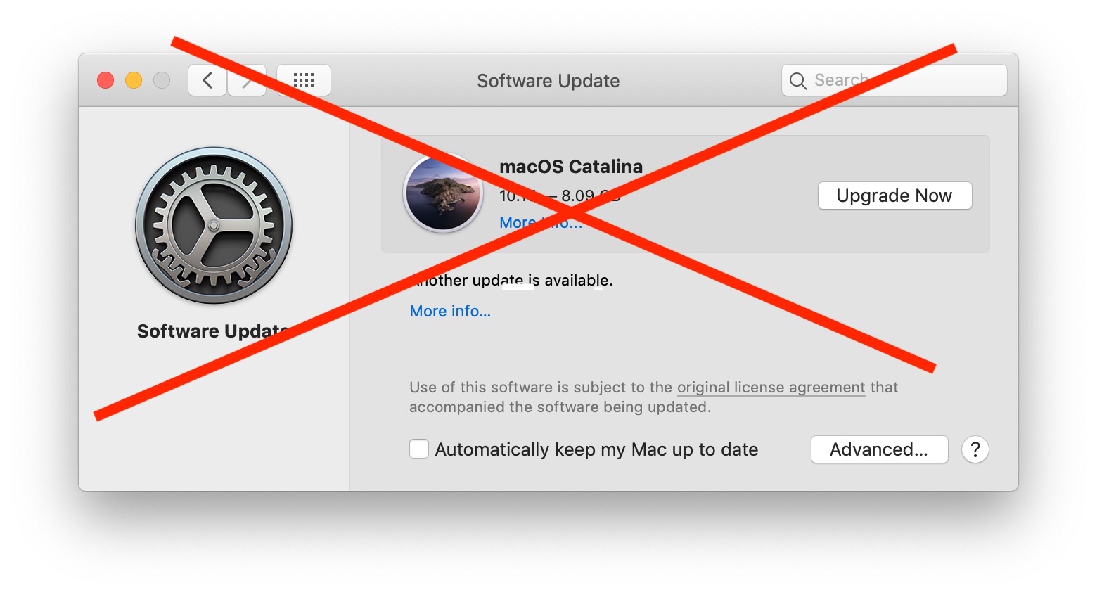

Hi everybody,
At this time it seems too hard to get 11.4 working, so does someone knows how to hide the update from the system preferences icon and the system update menu ?
I'm not the only cMP user, and I wouldn't want someone to update it on purpose :/

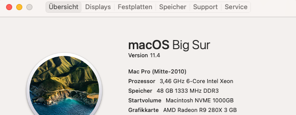

Hi everybody,
I got 11.4 running on my 5.1 using OCLP via regular OTA updates. The installation was a patience trip. I did 3 cold starts to get the after boot setup working near the end.
1. statusbar loading very slow until stopping at about 10%
2. statusbar now loading quickly through the first 10% then progress to 30% (first cold start)
3. now quickly to the first 30% then fast moving to 60-70%
4. Loading to 60-70% but then no progress.
!! I never saw the text remaining x minutes !!
Did this 4 or 5 times with identic results. Removing USB didn´t any change.
Then I shut down and plugged out the power chord waiting at least 15 seconds before plugging in again.
Now starting the same procedere with primarly same result but the first time my gpu reacted as known before. (adjusting the monitor) After the following first cold reboot I got again the gpu but the time this appeared had changed. I did the next cold reboot. Gpu now started as before but now there was the text sequence ...remaining 10 minutes.
From there the machine booted without any problems.
The machine is working better than with Mojave. Not a single problem since installation. At weekend I´ll try reboots.

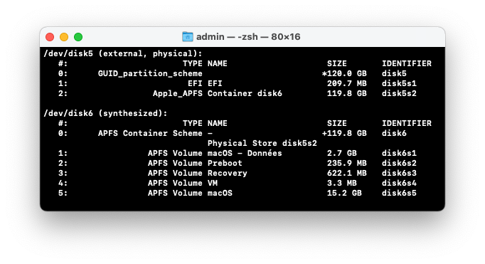

About our issues of starting our cMP5.1 since 11.3 I therefore thought of the somewhat crazy idea of replacing the Kernel by the one from 11.2.3 (I imagine that some have probably had the same idea for a long time and have already tried that ...)
In order to be able to replace the Kernel I cannot mount in read/write the external disk containing 11.3.1 (partition disk6s5, shown in following screenshot), (I specify that I am running 11.2.3). I have tried a lot of commands through Terminal but haven't succeeded yet, would someone be kind enough to help me with this command?

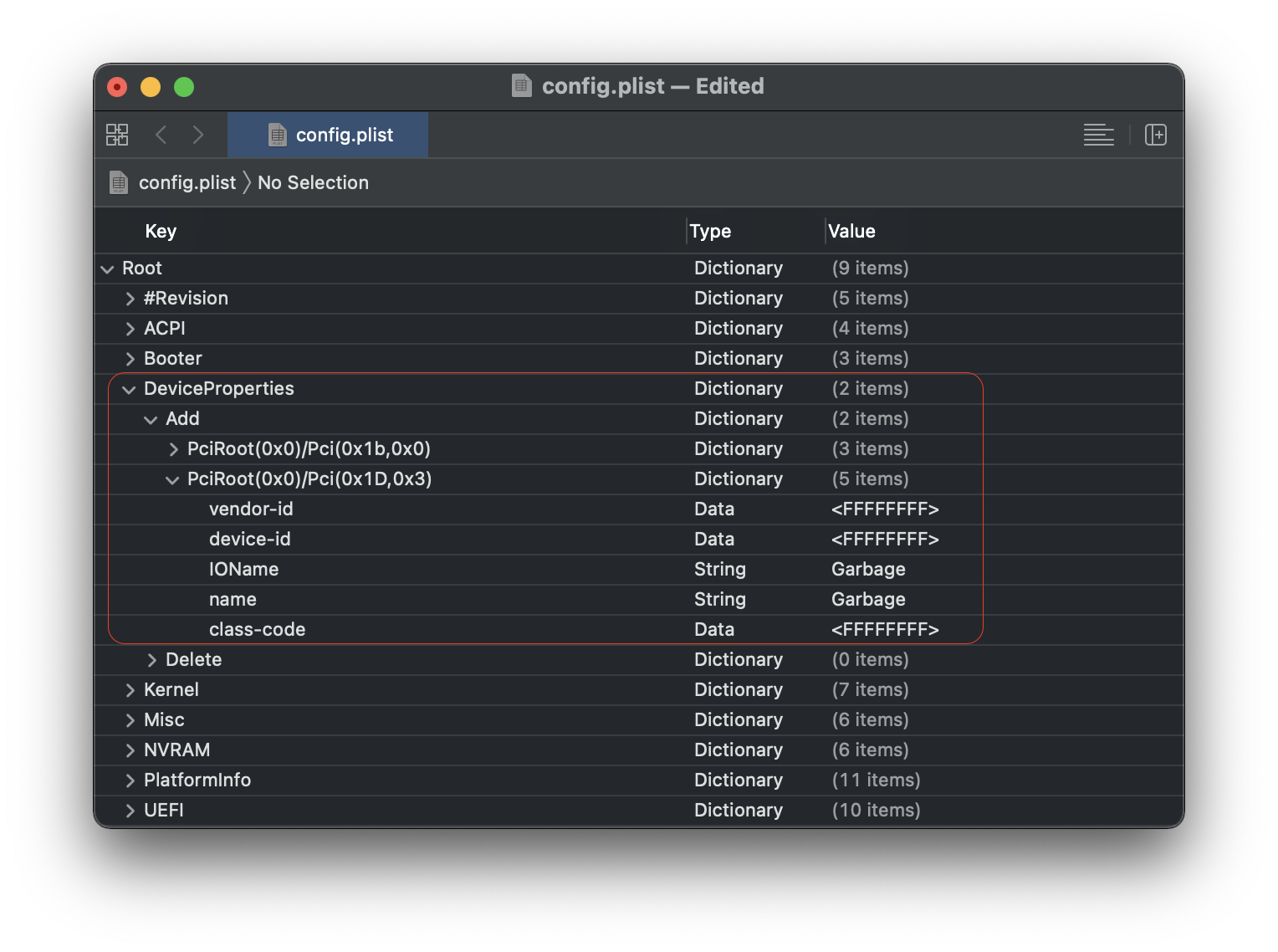

For those who want to disable non-essential PCIe devices, you can apply botched properties to them so macOS won't recognize them. Similar to how we do it for iMac12,x with upgraded Metal GPUs, we hide the bad devices with garbage properties and so macOS threats them as generic devices and no kexts attach
An example of this would be to run gfxutil and grab PCI paths for devices you think are non-essential:

From that, lets say I want to disable one of the USB 1.1 controllers(UHC4 for example) from having drivers attach. I would take this path, and add these properties to the config.plist with a simple plist editor like Xcode or ProperTree:
Code:
DeviceProperties
|---PciRoot(0x0)/Pci(0x1D,0x3)
|------| vendor-id  |  data  | ffffffff
|------| device-id  |  data  | ffffffff
|------| IOName     | string | Garbage
|------| name       | string | Garbage
|------| class-code |  data  | ffffffff
Note: You may need to populate DeviceProperties -> Delete and enable UEFI -> ProtocolOverrides -> DeviceProperties as well for scenarios where Apple has defined these values already. Mainly applicable for GPUs, generally other devices won't have device properties defined in the firmware. See OpenCore docs for more information
Maybe my message is not well written because my mother tongue is not english .. I just want a way to hide the update.
