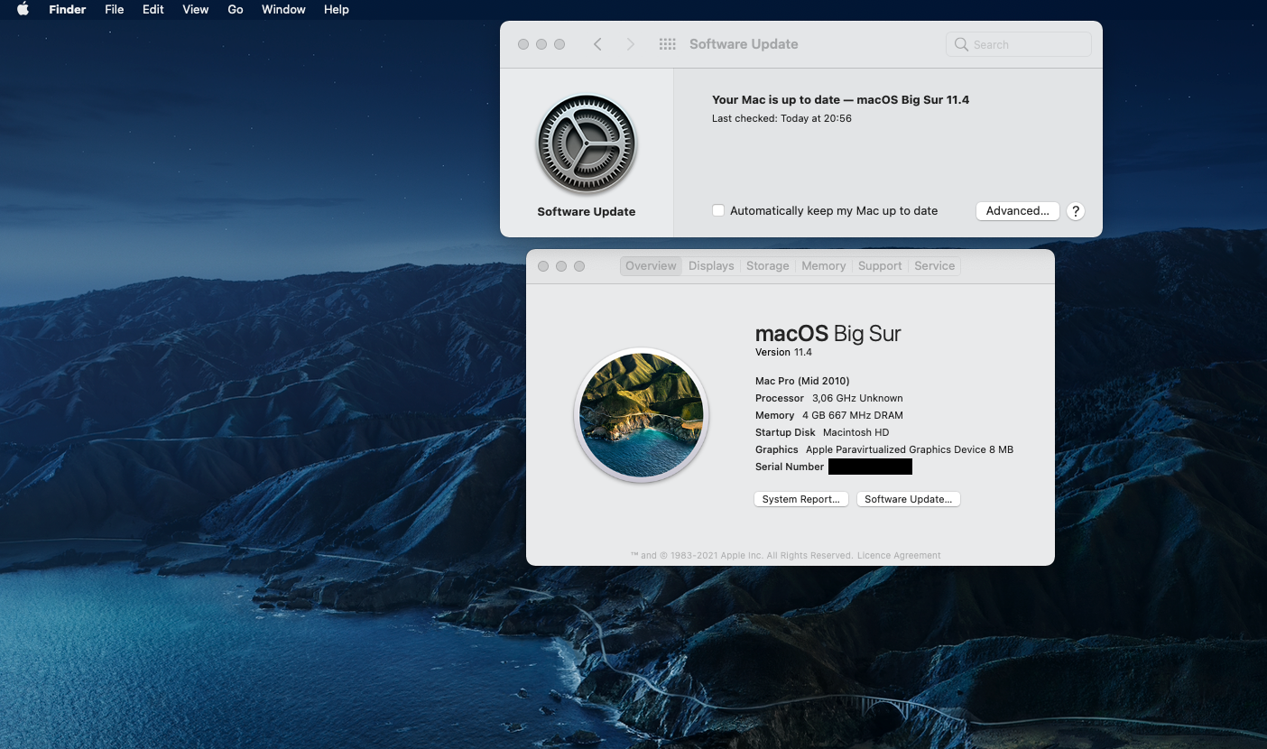

I don't know how significant the following might be. I suspect it won't be very significant. Be that as it may, I've just updated my Parallels Big Sur 11.3.1 virtual machine (on my Mac Pro 5,1) to 11.4 and it was successful (something that did not happen when I tried to update 11.2.3 to 11.3.1). See attached screenshot. I probably failed to notice this before, but, quite correctly, Parallels says my virtual hardware is a Mac Pro 5,1 and it even recognizes its actual serial number! Since my physical Xeon processor is the one responsible for installing and running 11.4, I wonder why it would work reasonably well on a "virtual" Mac Pro 5,1 whereas the very same processor fails to run 11.3.x and 11.4 on my physical 5,1.
How a virtual machine and real hardware act are vastly different even with kernel virtual machines (which parallels is not even that).
The devices present are vastly different(root bridges, chipset controllers, etc), the device trees are different (ACPI table formation) and the overall treatment of the device is different (XNU has dedicated code for Parallels and other VMs). In a sense, a VM is nothing like the host besides the few CPU features passed through like extended instruction sets
