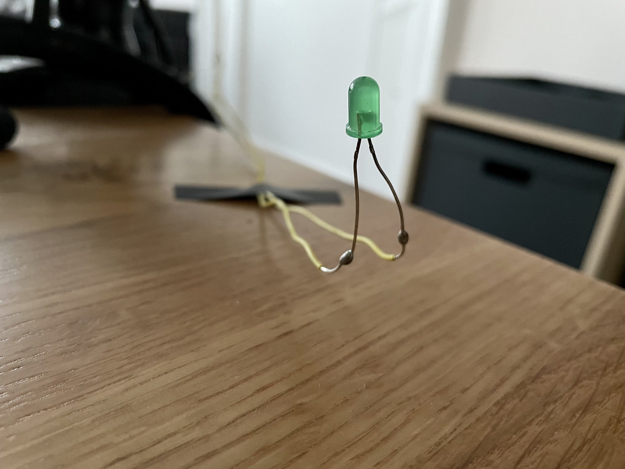

One thing is if you watch the status lights on NVMe drive, it will blink right away rapidly when its booting correctly, if it doesn't start rapidly blinking then just unplug an plug it back in, don't wait on a slow loading bar, its not doing anything if the status lights aren't blinking...

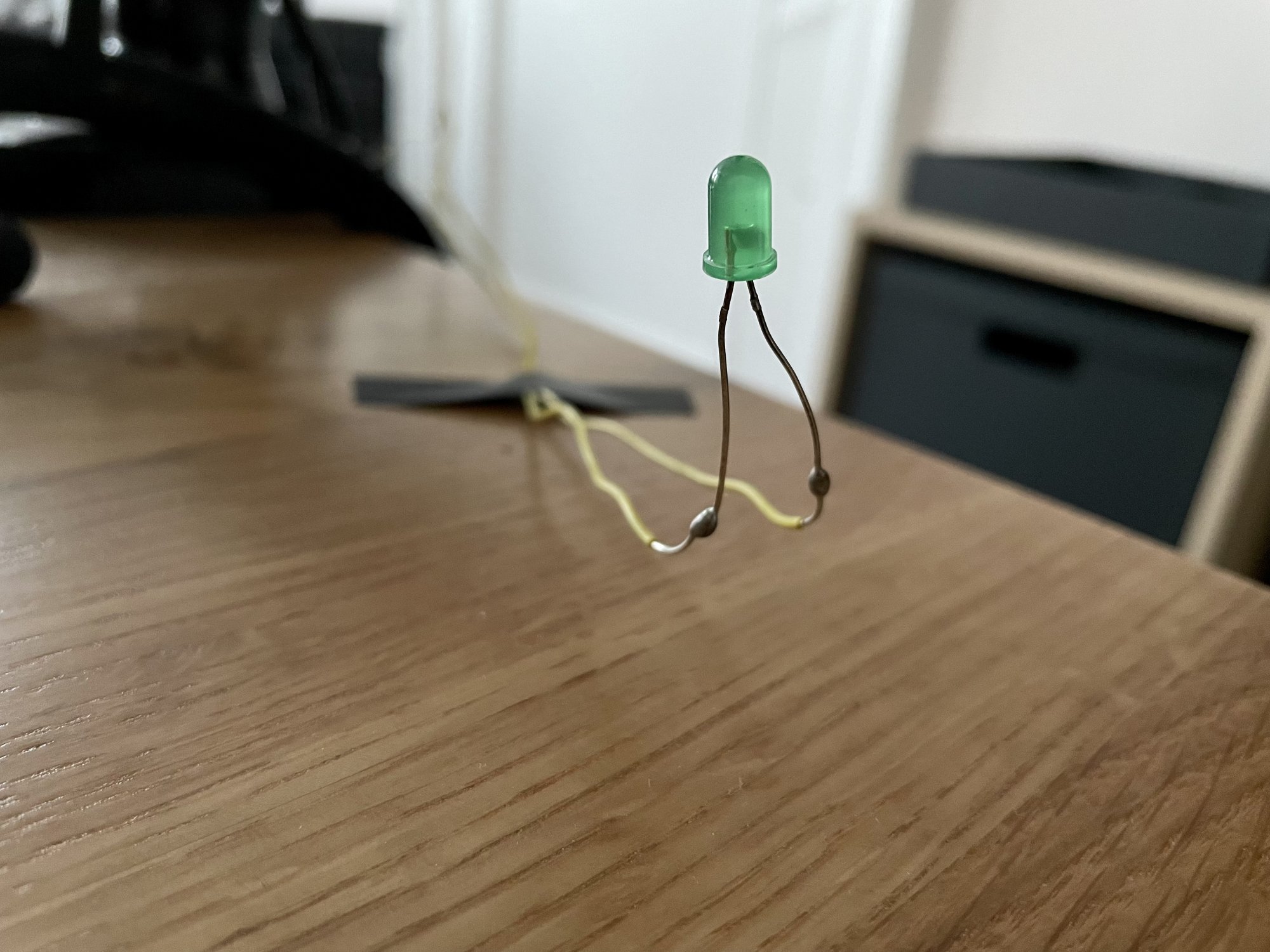

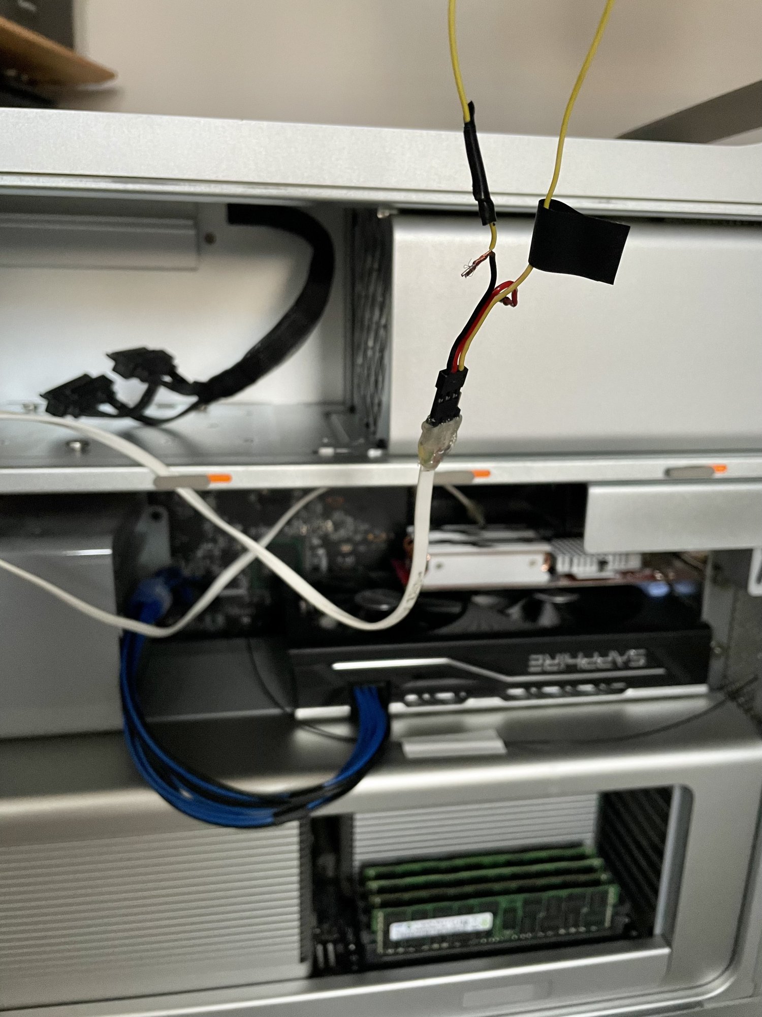

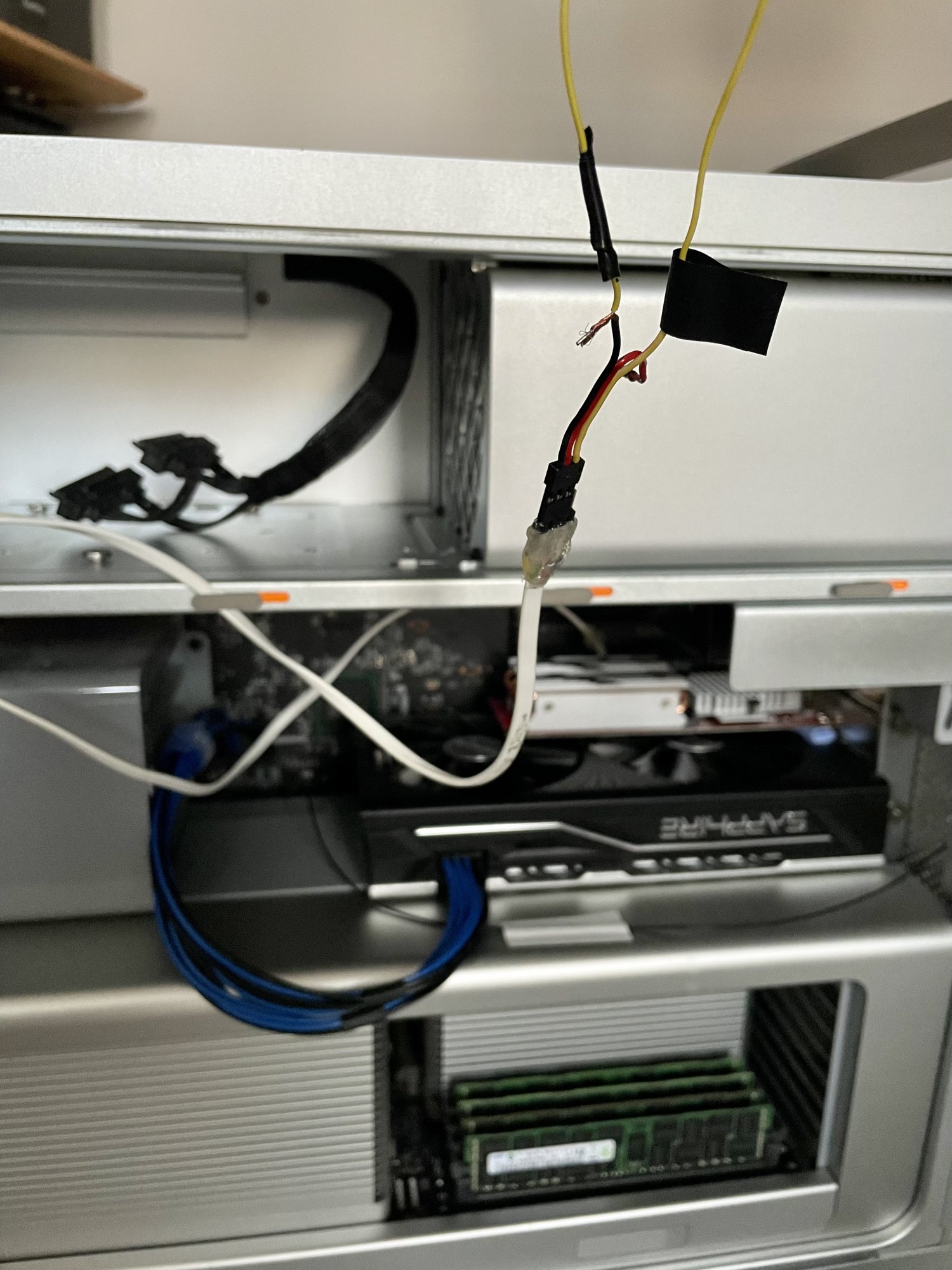

Yes, the NMVe LED light was very important to understand what was happening and when it was happening. You are right @cdf -- if the LED does not show activity right away at boot, then it's a failed boot, regardless of the status bar activity (in my case status bar usually goes up to about 1/4 even when there's no NMVe LED activity).
The challenge in my case was/is that my NMVe PCIe card has no activity LEDs!!! Luckily I had some LEDs and old cables around and improvised a temp activity LED for the boot NMVe drive. It worked fine and helped me a lot to understand the timing of fails. For your entertainment, I attach some pics of my "professional" LED activity setup extending all the way to the table top, just next to my mouse... 😂

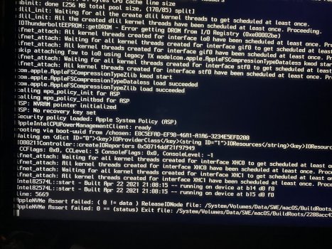

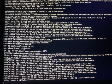

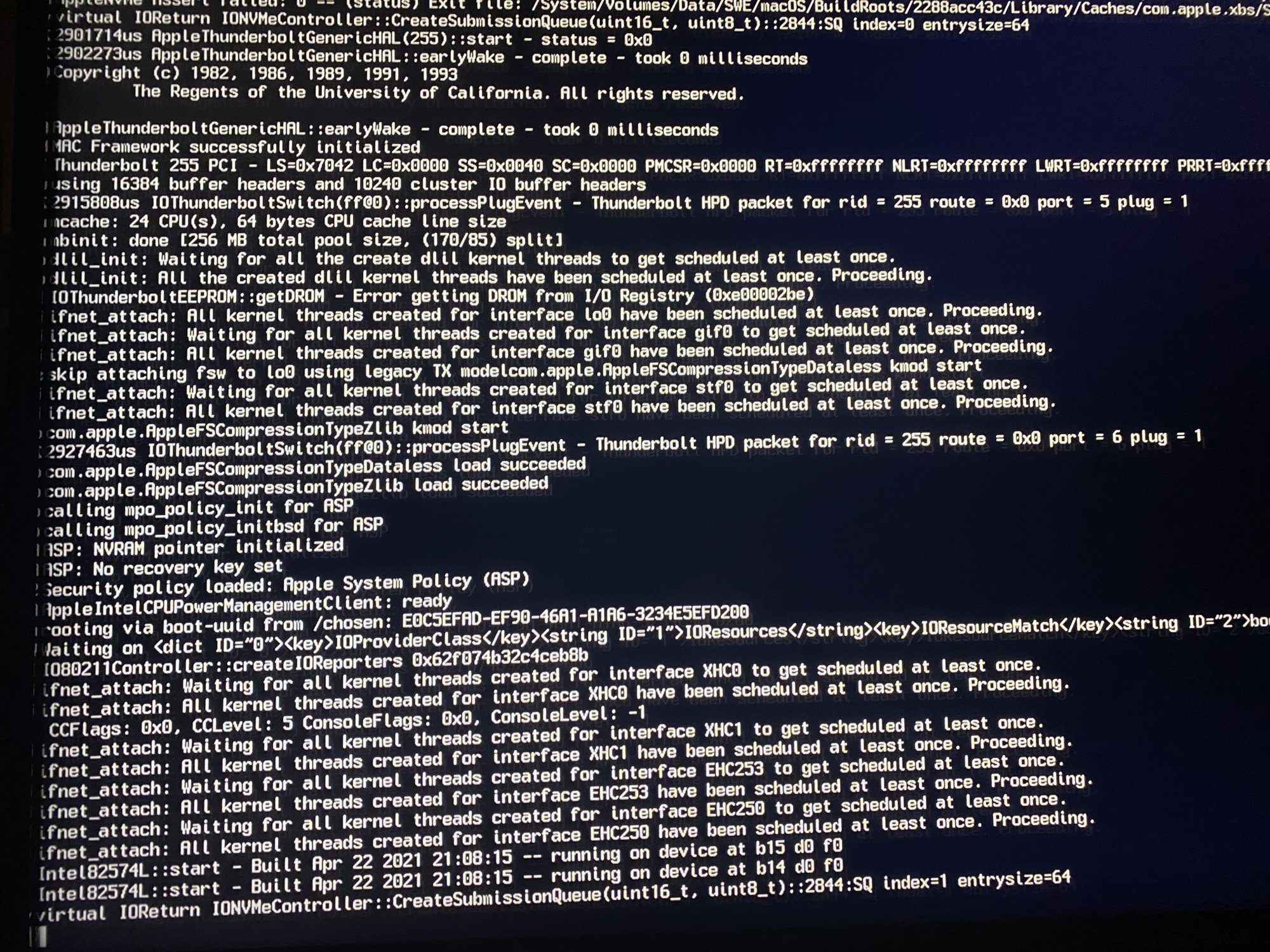

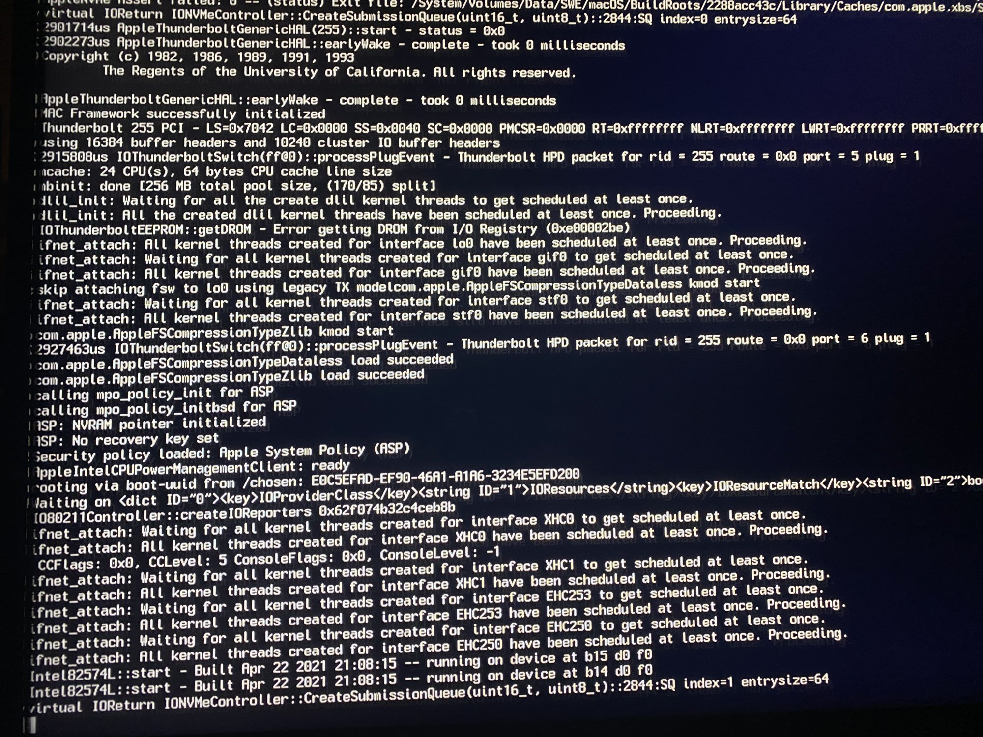

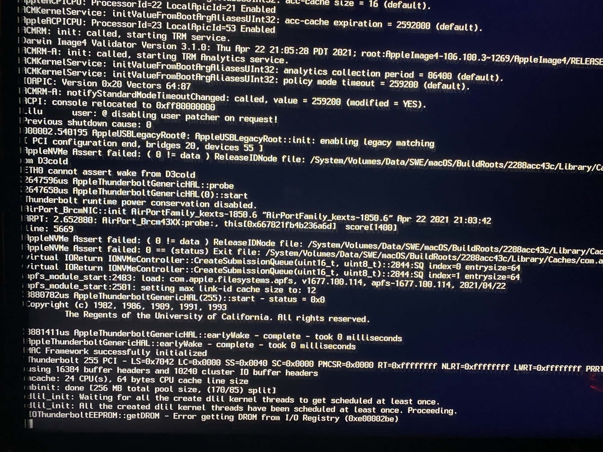

I disabled hyperthreading (had to boot into 11.2.3 USB fob), no change, system hung on boot. At this point, I removed the USB3.0 card and booted again, failed, cold boot and was able to boot into 11.3.1 again.

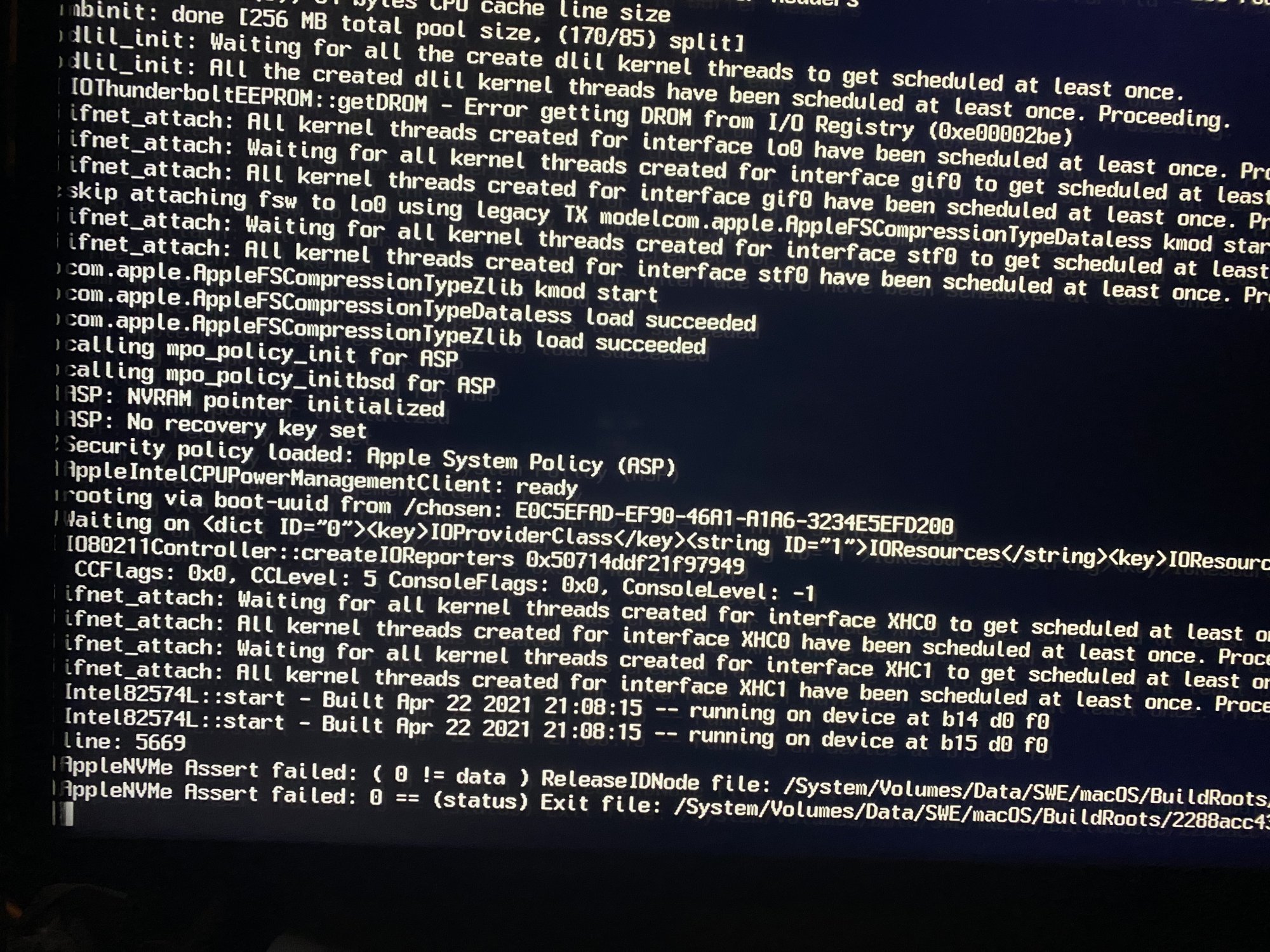

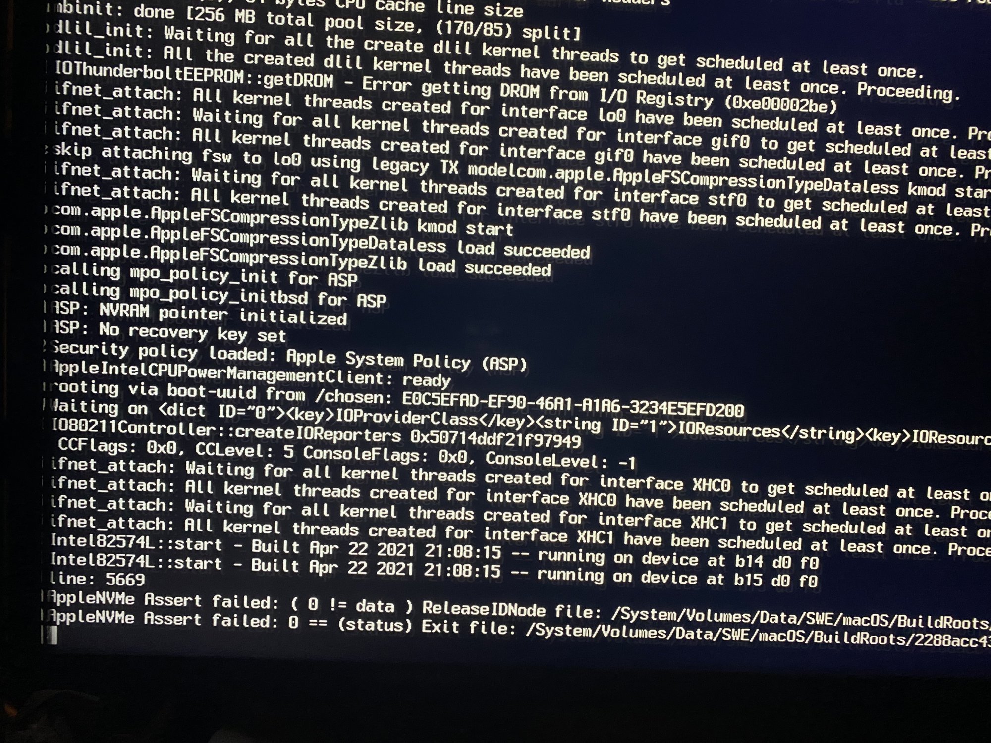

I'm attaching the photos of the verbose booting in 11.3.1
Thanks.
Unfortunately, yours is consistent with previous reports of boot failures during upgrade and regular use. And your verbose, too, froze at the same spot as most previous reports.

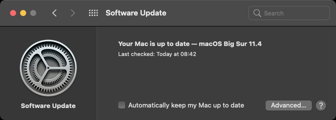

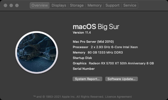

Not sure what I did right to some others but I went from 11.2.3 to 11.4 without a hitch, just like a regular upgrade on my Mac Pro 5,1 (Mid 2010), Radeon 5700XT, Highpoint 7101a - PCIE card, and Samsung 970 NVME SSD, USB 3 PCI-E card.
The only thing I did was to detach all the other drives from the sleds so only the NVME was attached.
Rebooted a couple of times and did give me a warning symbol but I did nothing the machine restarted itself anyway and am now writing this message on here via the Mac Pro.
Using OC 0.6.7.
No sleep issues, no problems with Wifi or Bluetooth. Everything seems a little bit snappier.
Just done a cold boot and warm restart. No problems. Super happy.
