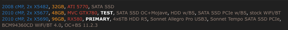

It isn'tI was curious if the white text in my signature wasn't readable with a light theme.
Well, then you shouldn't be using the light theme. Get with the program, man. Mojave was SO 2 OS's ago...It isn't
If I let the machine go through it’s normal boot routine (without touching anything on the keyboard), then it will start Big Sur, show the Apple and status bar, then stall at about 30% or so.Can you describe the circumstances in which it does not boot?
Contrary to "Alternative Facts" widely circulated on the web, Mojave is perfectly capable of being set to the horrid dark mode ... thankfully something connoisseurs can disable.Get with the program, man. Mojave was SO 2 OS's ago
Indeed. Light Themers now know what your test and primary rigs are!should be visible in both light and dark themes now.
