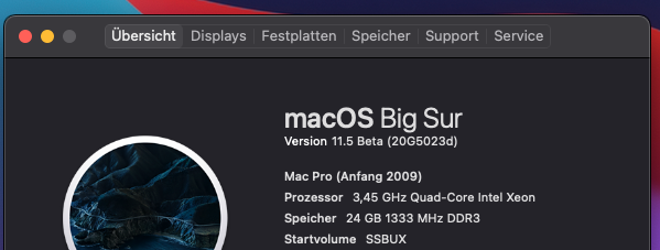

Edit: Worked, updated from 11.4 RC to 11.5 Beta 1 (had USB plugged off during update)

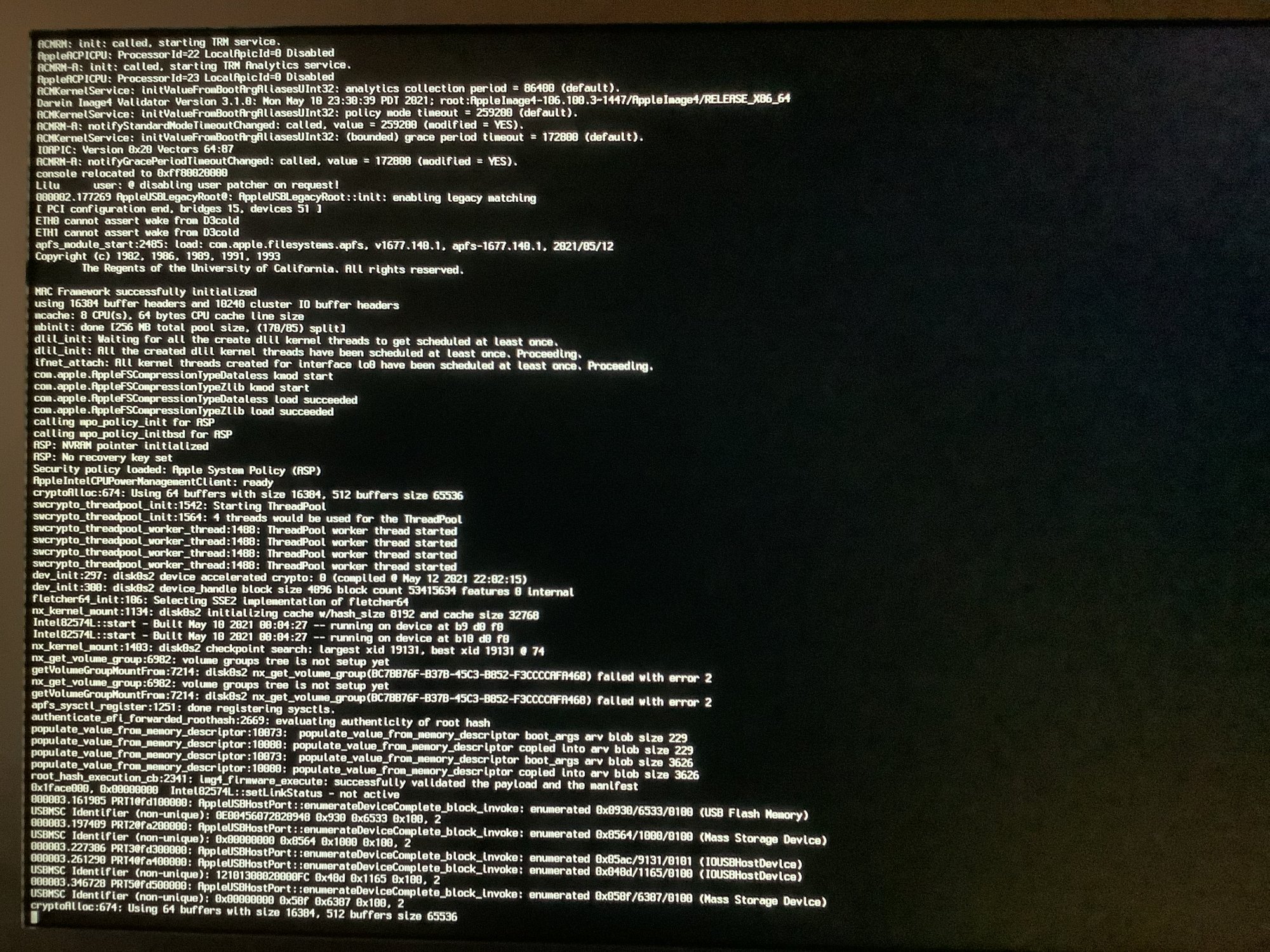

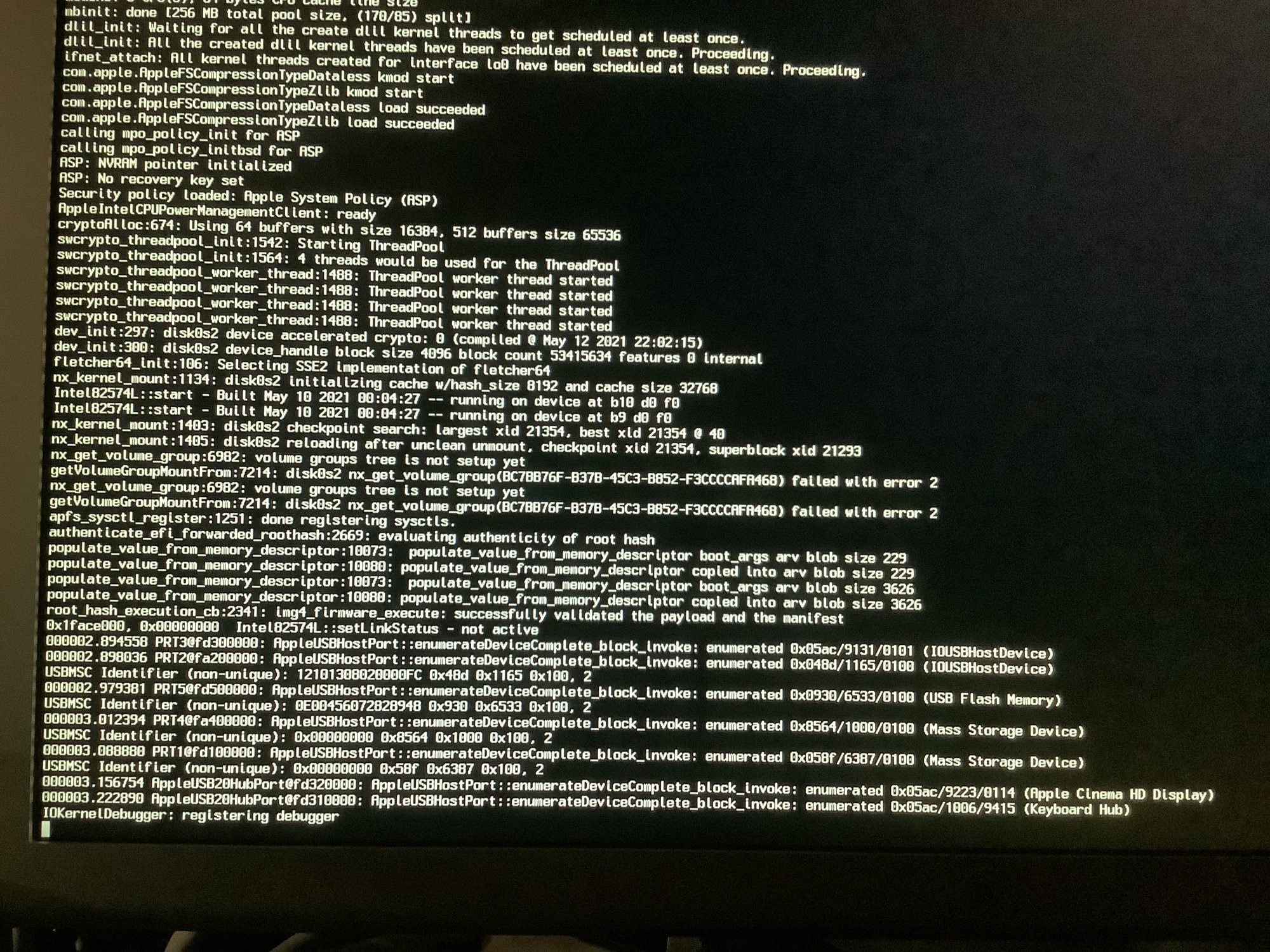

Booted 11.5 Beta 1 with my killer test (4 USB thumb drives in) and it hung on crypto
tried it before with USB and a DVD in, ok.
after the hung seen on the screenshot it hung on Ethernet. Thats the usual point since 11.3 for me when it hangs with USB.

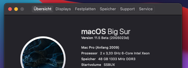

same machine with dual cpu board acts exactly same (DVD was still in, USB unplugged)
