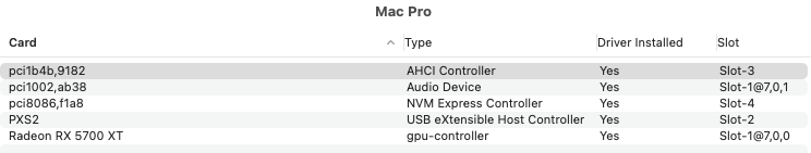

Can you confirm your PCIe card slot list and update your original post, as surely you can't have a USB 3.1 and an NVMe controller card in the same slot [2]? Any and all differences for machine setups on 5,1's that 'are' working with 11.3x may help others diagnose the problems many of us, like me (who can't get anything after 11.2.3 installed), are having.

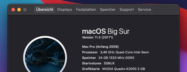

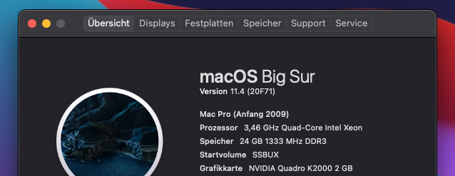

11.4RC is released. I'll upgrade in a little while, but already know what the results will be.
installed 11.4RC over 11.4 Beta 3, unplugged USB, Update run thru without any glitch.
but sadly, the race thing is still present. At least it means for me that I can not cold boot with USB Hardware plugged in.

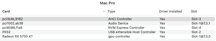

Sorry, glitch when typing. The NVMe is in slot 4

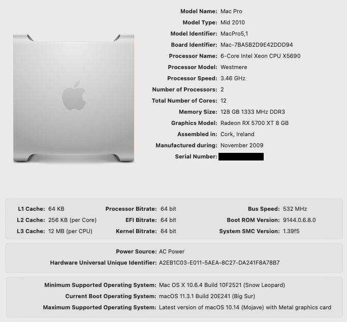

btw: Funny enough my reported firmware version seems to be off (See below)
I am on OC REL-068-2021-04-05 with the package from Martin, unmodified. Just one version behind...
Just realised that this package is modifying the reported firmware version in "FirmwareFeatures".
Just saying, in case it had anything to do with it...
Model Name: Mac Pro
Model Identifier: MacPro5,1
Processor Name: 6-Core Intel Xeon
Processor Speed: 3,46 GHz
Number of Processors: 2
Total Number of Cores: 12
L2 Cache (per Core): 256 KB
L3 Cache (per Processor): 12 MB
Hyper-Threading Technology: Enabled
Memory: 128 GB
System Firmware Version: 9144.0.6.8.0
SMC Version (system): 1.39f5
SMC Version (processor tray): 1.39f5

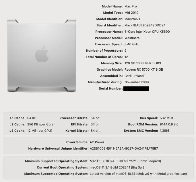

Model Name: Mac Pro
Memory: 128 GB
