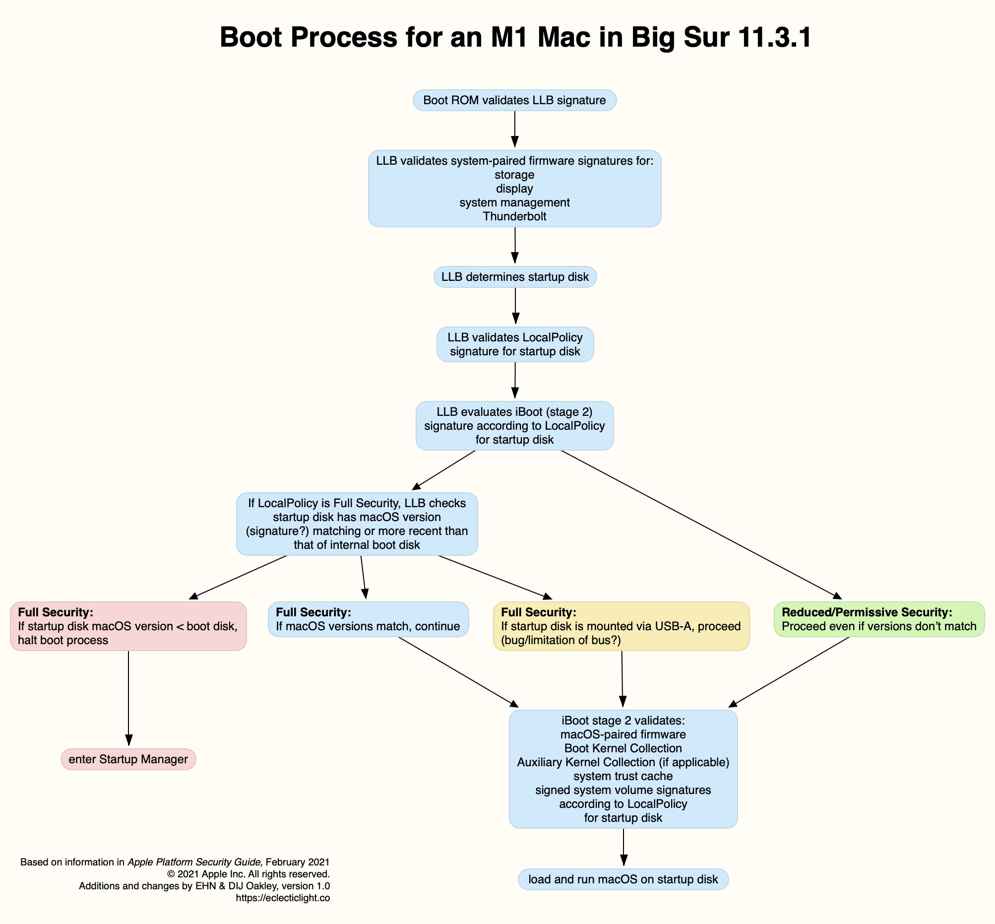

Maybe this helps a little to understand the early boot process for 11.3
even this is for M1 Macs it should have a lot in common:
also the linked pdf is very informative
start reading at page 41
Reactions: JohnD
Intel-based Mac computers without a T2 chip An Intel-based Mac without a T2 chip doesn’t support secure boot. Therefore the UEFI firmware loads the macOS booter (boot.efi) from the file system without verification, and the booter loads the kernel (prelinkedkernel) from the file system without verification. To protect the integrity of the boot chain, users should enable all of the following security mechanisms:
• System Integrity Protection (SIP): Enabled by default, this protects the booter and kernel against malicious writes from within a running macOS.
• FileVault: This can be enabled in two ways: by the user or by a mobile device management (MDM) administrator. This protects against a physically present attacker using Target Disk Mode to overwrite the booter.Apple Platform Security 43
• Firmware Password: This can be enabled in two ways: by the user or by an MDM administrator. This protects a physically present attacker from launching alternate boot modes such as recoveryOS, Single User Mode, or Target Disk Mode from which the booter can be overwritten. This also prevents booting from alternate media, by which an attacker could run code to overwrite the booter

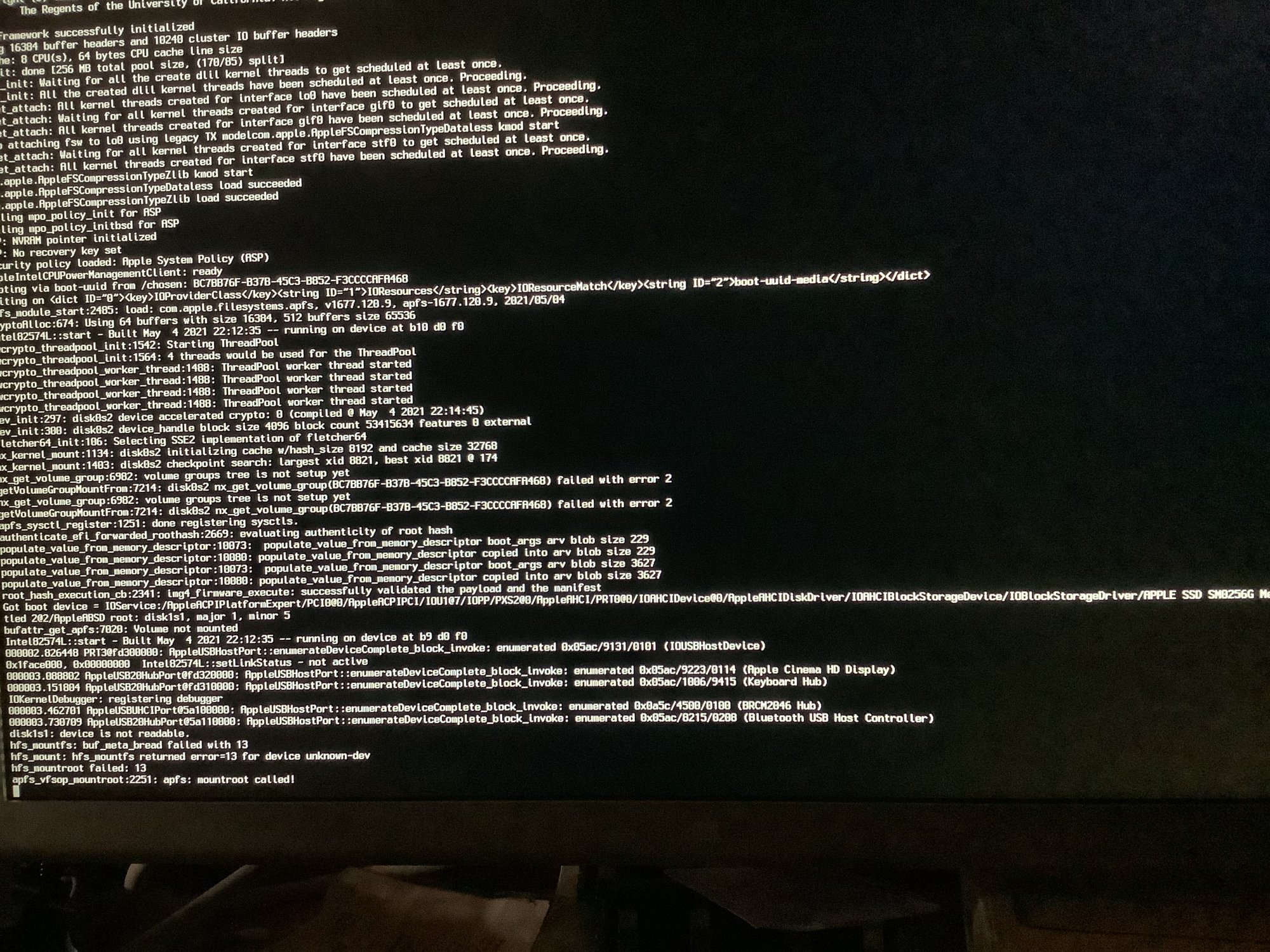

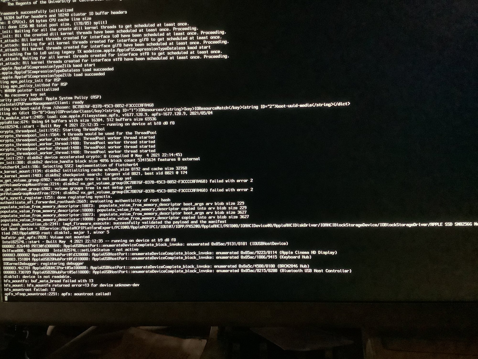

FileVault. Has anyone tried booting ≥11.3 with it? I wonder if the booting issue would be any different.
It looks like the prohibitory sign is probably due to the filevault not able to unlock the hard drive so the Apple suggestion is actually to disable it:
So I was on the phone with Apple support today and my adviser said the error messages in my boot log are very similar to those you would see when FileVault is not able to unlock your hard drive while booting.
