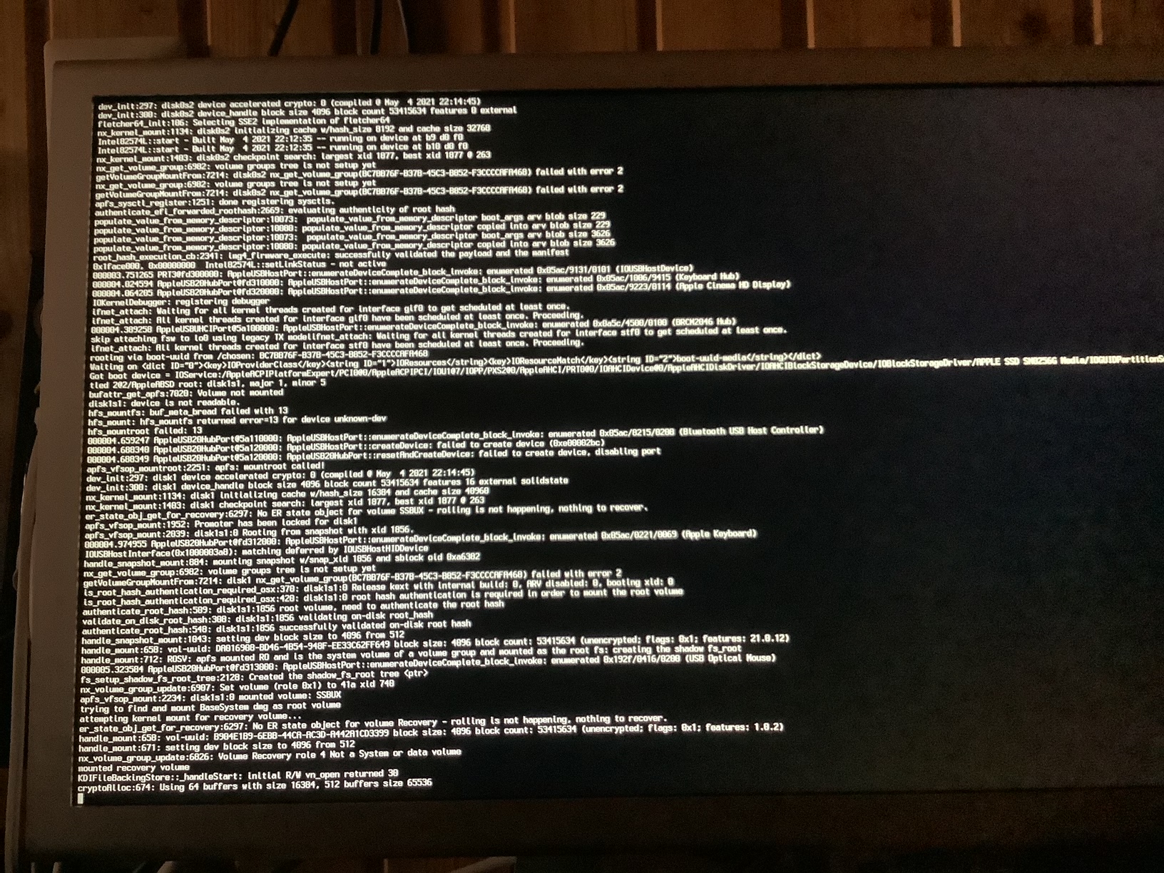

I have updated 11.3.1 to 11.4beta3 with "just" 1 freeze and could capture it (just the Apple AHCI Blade in):

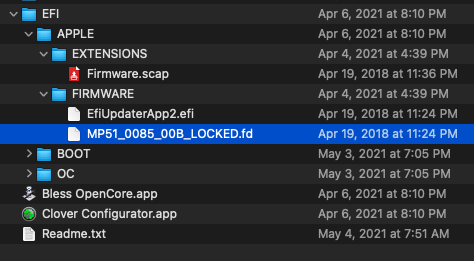

I asked earlier if downgrading firmware was possible or beneficial. Seems I still have a copy of a pre-High Sierra firmware (EDIT: Well, pre-0089 anyway) left behind in my EFI. Would this be of any help?

before testing firmware images,
BACKUP YOUR CURRENT FIRMWARE!
it contains machine data like serial numbers of the Board, date of built and other sales / hardware data.
its a hell of a work to rebuild a firmware when losing them.
also dont forget if you downgrade a 4,1 it will need the xeon(s) downgraded again, too.
Reactions: JohnD
