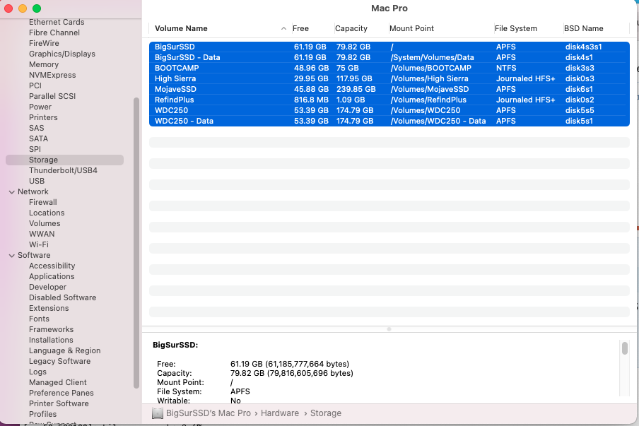

Boots normally with 6 drives, one of which is 11.2.3 BS (2 PCIE SATA drives):
boot-args="-v -no_compat_check keepsyms=1 debug=0x144 -liludbgall -nvmefaspm"

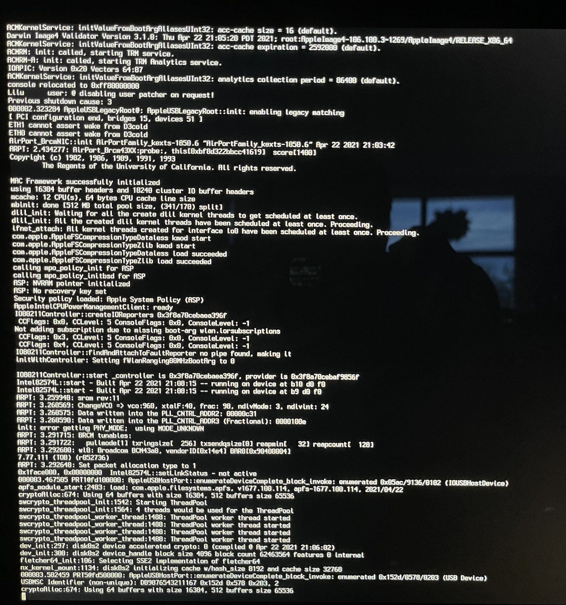

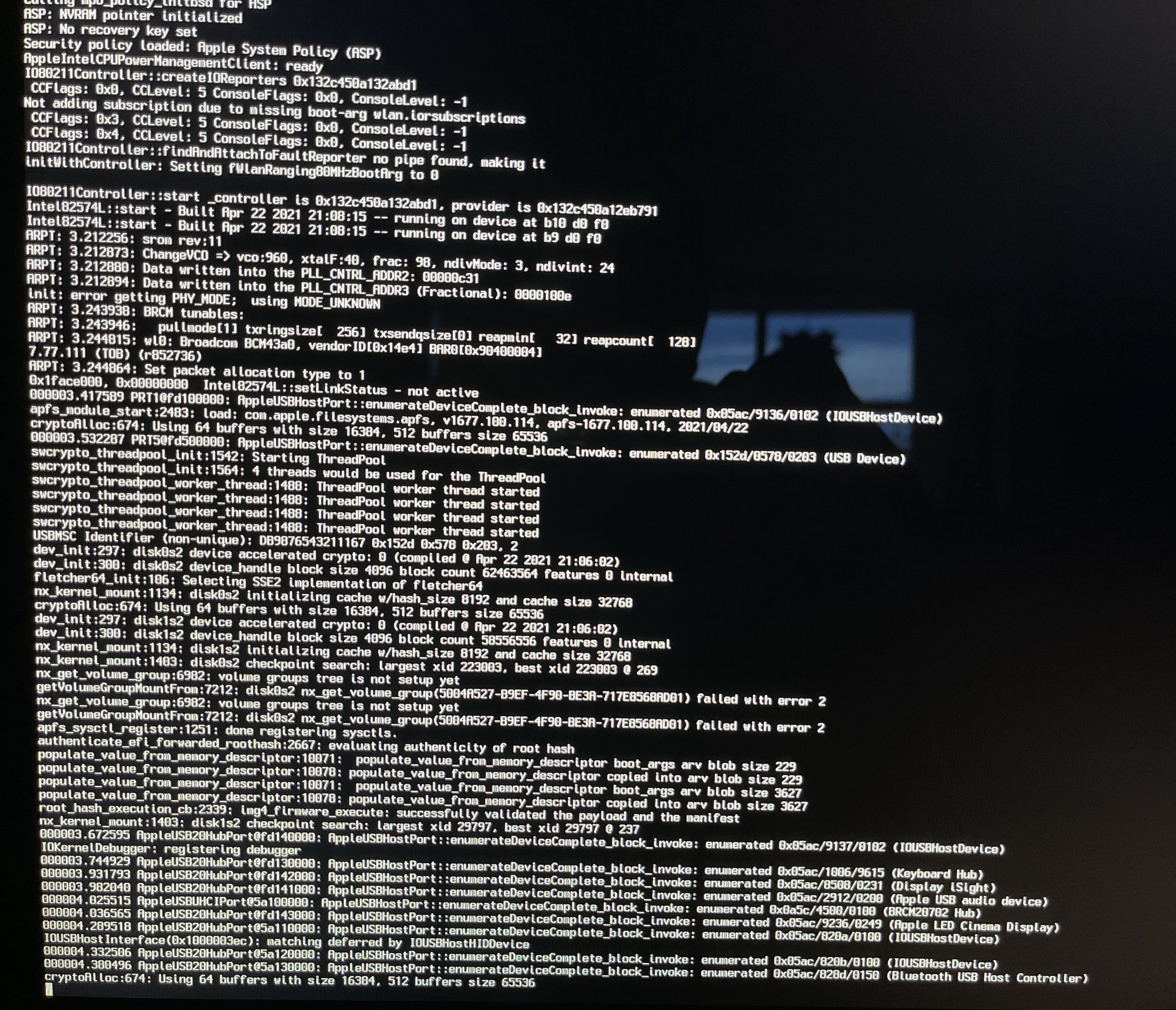

I tried to boot a fresh installed version of 11.3.1 from an USB connected SSD. I tried it 8 times and had only 1 successful boot. The other times it Stucks all time at the same place.
Below you see the screen from two different tries. It's not much, but I think little things will help too.

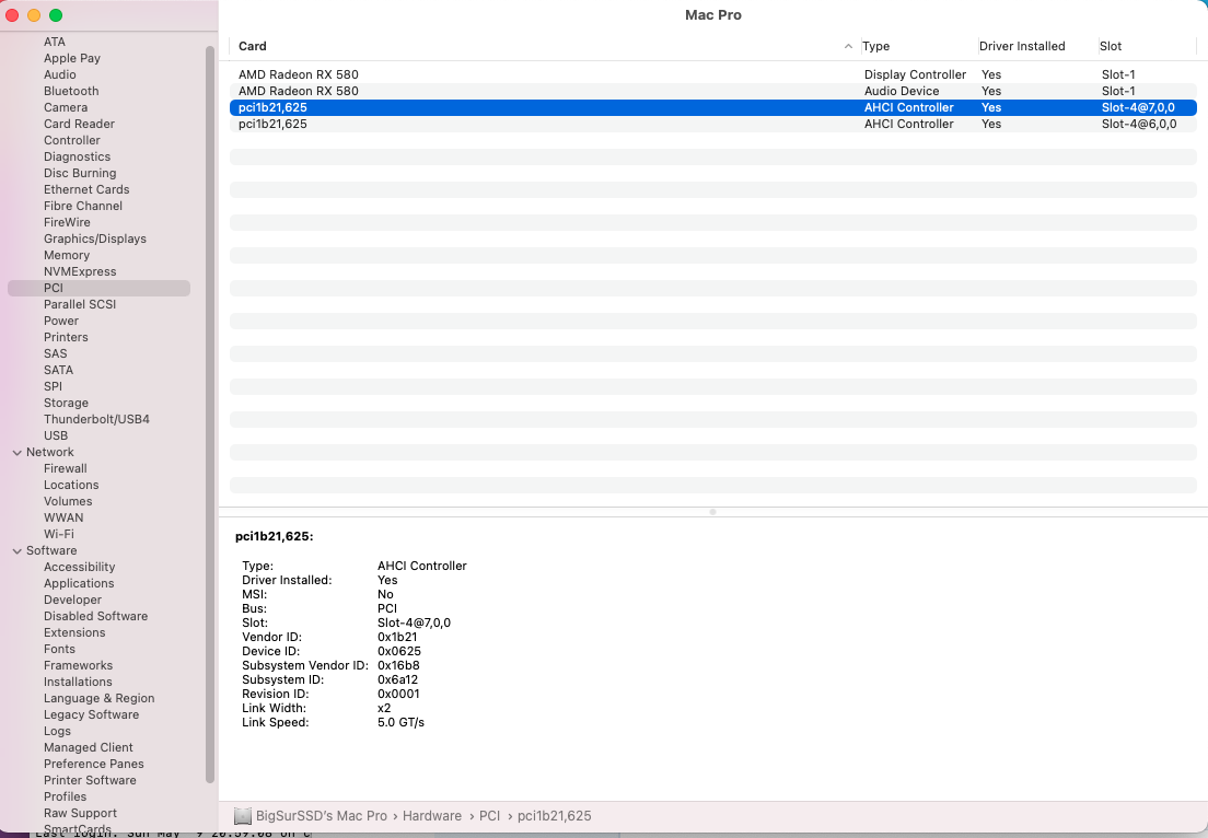

I may have another data point.
Used as the one and only drive an Apple SSBUX AHCI Blade from an MP6,1 I guess (APPLE SSD SM0256G)
Clone of the same System I test all the time with 11.3.1 (20E241).
And even with my "stress test" plugging 5 USB Sticks in - plus Monitor and Keyboard Hubs it survived cold boot.
with oclp 0.1.2 and native with -no_compat_check
Reactions: cdf
