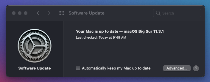

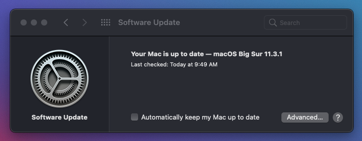

If you make sure your LAN is not connected, you should be fine. Make sure both the RJ45 jacks are disconnected as well as the WiFi. I made that mistake once. I had forgot about the WiFi and kept having issues. Anyways once you boot up with no LAN at all Go to 'System Preferences> Software Updates' and make sure the 'Automatically keep my Mac up to date' checkbox is Unchecked.

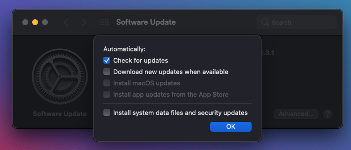

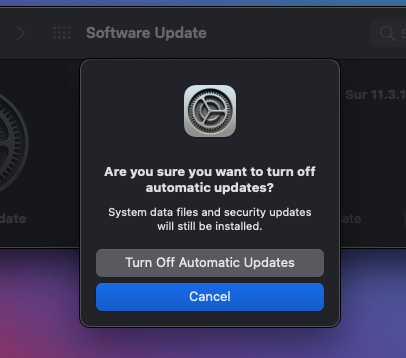

If it is checked and you uncheck it you will probably get this dialog...

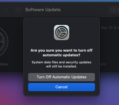

Notice the small not bold print. "System data files and security updates will still be installed." This is what is causing you to auto download and install. Click then 'Turn Off" button, and your Software Update Prerences should look like this...

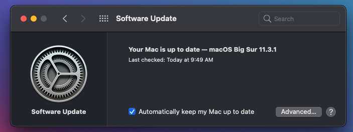

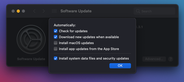

Now here comes the catch... Most people think 'Ok no checkmark so we are now good to go." - Nope! Apple started a "slipstream" process in 11.2.3 to make sure 'critical' files are installed for security reasons. If you click on the 'Advanced' button you will see this...

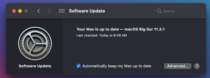

Notice that even though you told it no updates and it looks turned off from the main dialog, certain actions are still enabled. I have noticed as well that if you uncheck all of them eventually the very bottom one rechecks itself (no clue where this is controlled). So here is how mine is setup...

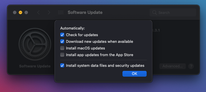

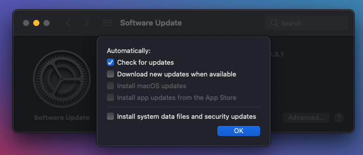

For some reason (so far) by having only the one setting checked it will check for updates, but even for security updates it just keeps nagging every once in a while in the Notification Center. So far, it has not auto-installed anything I did not click 'Install' on.
Once you have that done, just as a precaution before hooking back ups to your LAN, I would reboot, and then verify the changes persisted through the reboot and did not reset. If they did not you should be good to go on going back online and this should prevent your system from doing any auto-updates, including App Store apps, without you knowing about it.
Also, make sure once you do a macOS update or security patch, to go back in and set this up again, as it seems to revert to auto update after each patch no matter how small. :cool:
