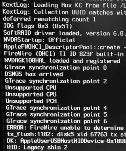

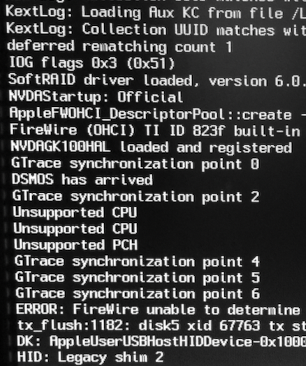

I do my "stress test" and add 5 USB thumb drives and cold booted - it hung on Intel 82574L
when I pull the AHCI Blade it hung on USB Drivers

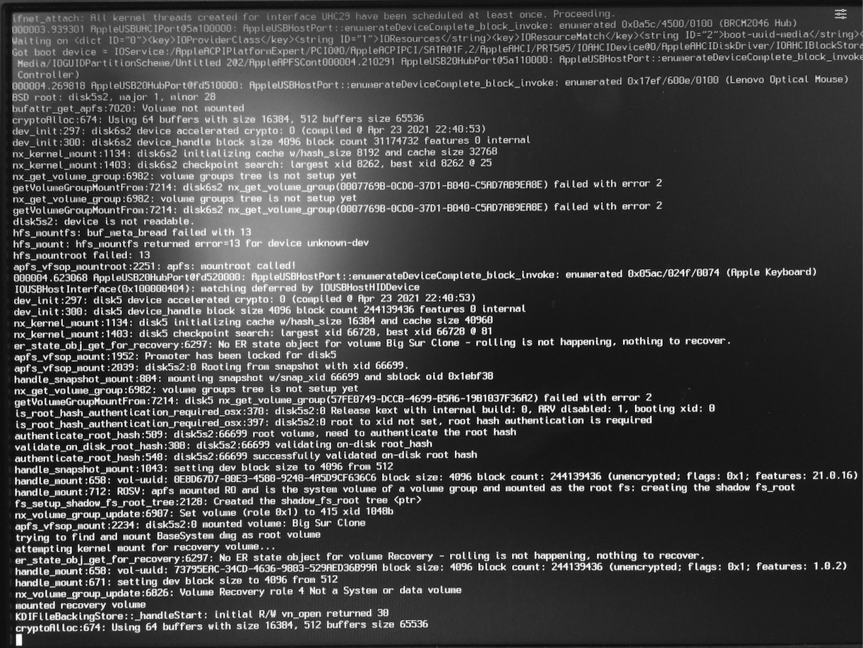

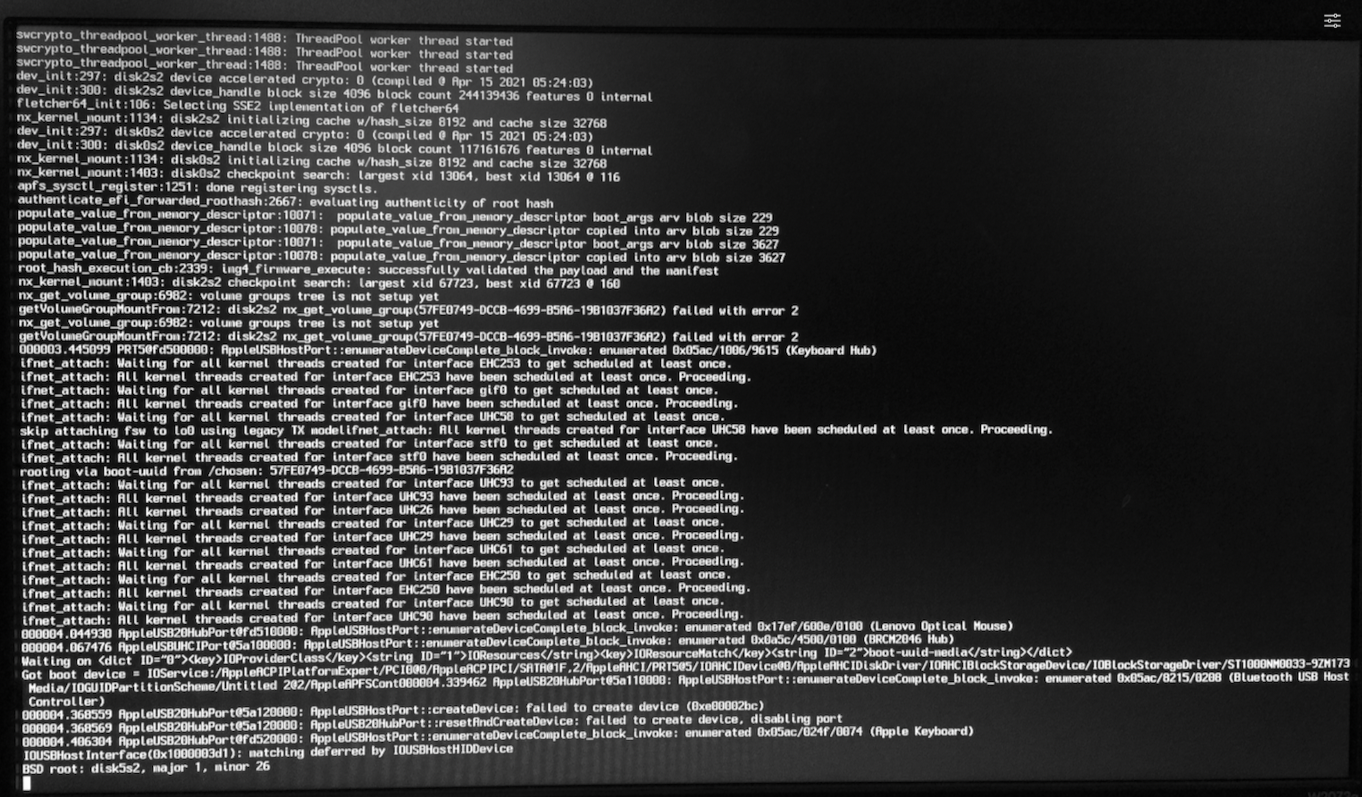

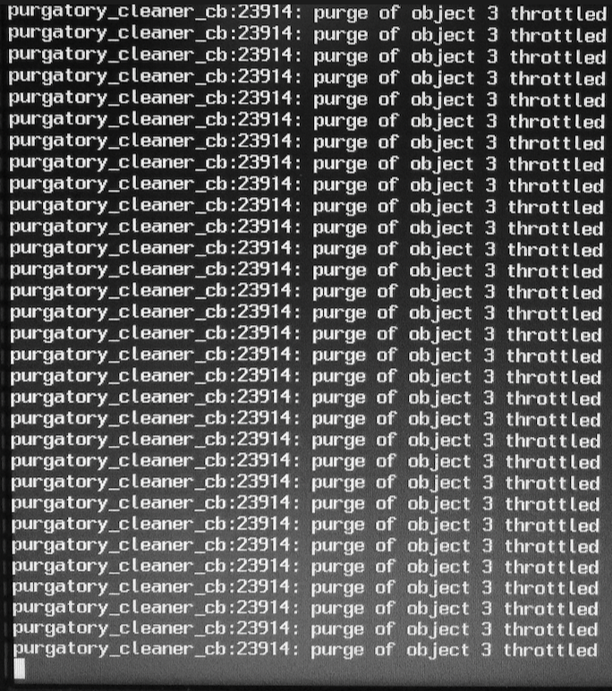

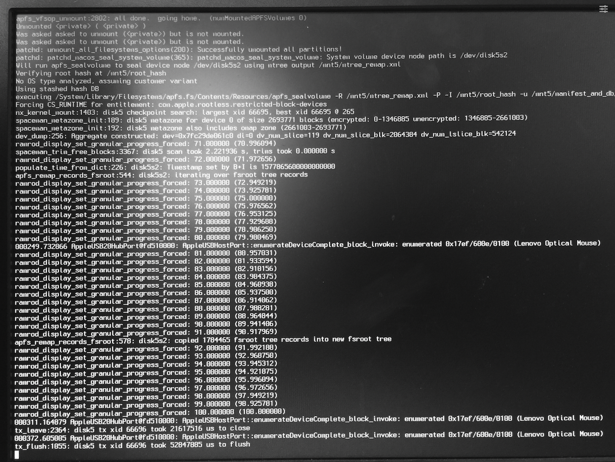

I decided to upgrade my HDD (bay 4) from 11.4b1 to 11.4b2, and it didn't go very well. I'm using Martin Lo's new OpenCore 0.6.9 package.
The upgrade hung here, requiring a power cycle, then continuing with the installer.
Then this happened after the install resumed - never seen this before. Seemed like several screens of this scrolled by before the installer continued.
It got to this point and hung again.
Then it hung here, permanently. Several power cycles, kept hanging here, so I booted into recovery and am performing a re-install, which seems to be going well - 3 minutes remaining. I'll do the usual multiple reboots, but not expecting anything new. Never had this HDD give me so much trouble throughout the 11.3 beta's.
The re-install from recovery hasn't gone well either. It hung here, and I have yet to see an 11.4b2 login screen.
After a power cycle, and a lot more verbose text, finally got an Apple logo with progress bar, which always means it's going to give me a login screen. Sure enough, I can finally log into 11.4b2. **EDIT** Re-install from recovery, re-installed 11.b41 - a couple times in the past, it installed the OS I was trying to upgrade to. Ah well, start over and attempt to install 11.4b2 again.
I haven't watched a lot of verbose text go by before, and it usually scrolls by pretty fast, but has it always claimed unsupported CPU and unsupported PCH? I sure hope this issue isn't the Northbridge.

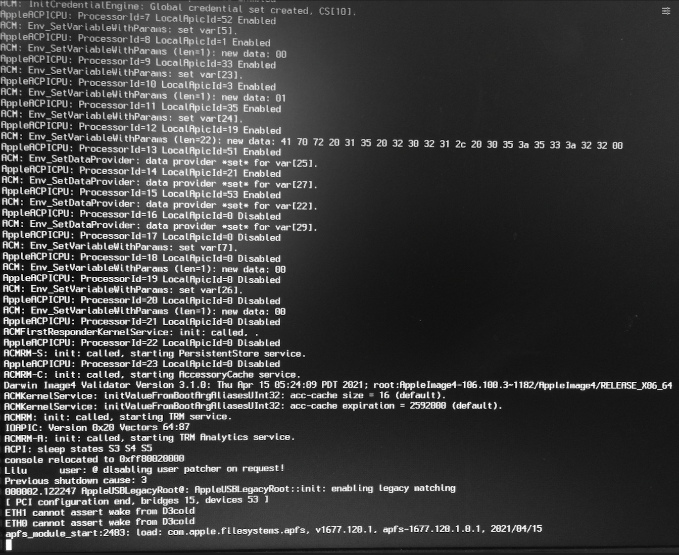

The boot-arg "cpus=N" sets the number of logical processors, so "cpus=1" means "use only one logical processor." If you're on a dual-CPU system with 12 total cores and hyperthreading, making a total of 24 logical processors, "cpus=" can range from 1 to 24. In that case, "cpus=1" uses only one core, without hyperthreading.

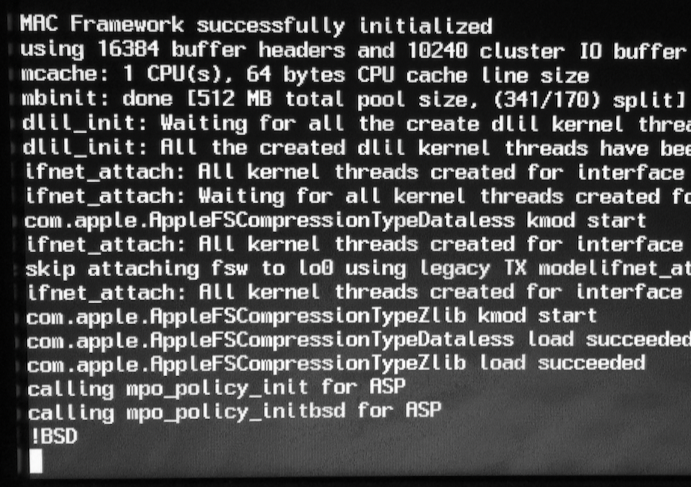

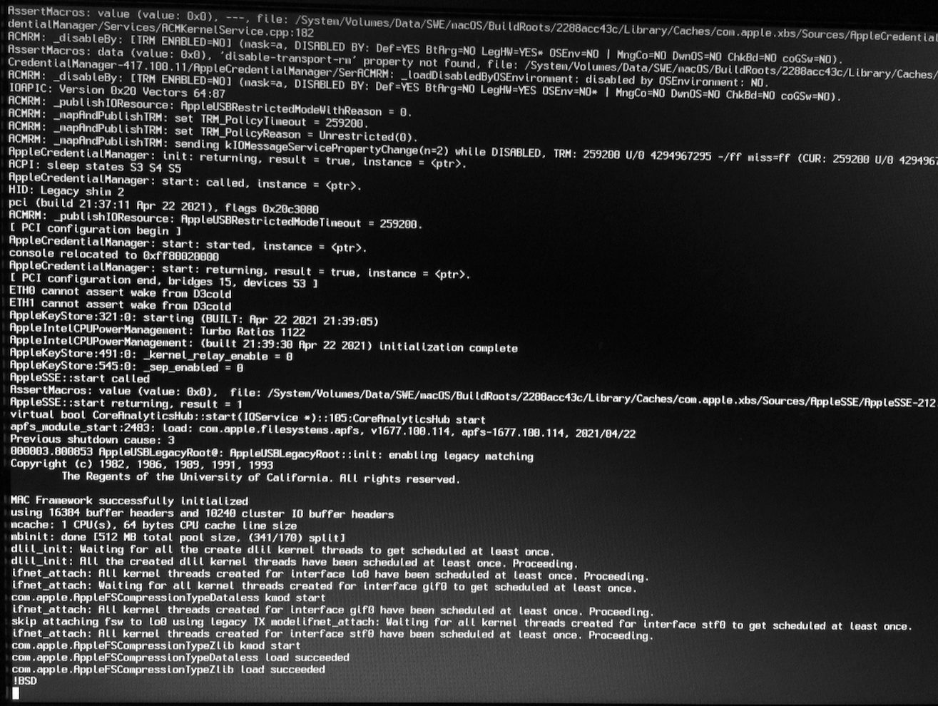

I decided to test cpus=1, and found something interesting. While booting 11.3.1 would freeze at random places before, setting cpus=1 freezes at exactly the same place, every time - 10x reboots. I don't think I've ever seen it freeze at !BSD, but it's 100% repeatable with cpus=1.
EDIT: 11.4b2 gets 2 lines past that point (with cpus=1).
Reactions: h9826790
Any predictable behavior in this situation is definitely interesting! Does cpus=2 change where the hang occurs? Also, perhaps the BSD patch could help with cpus=1.
Reactions: h9826790

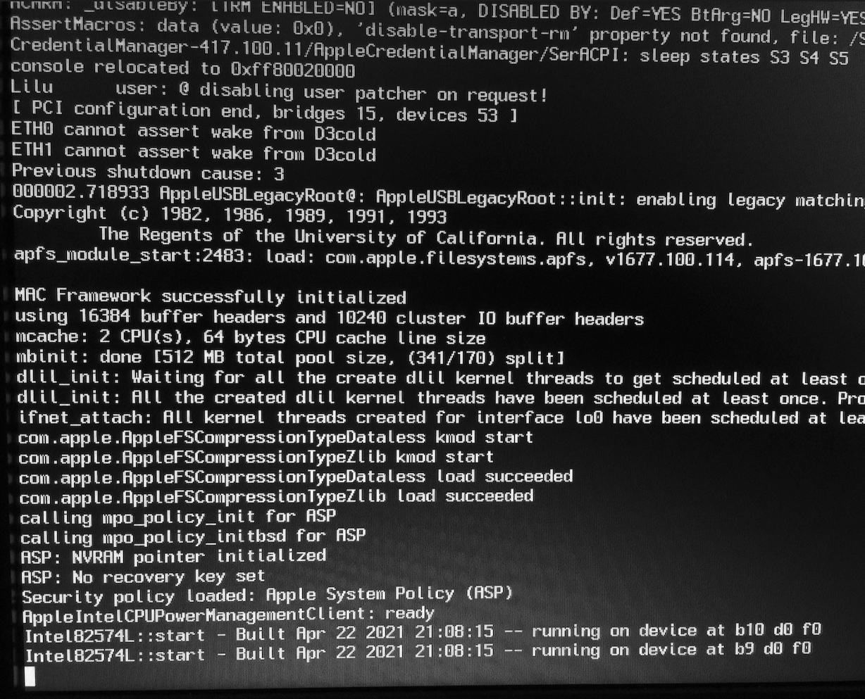

10x reboot iterations of cpus=1 hangs at exactly the same place (!BSD).
5x reboot iterations of cpus=2 hangs at exactly the same place (Intel82574L). Not enough iterations to call that 100% repeatable, but it was rare to see 2x freezes in the same location before, and I don't think I ever had 3x in a row, so strong evidence. Here's where cpus=2 hangs every time:
I set cpus=3 and got 4x login screens in a row. This is from my SATA SSD on PCIe. However, the 4th reboot hung at Intel82574L. The 5th reboot hung at the USB2 point, and resulted in the "prohibited" icon and screen mess, so it seems that cpus=3 is back to random.
Reactions: h9826790 and cdf
