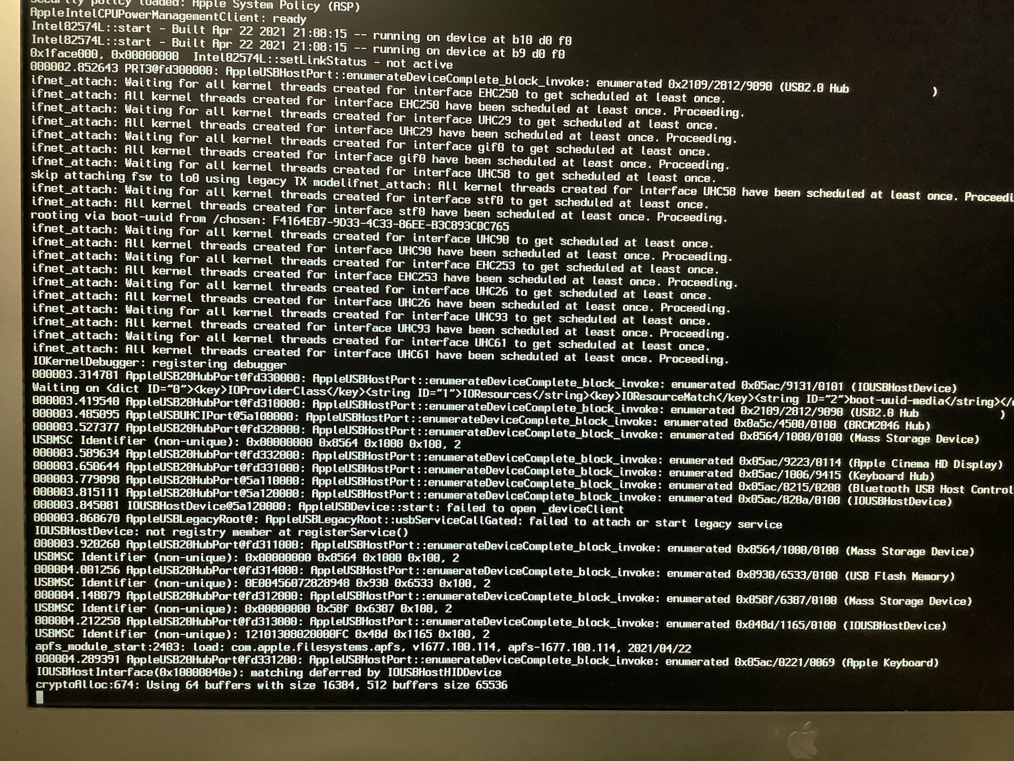

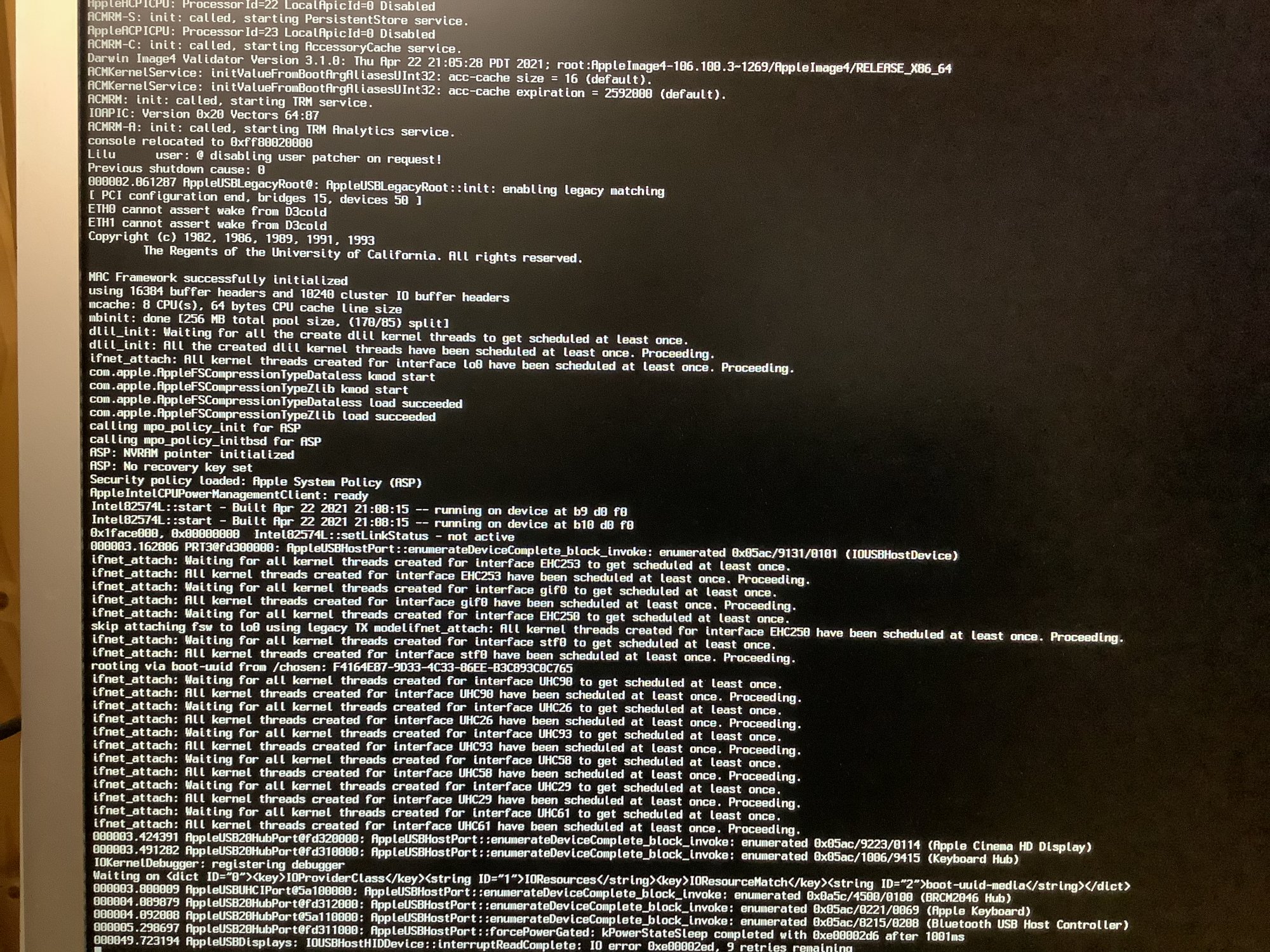

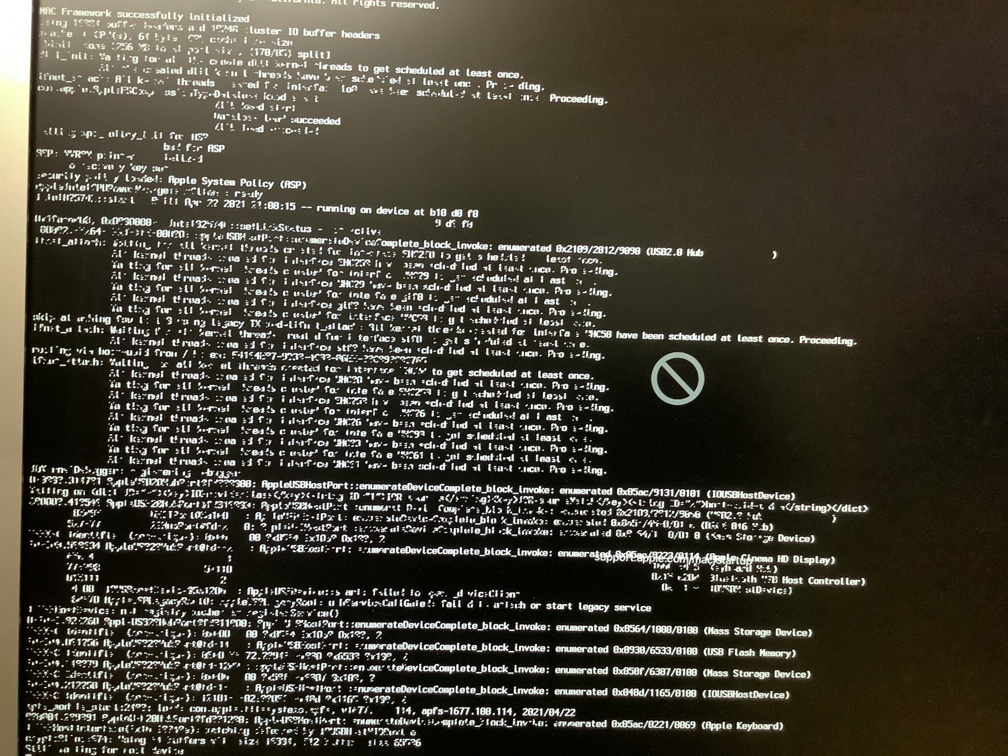

I have with oclp 0.1.2 sometimes an usb error with 11.3.1 when cold booting.
Edit: found a panic log in the oclp efi from com.apple.driver.AppleUSBDisplays
sata ssd with 11.3.1 and ahci blade with Mojave, just for stress test.
  • panic-2021-05-03-211849.txt

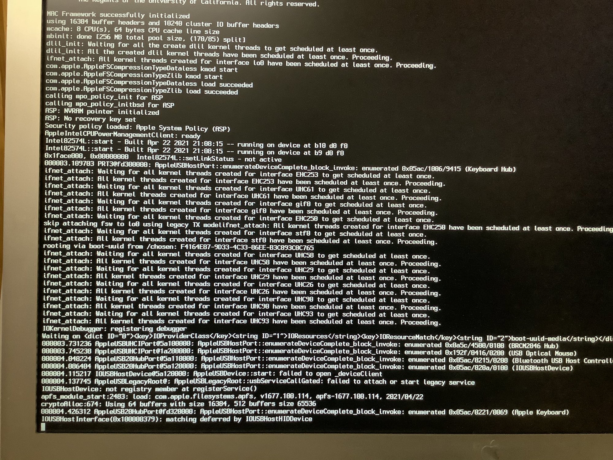

No more consistence with 11.3.1, tends to crash 1 times of 10 into USB drivers when I unplug the usb connection to the cinema display.
crashes 1 time of 3 when cinema display usb hub is plugged in.
so more usb problems with 11.3.1 than with 11.3
maybe a hint? USB?
edit: if I have just the USB Mouse connected, nothing else with a hub (cinema display and usb Apple Keyboard each has a hub) I can boot 10 plus times in a row with 11.3.1
same setup and machine when I booted 20 plus times 11.3 with all this usb stuff connected.

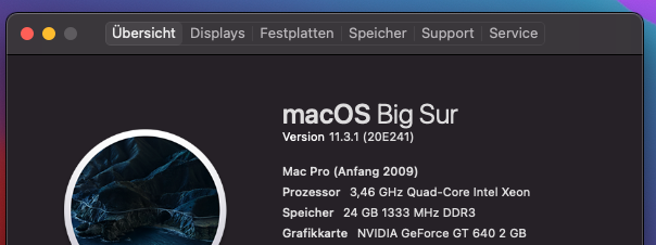

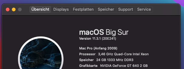

I just updated my iMac 12.1 to Big Sur 11.3.1 via OTA without any problem, I use OCLP 0.1.2.
Once the process is downloaded and restarted, it made three apple screens and took about 18 minutes

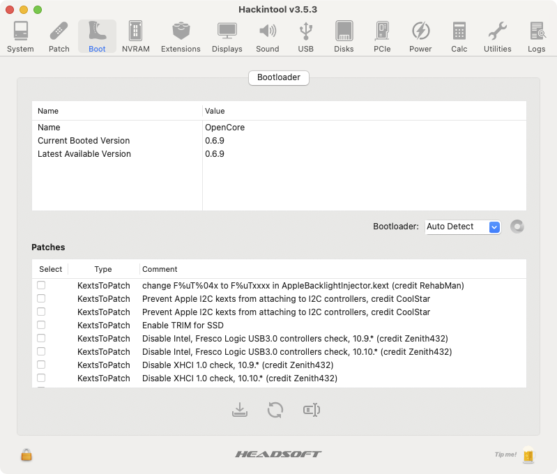

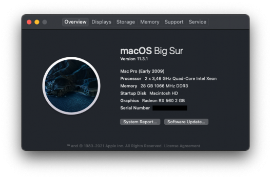

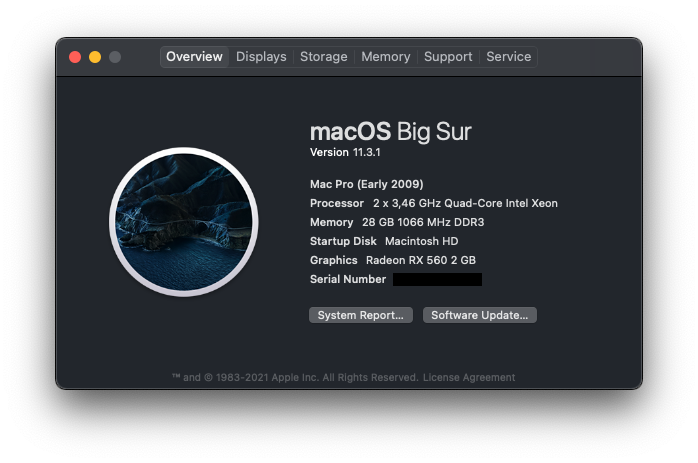

I'm running OC 0.6.8 with the Plistlib Generator setup.py example configuration (see #348 for my config.plist).
I'm linking the previous upgrade details, above.

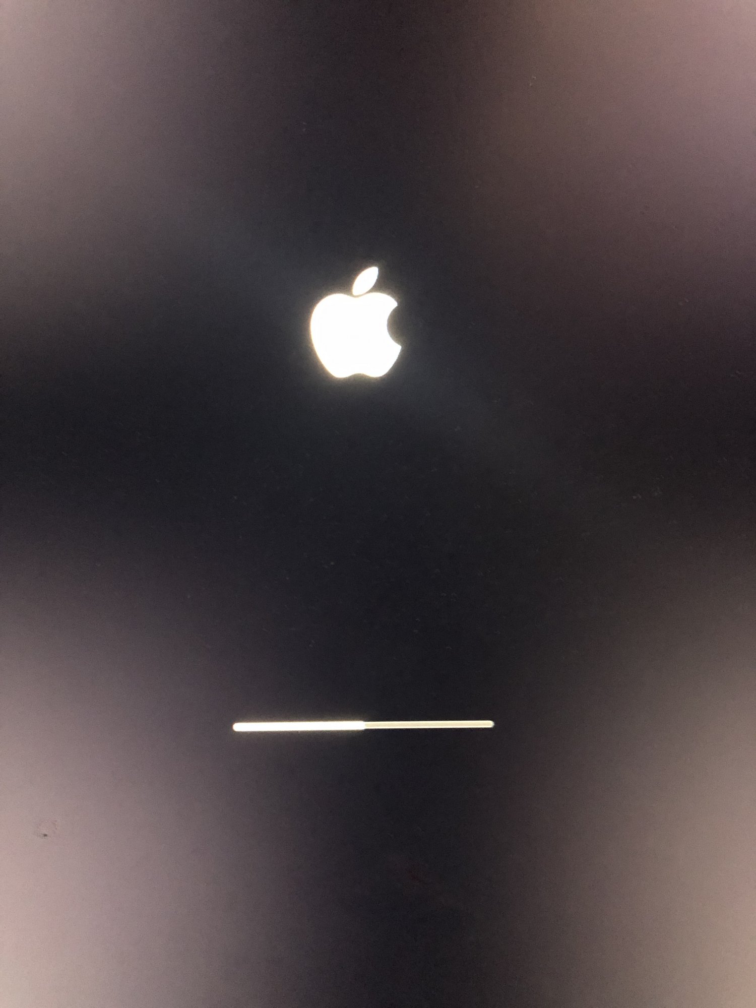

I successfully upgraded to 11.3.1 while running OC 0.6.8. During the upgrade, I believe I experienced the same frozen progress bar, this time in the middle (after 15min of waiting, I gave-up and did a shutdown):
After powering up the Mac, the upgrade continued and to my big surprise, I was not presented anymore with the dreaded "You shut down your computer because of a problem." error. I performed more than 10 random shutdowns/reboots (reboot, shutdown, reboot, reboot, shutdown, reboot, etc.), no issues whatsoever.
Next, I proceeded with the OC 0.6.9 upgrade and repeated again the 10 random shutdowns/reboots, no issues. I thoroughly tested Wifi and Bluetooth functionality, everything works as expected.

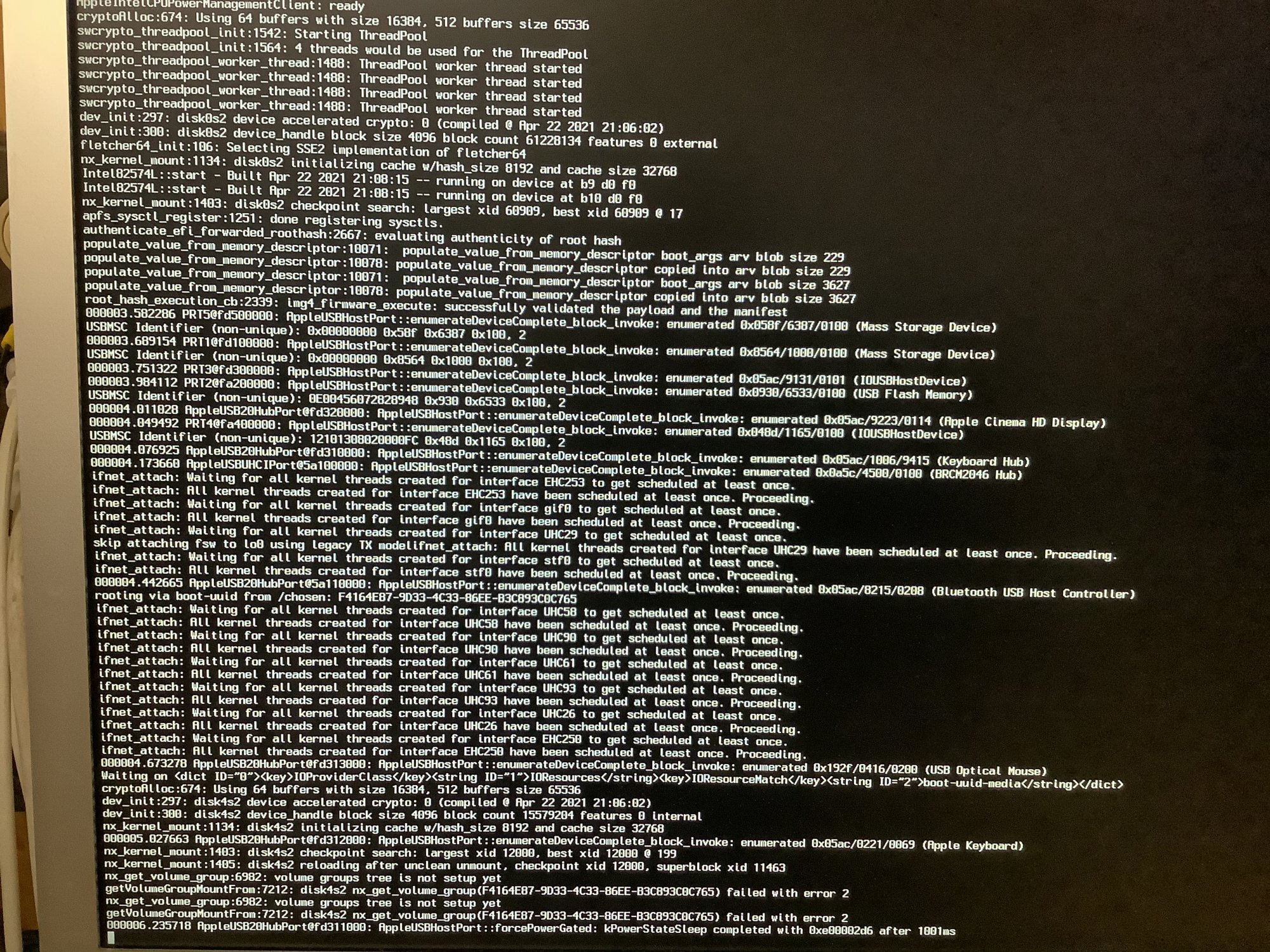

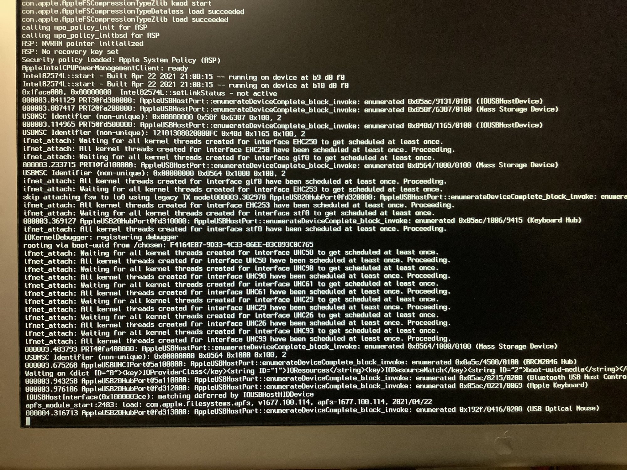

In case of USB problems with 11.3.1 I did a negative test.
plugged a whole bunch of USB thumb drives in every port and I cant even boot once!
@tsialex I'm thinking in reverse. What if a specific motherboard chip on my Mac prevents from having the issues others experience? I saw so far 3 more people who did not have any issues with the 11.3 upgrade. You have my BootROM, do you have a machine that matches all my chips or motherboard details? MX25L3205D, etc.
If I have just the USB Mouse connected, nothing else with a hub (cinema display and usb Apple Keyboard each has a hub) I can boot 10 plus times in a row with 11.3.1
I'm using no hub, only Apple Magic keyboard and Magic2 mouse. I forgot to mention this before, thank you for reminding me. I also have a Scarlett 2i2 3rd Gen attached to back USB2 port, I use it to send sound from my Mac to a pair of Yamaha studio speakers.
I'm using no hub, only Apple Magic keyboard and Magic2 mouse. I forgot to mention this before, thank you for reminding me. I also have a Scarlett 2i2 attached to back USB2 port, I use it to send sound from my Mac to a pair of Yamaha studio speakers.
the usb problem seems to be a bit oclp related.
I used oc 0.6.9 with cdf's config plus all my bunch of thumb drives and it booted 11.3.1 - a few times and it also crashed.
Maybe the race condition, who knows.
but it's still worth a test to test USB stuff.
