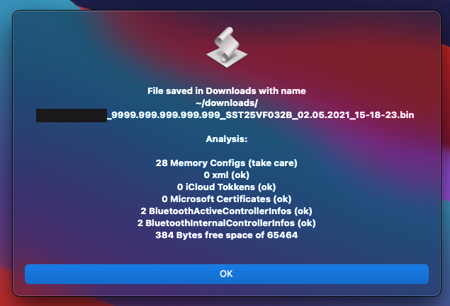

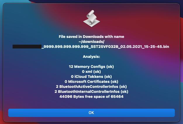

I ran the tests,
also I dumped the Firmware and analyzed free space with my script.
As it was at 1444 free space (!) the next boot failed.
So the circular nvram garbage collection (what every Firmware with nvram in decent condition does) ran.
Was back to ~36000 free space and 11.3 booted again.
With every reboot the nvram gets a little more filled until close to full, circular nvram garbage collection ran automatically and I assume the next boot will fail. If this changes the "race condition" or something else, I dunno.
That seconds the experience that after a triple bong (manually triggering the nvram garbage collection) 11.3 will tend more to boot than to fail.
It's just my theory.

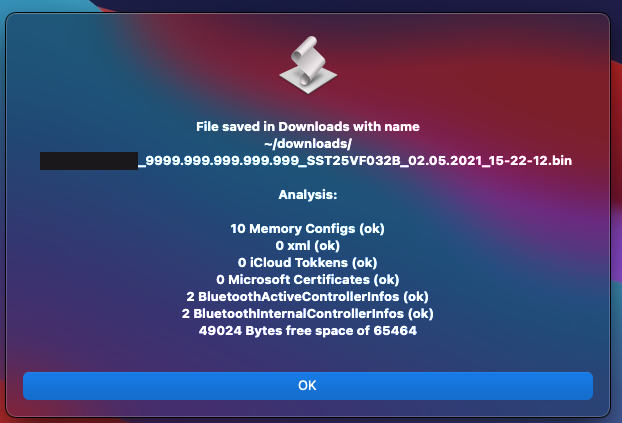

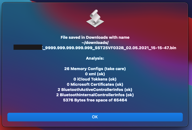

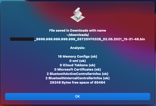

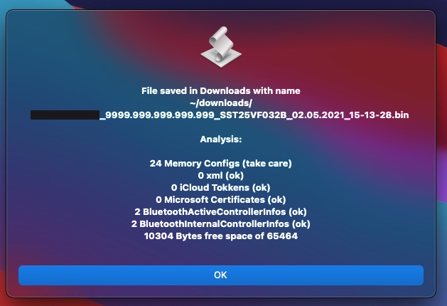

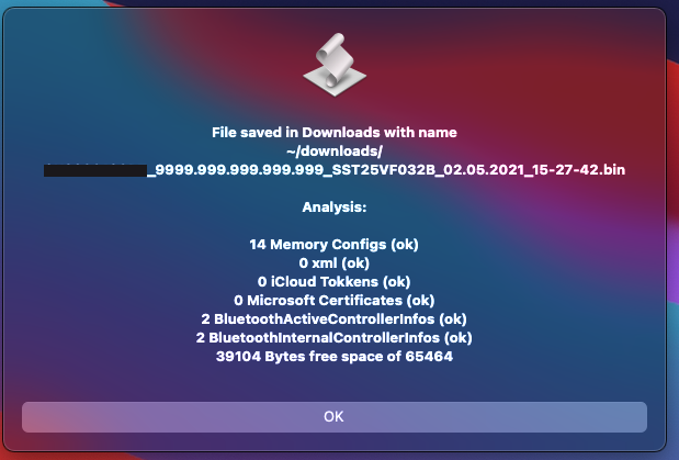

Select "Reboot" from the login screen 20x, and let us know if you experience any hangs.
I ran the tests again, this time I took care to set Startup Disk from the prefpane to the Big Sur 11.3 Disk.
I restarted more than 20 times, this time logging the nvram free space thru a complete nvram circle (from filled to full to garbage collection to the same filled situation) and it survived
that was a Sata SSD, Kepler, OCLP 0.1.2 on a Single CPU 4.1 with 144 reconstructed Firmware.
