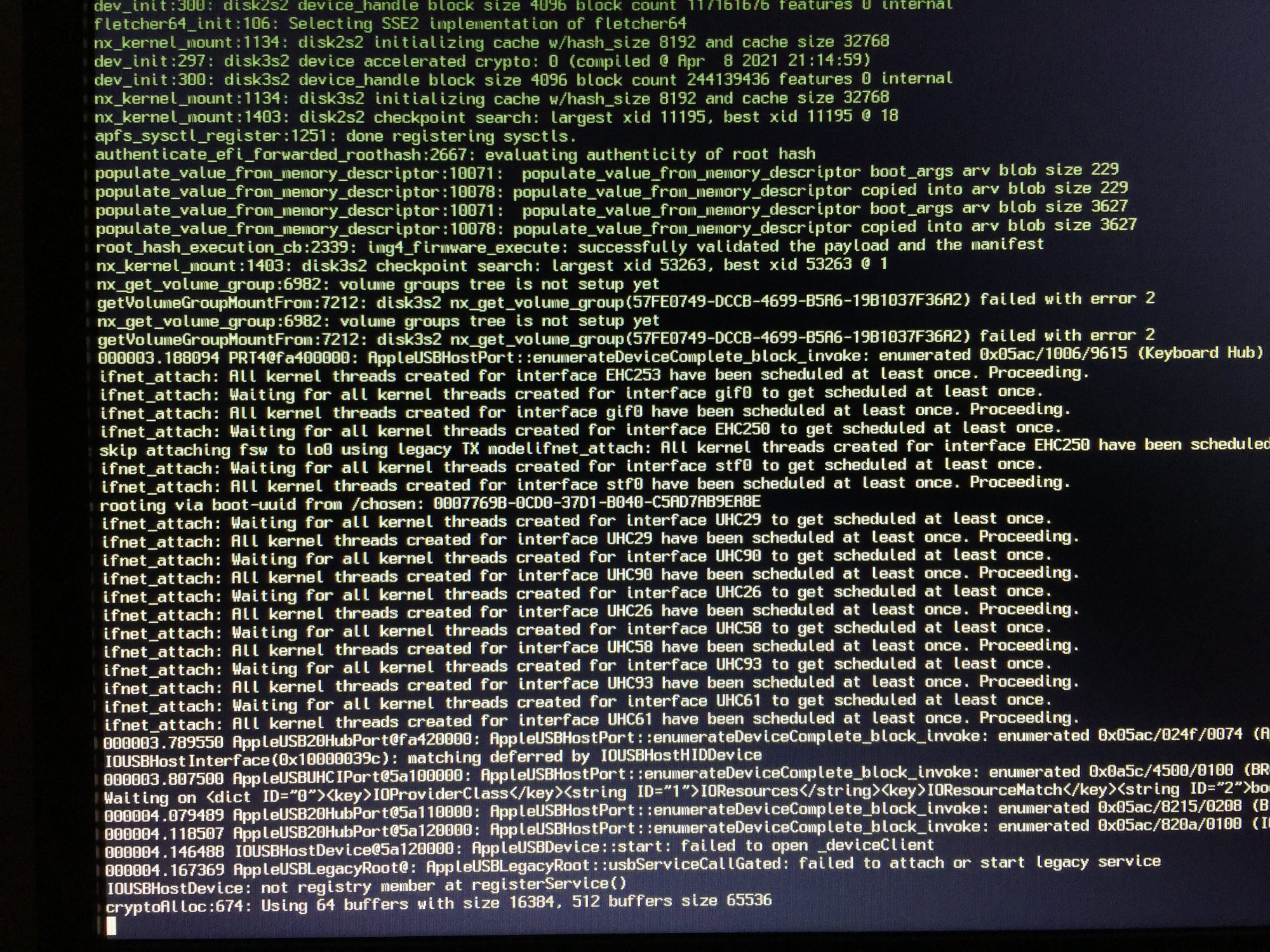

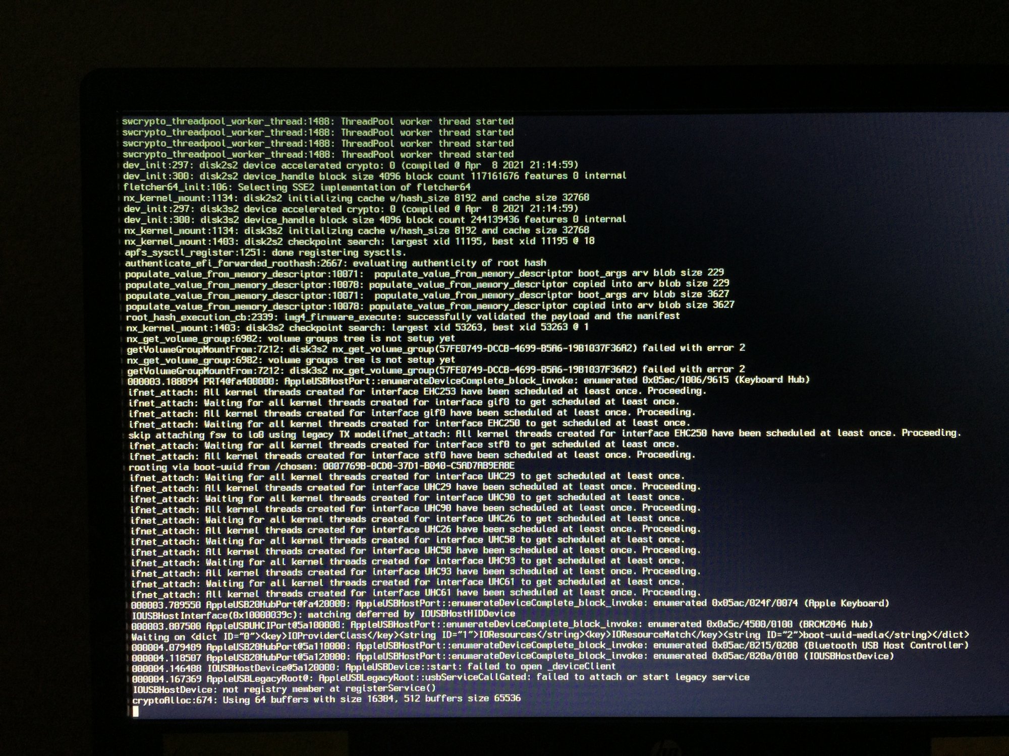

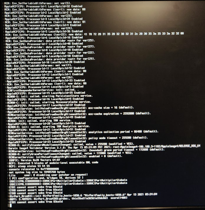

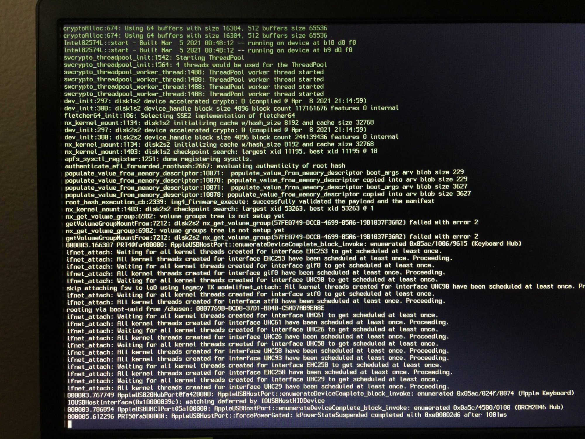

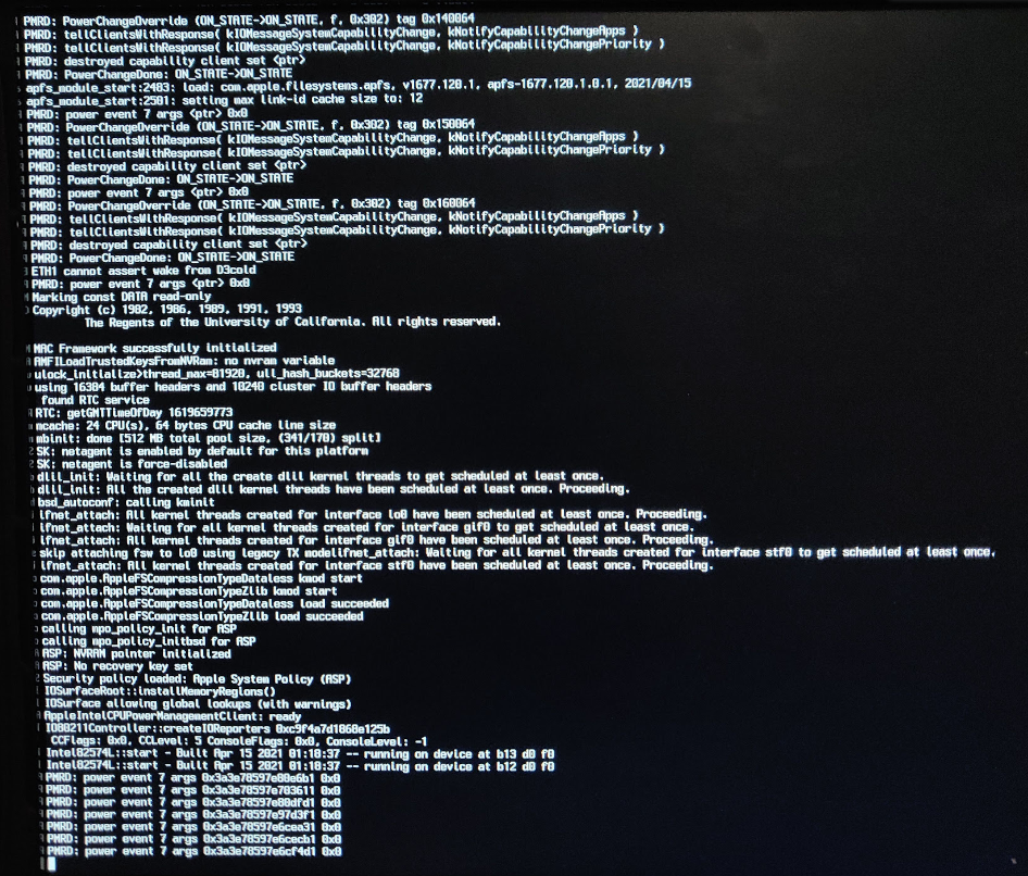

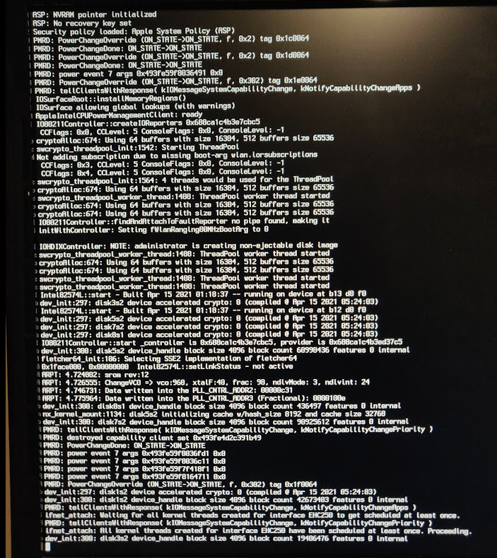

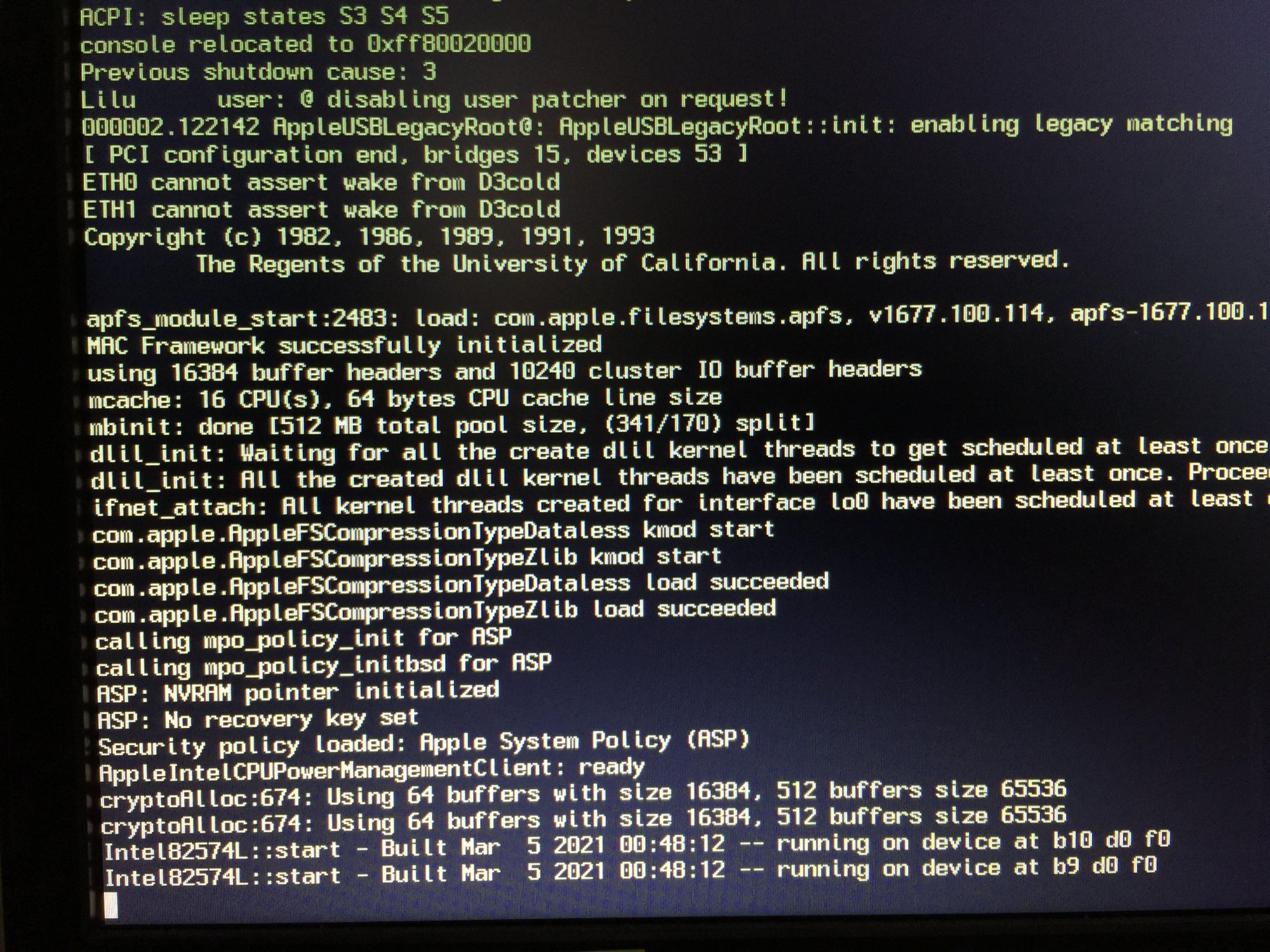

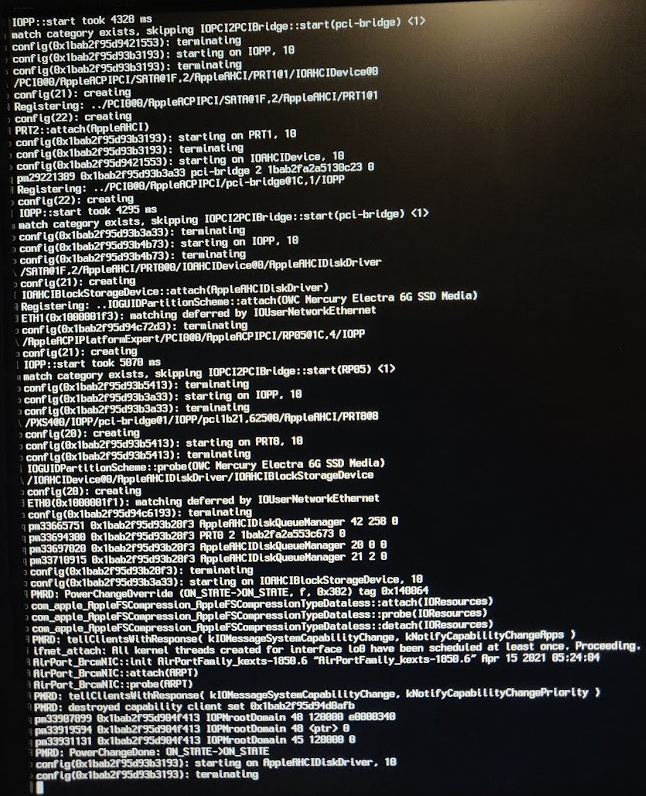

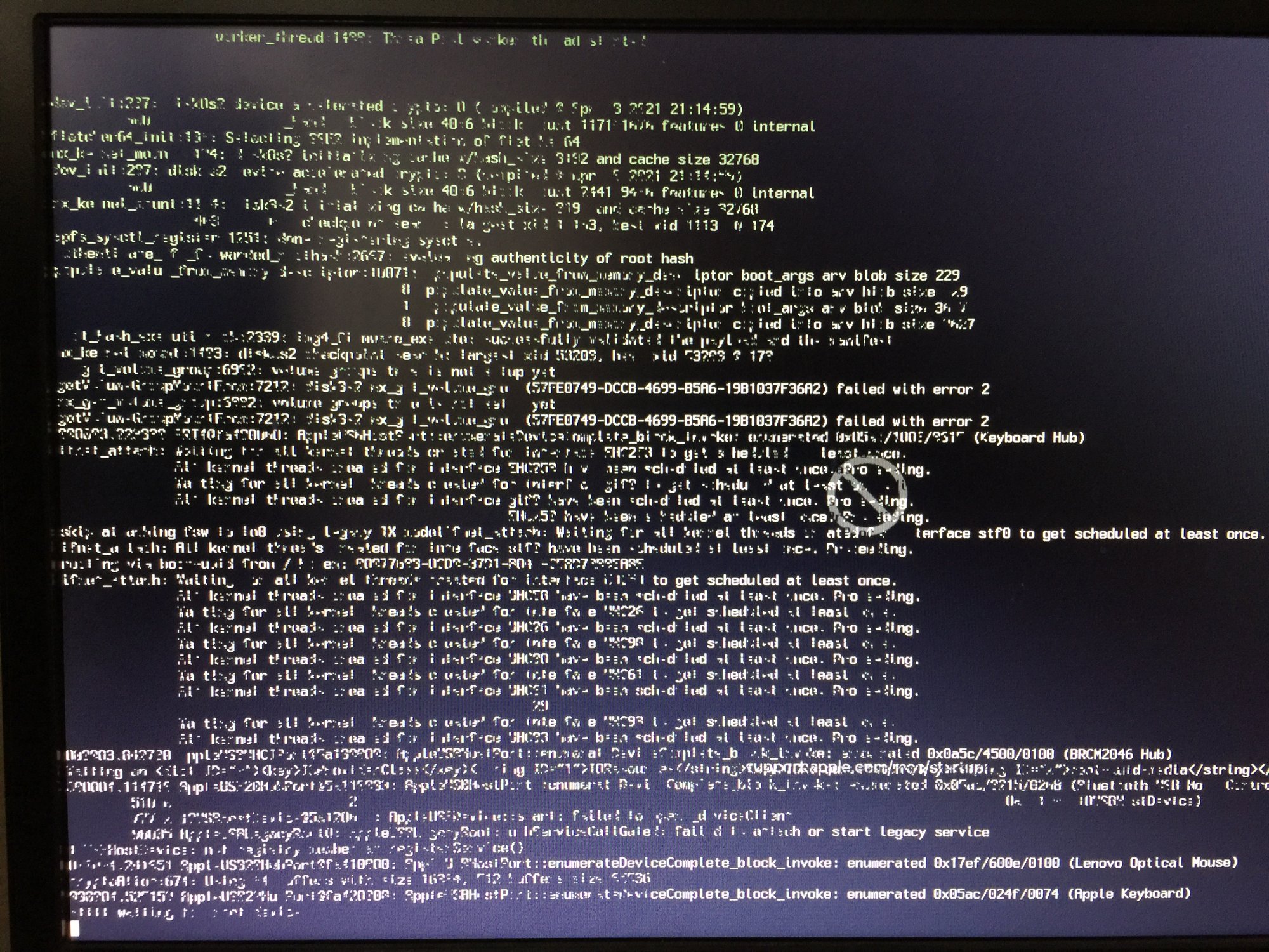

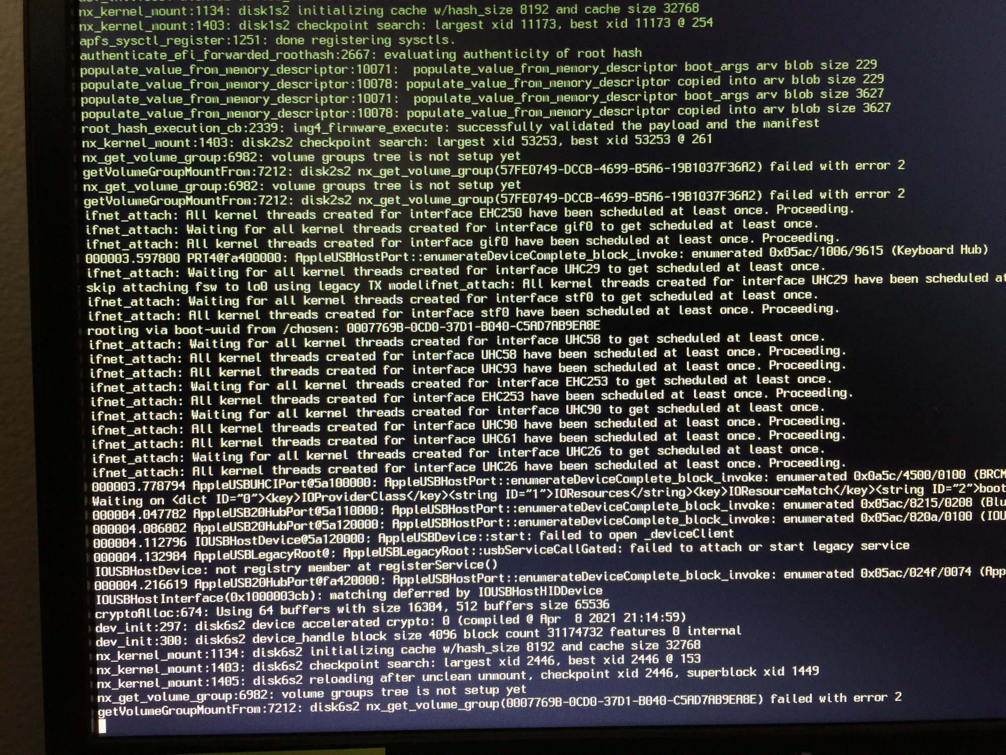

Here are a few screenshots of hangs I had yesterday (haven't powered on the test machine today yet). Booting from a SATA SSD on PCIe card, which has a 50% success/fail rate after 10's of reboots.
Reactions: AlexMaximus
Actually I left it on for a while and I saw something print on the screen after the prohibitory sign.
If you let it sit for a while (don't recall if 30s/1m/more?), it keeps adding blank lines to the bottom, and shifting the text up. I haven't seen it add any additional text on mine though.
Examining things a bit further ... Those two Intel82574L entries being the last items does not mean it hangs/crashes there. Just seems there is much less logging afterwards.
Seems it tries to see whether the machine is networked with those Ethernet kexts. It then returns from "IOFindBSDRoot".
Once it returns from this, there isn't as much logging and seems things either work or you get KPs. The panic is presumably the log source.
Hopefully related to those kexts as otherwise the trail goes a bit cold without the KP log.

io=0xff and smc=0xff boot arguments will give more printing. The problem with io=0xff is that the text scrolls very fast.

I need to step away from this for a while, but I have a working theory.
Like Catalina, Big Sur uses the split volumes (e.g. "Big Sur" and "Big Sur - Data") that APFS magically sews together as a Volume Group. Because of the Signed/Sealed System Volume, Big Sur does a lot more hashing and verification, though.
In the majority of @JohnD's screen photos, I see nx_get_volume_group and getVolumeGroupMountFrom errors. Those functions are part of the APFS kext. The "getVolumeGroupMountFrom...failed with error 2" is a direct consequence of the "nx_get_volume_group: volume groups tree is not setup yet" error. A background thread should be building that tree and dealing with all the hashes, but when the bootloader is ready to go, it's not done yet. Since the Volume Group doesn't exist, neither does the Boot Volume that the bootloader wants to see - and hence the "still waiting for root device" errors.
I think that perhaps Apple introduced a race condition that can cause the APFS volume group creation thread to block. If the wind is blowing in the right direction, you might get lucky; if not, it hangs. So why might the MP3,1 not suffer as much? I think that's partly due to the math - the APFS kext uses the CRC32 instruction if it's available (which it is on MP4,1/5,1), but uses a software CRC32 if not (as on the 3,1). That means the MP3,1 will always be a little slower calculating the hashes. If there really is a race condition, slower might actually be better.
One thing that someone might want to try is downgrading the APFS kext to the last good Big Sur version (was that 11.2.3?). I have no idea if they mangled any of the structures such that the older kext won't work, but it might be worth a try. The actual cause might be entirely outside of APFS, but right now, APFS seems like the focal point.
Also, is everyone running with sealed volumes, or without? Or do unsupported Macs even have a choice? (I haven't kept up with the Big Sur patchers very well...)
Good luck to all, I'll be back at some point.
