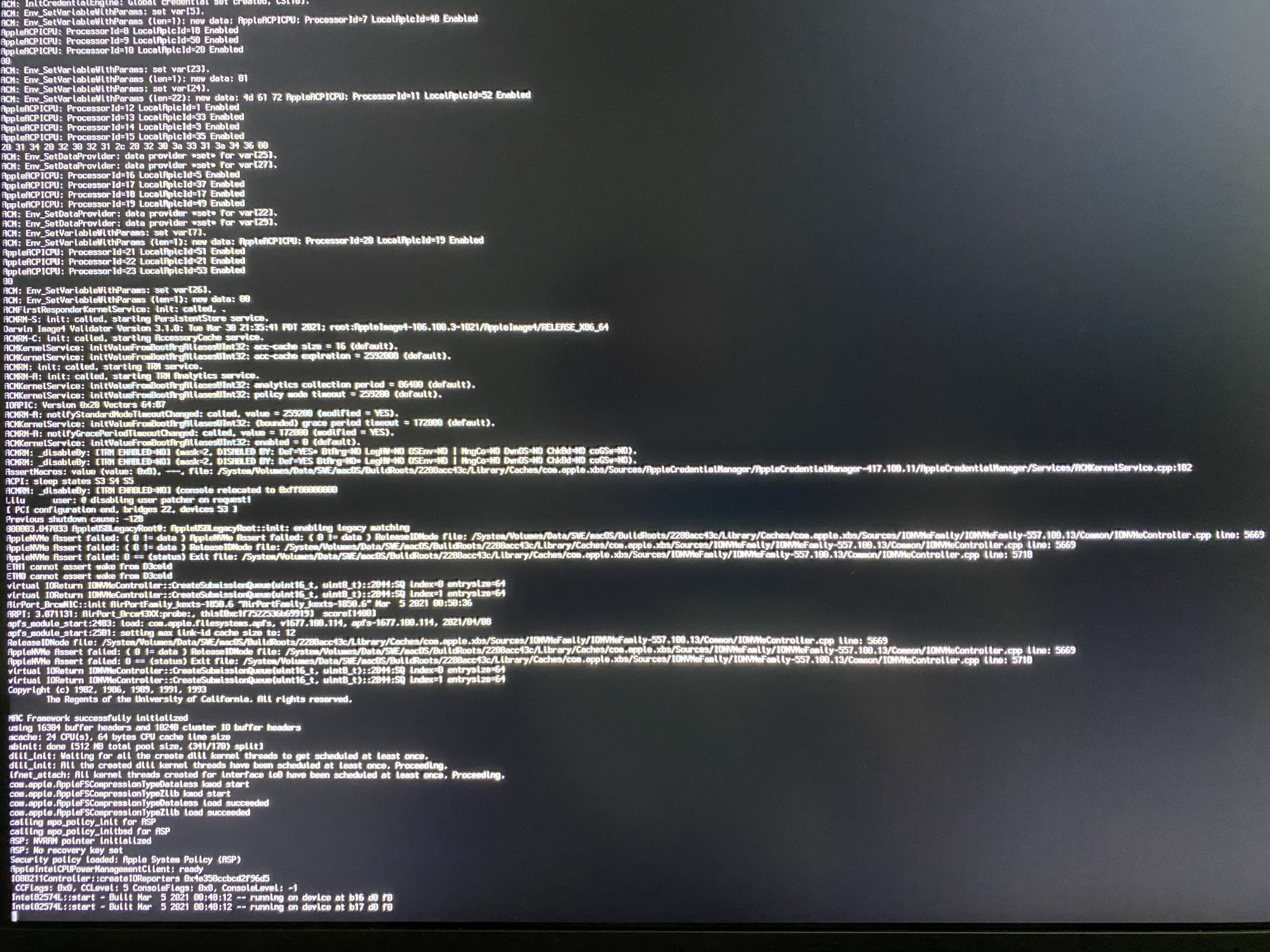

I'm only testing SSDs, I'll take a look at a HDD - it wouldn't be too crazy that with the relaxed timings for a HDD the success rate improves.
Tried with a USB-connected HDD. Still hangs.
Have you guys tried to slow the machine down like with the bootarg cpus=1 ?
Tried cpus=1. Still hangs.
One thing I noticed: shortly after the hang, sometimes I see the line "!BSD" appear in verbose mode. Does anybody know what that indicates?

It appears that the "!BSD" message only means that when IOFindBSDRoot() is called, there are no IOBSD devices still initializing (the lack of "!BSD" should indicate that IOFindBSDRoot() had to wait (up to 30 seconds) for one or more IOBSD devices to complete their initialization).
Seems your hang is this wait period:

The assert()s are no-ops in production kernels. I don't have 11.3 to verify absolutely, but in every other production kernel, assert() is a no-op, and can be ignored when analyzing the code (it's mostly useful to understand the programmer's intent). It's definitely that way in 11.1, which is the newest 11.x I have here.

A crash could follow at some point. I'm not trying to be argumentative, but I've now spent months poring over the MacOS source code and disassemblies, working on my AVX integration, and I know that many of the assert()s in the code are non-fatal. Some even appear to be quick-and-dirty debugging statements that probably should have been removed but got overlooked during cleanup.
In this case, we know that assert(matching) passes muster, because matching->setObject(... would immediately panic if it didn't (and the "!BSD" message would not be displayed).

Also, until proven otherwise, it seems as if that message at startup must mean that something has (quietly) failed, crashed or panicked somewhere, either during the boot itself (less likely) or in the previous shutdown (more likely) - but I agree that is also not proven.
Was speaking in general terms on what to expect on ASSERTS. Didn't expect Apple code would be so sloppy but we learn everyday.
Point is that the message, from what I can make of @cdf report, is not there all the time.
So, speculating that in some cases, the ASSERT condition is not met and it chokes thereafter.
It seems he sees the message only after using a slow connection (USB Drive) or after reducing CPU.
Asked him earlier for whether there is a pattern on when this message comes up to be sure.

I can't identify a pattern. Sometimes it shows up, sometimes it doesn't. HDD or SDD it doesn't matter. And that goes for the prohibitory symbol, too. More data: When it does show up, "!BSD" appears exactly 30 seconds after the hang. Similarly, when it does show up, the prohibitory symbol appears exactly 1 minute after "!BSD" if that message did show up or after the initial hang, otherwise.

The hanging at boot occurs even with no NVMe device at all. This is not an NVMe thing. IONVMeFamily panicking is a symptom not a cause of this unfortunate situation.
Do you get a mount(x) failed where 'x' is a number that iterates up?
Either with the sign or otherwise?
