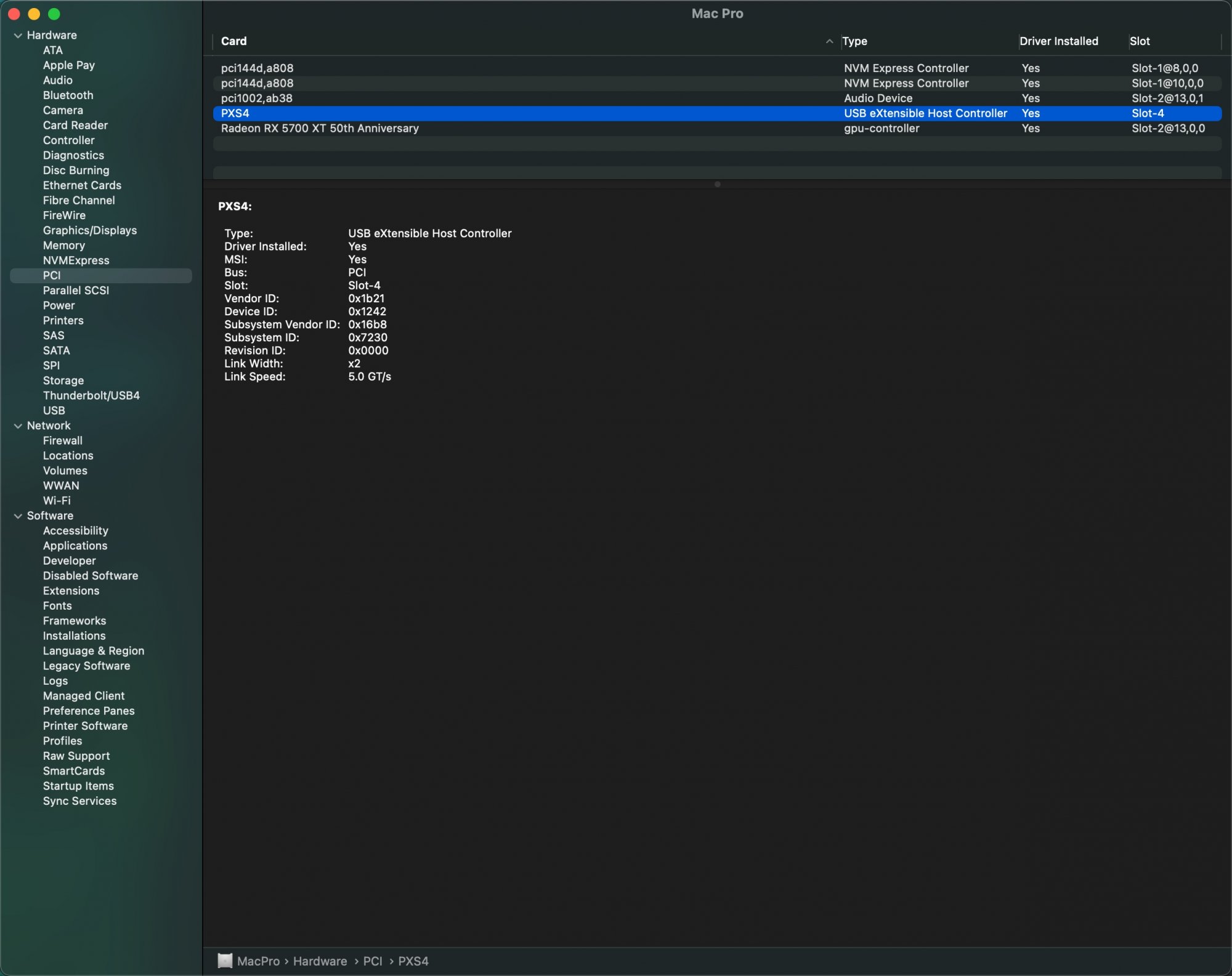

Got USB-C working - Ran ONYX and added a second SSD connected via SATA (Catalina rescue installation) followed by a shutdown then reinstalled the USB-C card in slot 4 and booted.

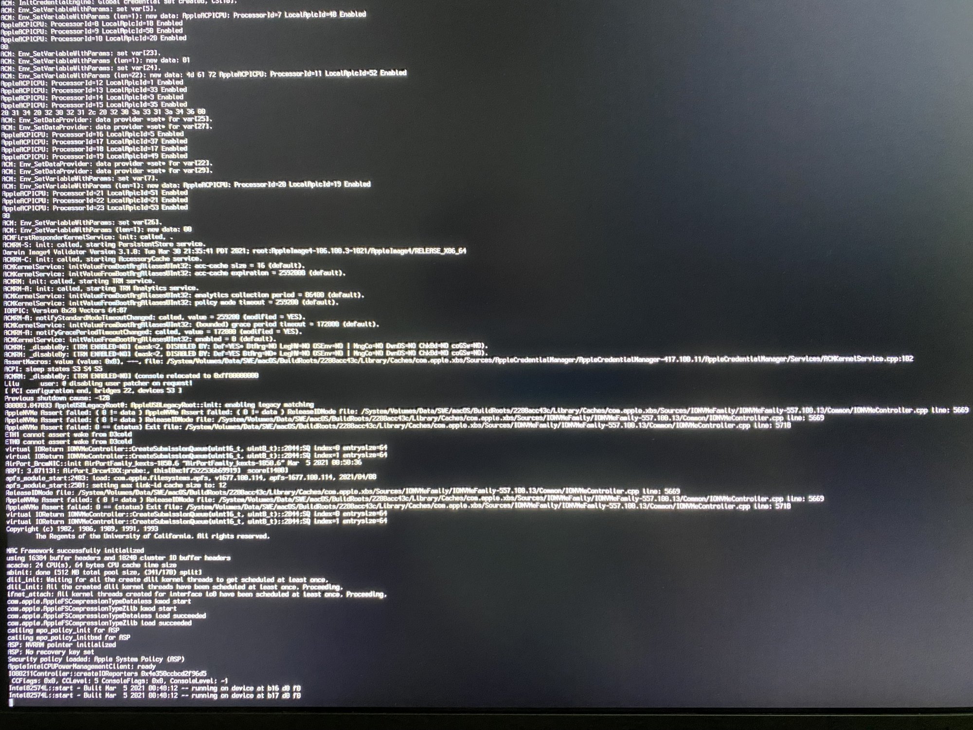

I'll share a new screenshot of any new boot failure that arises.
Edit: added screenshot
Yes, thx! I also have frequently "Previous Shutdown Cause: -128" and I think that others have it too.
If you get something different, please take a photo.

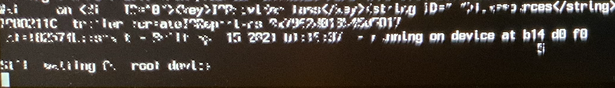

I seem to always get:
Code:
Previous shutdown cause: 3
The hang usually happens at this message:
Code:
rooting via boot-uuid from /chosen: XXXXXXXX-XXXX-XXXX-XXXX-XXXXXXXXXXXX
Waiting on <dict ID="0"><key>I0ProviderClass</key><string ID="1">IOResources</string><key>IOResourceMatch</key><string ID="2">boot-uuid-media</string›</dict>
1080211 Controller::create I0Reporters 0xXXXXXXXXXXXXXXXX
Intel82574L::start - Built Apr 15 2021 01:18:37 -- running on device at b14 d0 f0
Intel82574L::start - Built Apr 15 2021 01:18:37 -- running on device at B15 30 f0
After 1 minute, the letters on screen distort and the prohibitory symbol appears. But I've also notice that another message appears at this moment. It's distorted, but it says "still waiting for root device." The OpenCore manual mentions a similar issue, describing the ExitBootServicesDelay quirk. Unfortunately, the quirk has no effect in this case.
All of these are from the "IOFindBSDRoot" function posted earlier.
It is basically timing out due to some IO issue after 10 attempts at mounting something has failed. Needs checking what that "something " exactly is but initially looks like some disk/drive.
"Still waiting for root device" seems to be the key and seems to be targeted at Intel but all the stuff there seem to be filesystem related.
Code:
Code:
