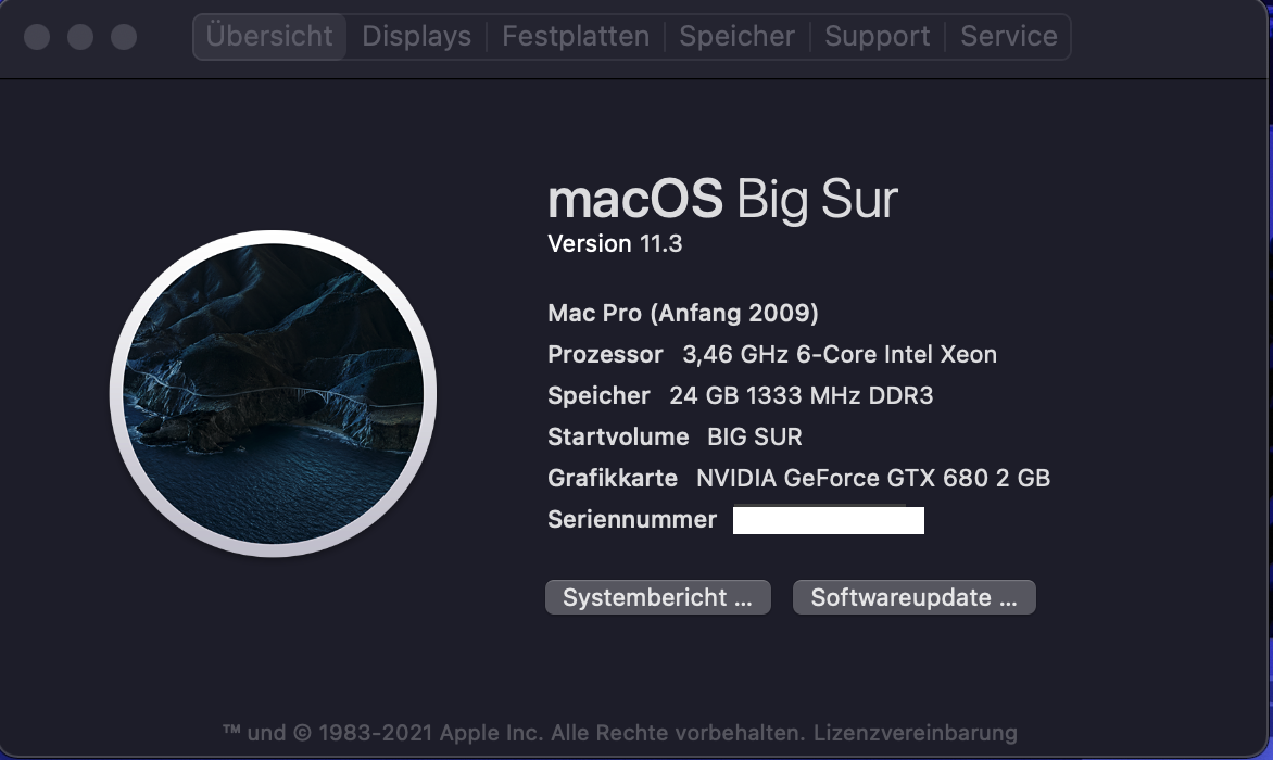

My machine behaves exactly as TECK described in #300. I installed Mojave on a SSD in bay 1. Then I pulled all HDD sleds except for bay 1. Then I downloaded Martin's Package and installed it by the book on the EFI partition of the Mojave drive. Boot picker worked. After that I put the sled for bay 2 with another SSD back in. Then I downloaded Big Sur 11.3 and started the installer from Mojave an installed on the bay 2 SSD.
The install hung once with a progress bar freeze. After a forced shut down it ran through.
Then I moved OC to the Big Sur drives EFI partition. Everything works. The only problems I have are the warm boot issues, the messages that I did not shut down the machine correctly and mysterious recovered files in the trash.

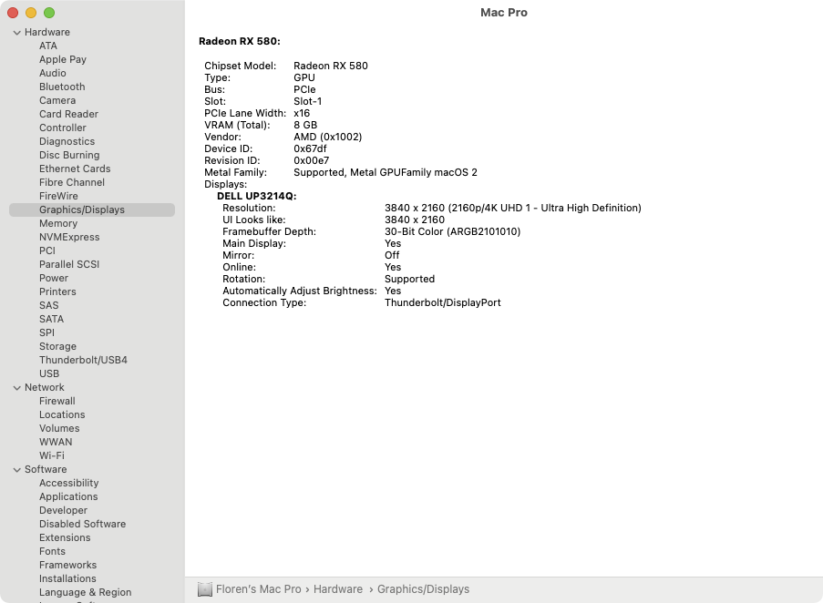

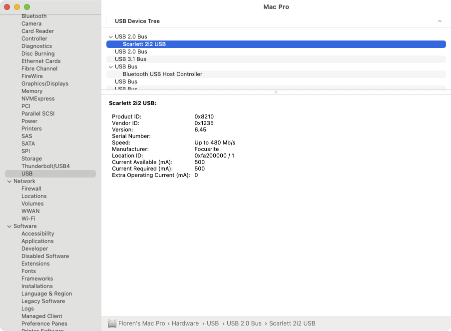

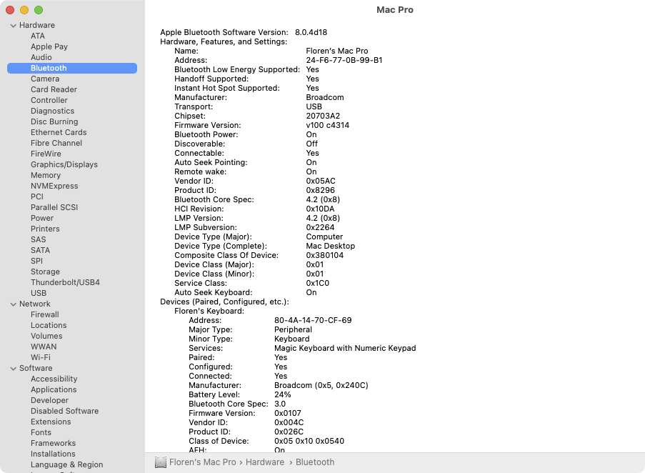

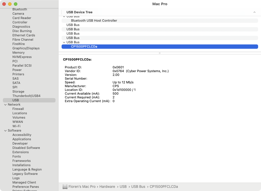

What's connected to the cMP, and which port?
Dell UP3214Q with cable connected on Mini DisplayPort to RX580 DisplayPort:
Scarlett 2i2 connected to back USB2 port:

CyberPower UPS connected to back USB2 port:
Apple Bluetooth Magic keyboard and Magic2 mouse:

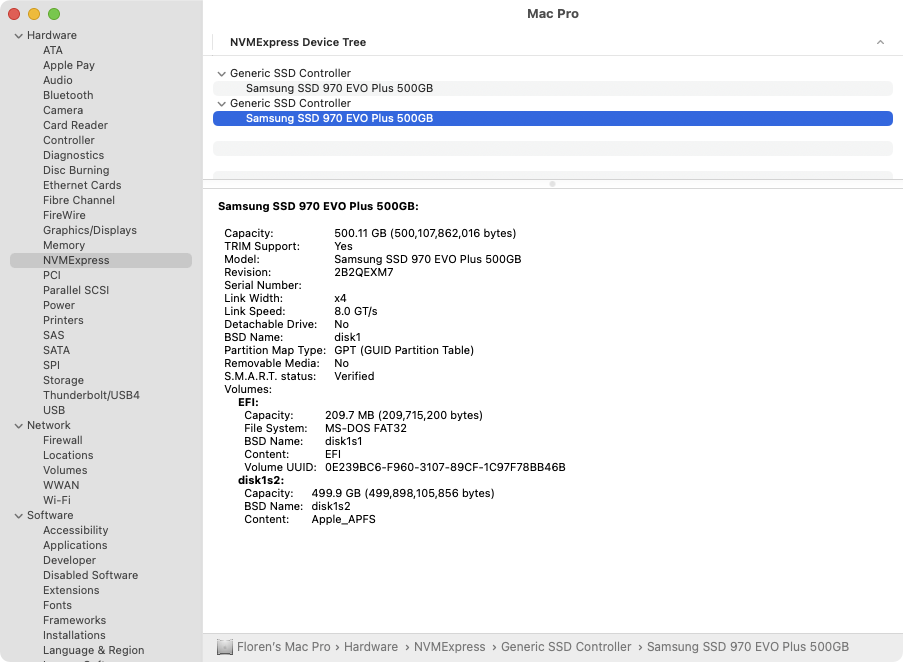

Where you install OC?
EFI disk1s1 partition:
