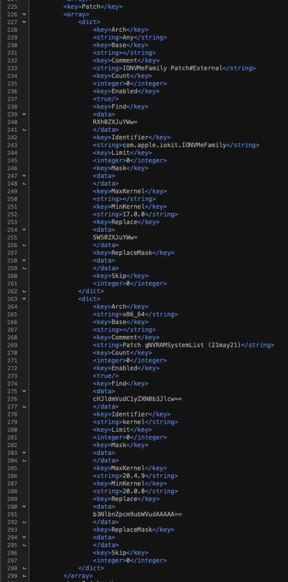

your patcher result is 0 mine is 6:
Code:
28:505 00:086 OCAK: 64-bit Patch gNVRAMSystemList (21may21) replace count - 1
28:521 00:015 OC: Kernel patcher result 6 for kernel (Patch gNVRAMSystemList (21may21)) - Success
Edit: Unfortunately I still have panics. 1 out of 2,3 reboots is successful.

if anyone has trouble applying patches with Xcode or a text editor, then use "OpenCore Auxiliary Tools OpenCore Configurator OCAT" kinda recommend by Acidanthera
