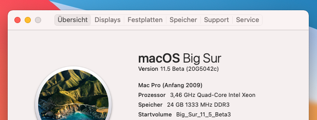

Edit: Race condition is still there, if I populate the Sata Bays with Disks it stalls on loading Ethernet Drivers, as before.
Could boot with 2 AHCI Blades in. System is on a 3,5" spinner in Sata Bay.
OCLP 0.1.7 is causing kernel panics with Big Sur, booting Monterey is fine.
Lets see if it's better with 0.1.8 and Big Sur.
additional note:
I can populate all my Sata bays, 2 PCI Slots with Apple Blades and 11.5b3 boots.
This time with OCLP 0.1.8, Kernel Panic is gone, thank you guys :)
But I need to unplug my USB stuff during early boot phase.
The Bluetooth Board on the backplane is unplugged as well.

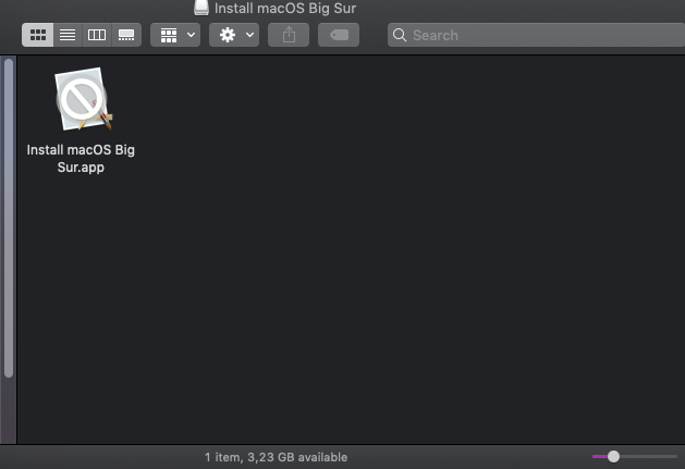

And even an old BS bootable USB I made, maybe BS 11.1, can't be sure, as I can't verify what version is it (can I?) Just the installer was created 25 aprl 2021...
But for sure, USB pendrive contains an installer, and on Mojave this installer can't be launch and it said damaged...
Plus, the script I used to use, coming from OC thread for older MP, just propse BS 11.4

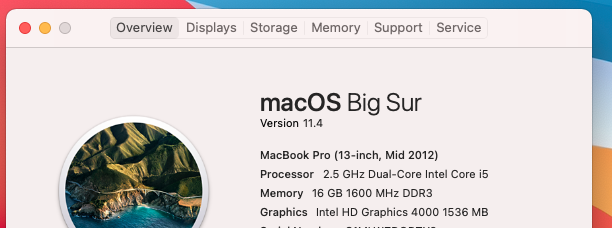

Just a FYI,
I am running OC 0.69 & BS 11.4 on two Mac Mini Mid 2012 and on two MacBook Pro Mid 2012.
Smooth as butter with no issues for a few days. No such luck on my MP 5,1.

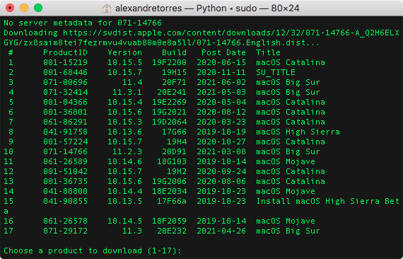

Well, where find older BS releases?
an image of 11.2.3 uploaded by @khronokernel, more here:
