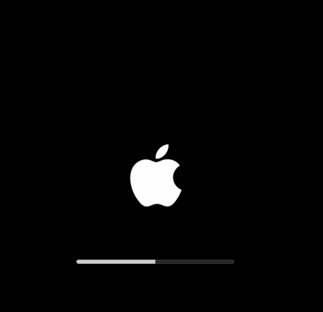

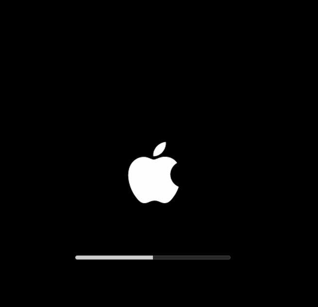

Upgrading Big Sur 11.2.3 in a Parallels virtual machine to 11.4, on my 5,1 Mac Pro running 11.2.3. Well now, isn't this interesting?
EDIT: Stuck again? On a virtual machine? Seriously? This has to be a clue. Virtualized hardware exhibiting the same behavior as bare metal.
EDIT 2: 11.4 installed fine after another reboot, but many attempts to install Monterey get stuck halfway through the progress bar every time. I was attempting to upgrade from a Catalina VM, so maybe I'll try a native install, upgrade from a fresh Mojave install, and upgrade from a fresh Big Sur install.

I have 11.4 working fine on a Parallels VM. I did have lots of difficulties in updating an 11.2.3 VM to 11.3 and had to create a new VM from scratch.

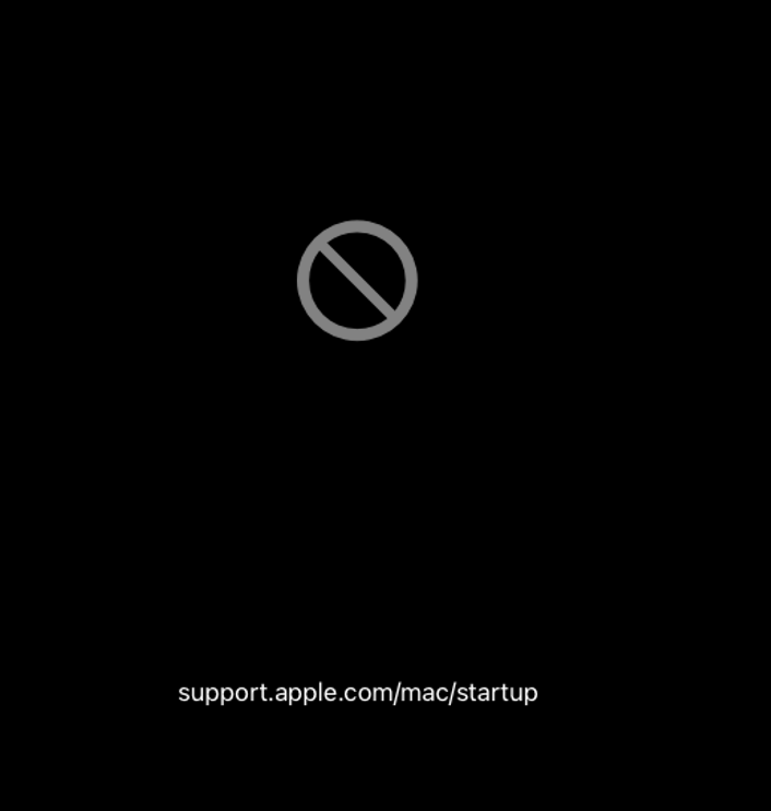

I use Martin's OC, 0.70 version.
I have Mojave in an adapter to SSD on Bay 1.
OC is on EFI's Mojave.
I have a PCIe dual SSD bootable card with only one SSD that I managed to install latest Catalina (no luck with directly installing BS 11.2.3).
I tried then to update from Catalina to BS 11.2.3.
It reboot with the Installer present in the Picker.
Then it tried to install but same as when I tried to directly install BS, the progress bar is at 10%, then the mouse pointer shows up, then it reboot... Endlessly.
I tried NVRAM reset 5 times during the reboot, and I tried force shutdown, and start, but same story...
Anyone have a clue why even BS 11.2.3 won't go to the installation screen?
Thanks in advance.

Thanks.
Thanks in advance.
Go back to the start!
Get Mojave running natively on an SSD i.e. no OC.
Now follow these instructions exactly to upgrade to Catalina https://forums.macrumors.com/threads/opencore-on-the-mac-pro.2207814/
Use the vanilla OC and standard SSD's i.e. no PCie.
Now download 11.2.3 and upgrade
View attachment 1794245 View attachment 1794247
It is working for me.
