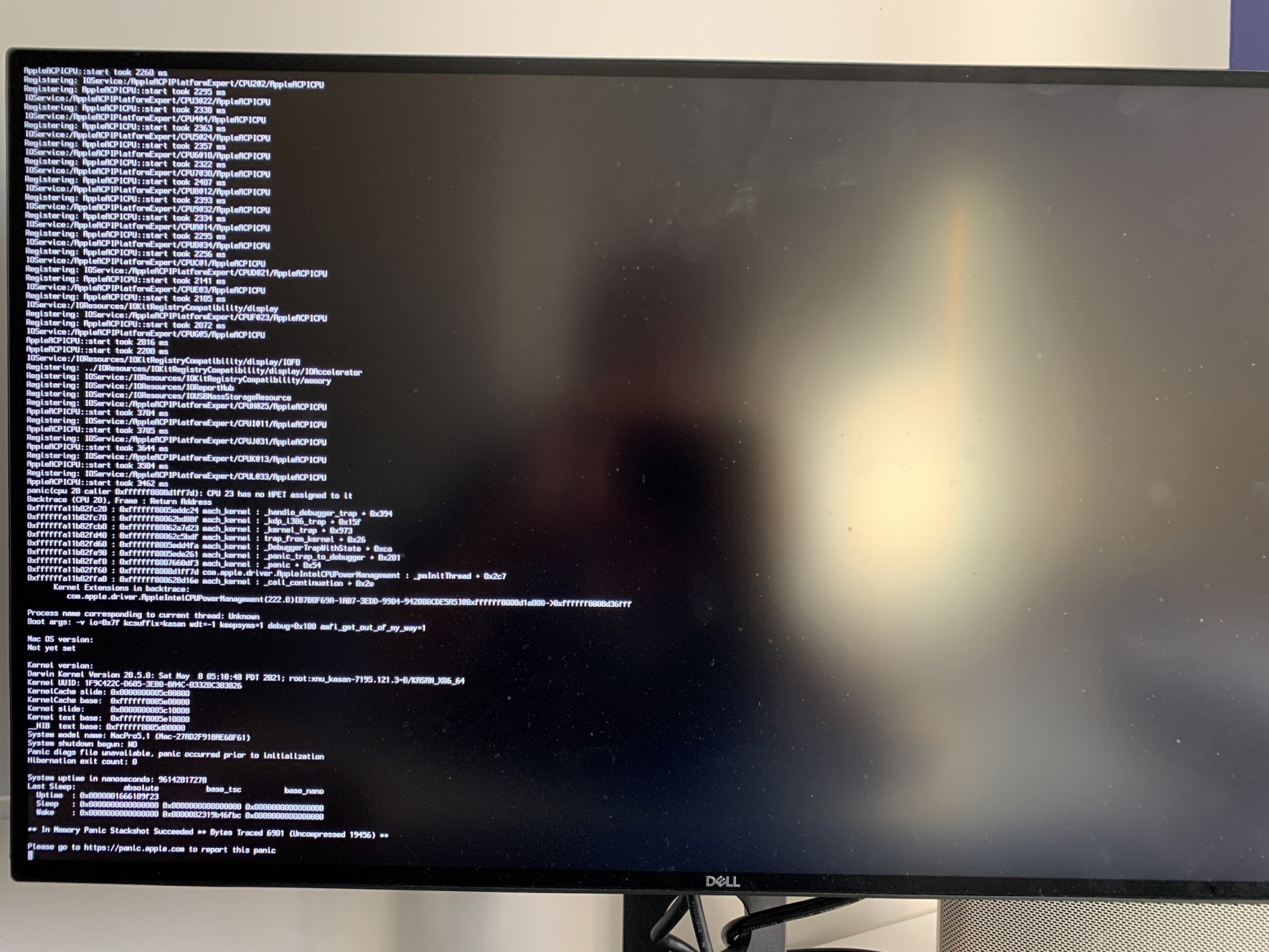

Ok so I started debugging the 12.0 Kernel following:
Unfortunately there is a syntax error in one of the files:

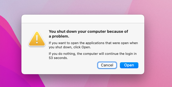

But strangely it does not hang on boot. Also I get the infamous
The added boot arguments are:
Code:
debug=0x8146 kdp_match_name=firewire fwdebug=0x40 pmuflags=1 -v
I am using the firewire port on the cMP and the thunderbolt 2 to firewire on my MBP11,3. Not sure which one of the boot arguments should I use but I tried both (the one on the top and added fwkdp=0x8000)
Still the syntax error prevents debugging.

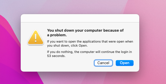

I know for sure that as long I get "You shut down your computer because of a problem" after boot it will not hang on boot. This is what previously happened to @TECK when he did not have issues with booting.

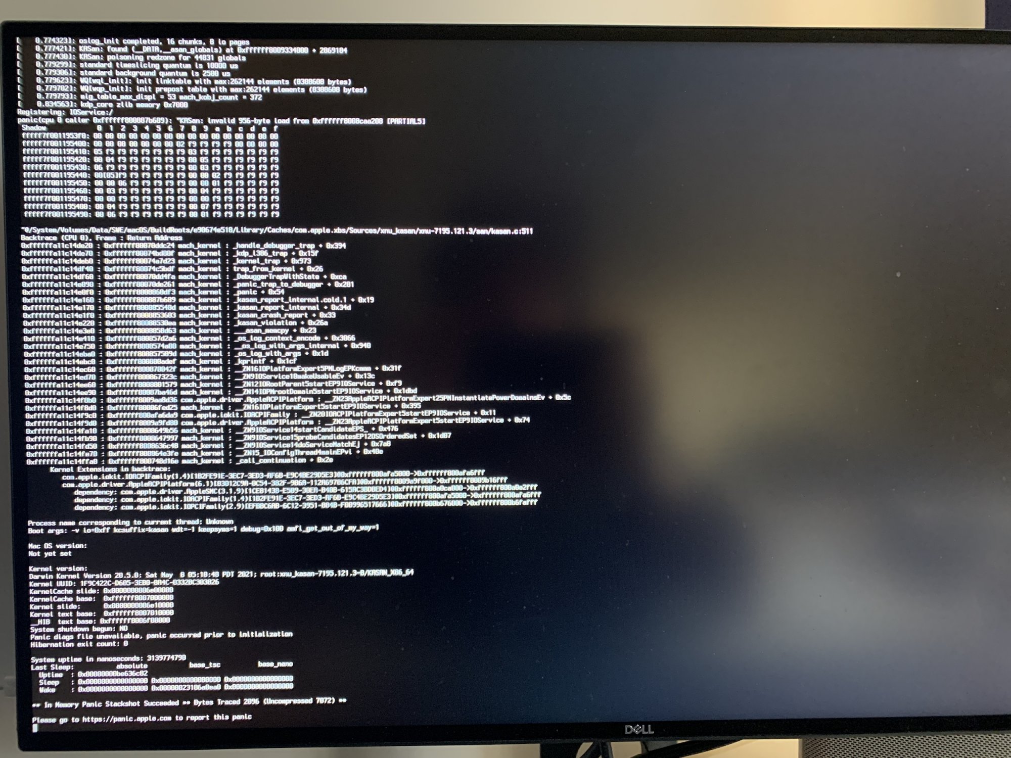

Isn't this precisely what we have all been waiting for? Or is this a different race condition?
Nope. We don't even need kext patching.
Has a method been discovered to cause the 11.3+boot process to consistently fail at the same spot on any Mac Pro 5,1? If this has been achieved, is it possible to further alter the boot process, even if it fails immediately somewhere else? On the other hand, if systems are halted in several unpredictable locations,
Wrong, it's fairly consistent.
wouldn't that be a symptom of the Xeon's predictive execution branching? If so, is there a way to force an Intel processor to run in a more linear way (i.e., without predictive branching)?
Nothing to do with the issue. All Intel processors are branch predictive since Pentium MMX.
