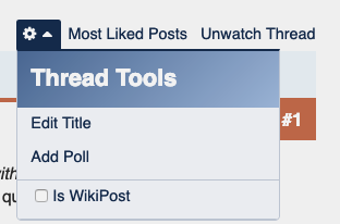

Glad to see things went well for you.
Now you should consider marking your thread as "RESOLVED" found under "Edit Title"
