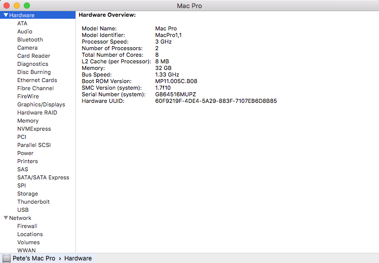

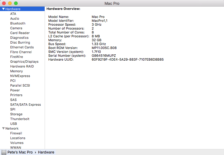

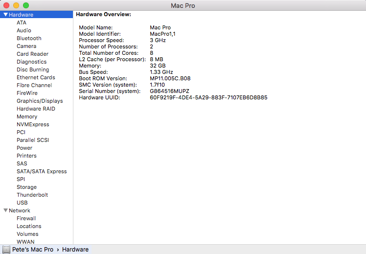

Long time reader first time poster, Thanks for all the information that everyone has posted but honestly I am lost and pretty confused, hardware not an issue machine is running with 2x 5365 3.0Ghz pretty
well see attached for configuration but Processors are not recognized and I just cannot get the 1,1 to update to 2,1 the RAM disk is being created but on restarting nothing changes.
I have tried several of the methods described and still not getting anywhere
Could one of you kind people please post a step by step for those of us who are maybe a little hard of thinking
Thanks in advance

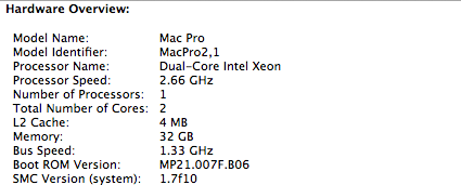

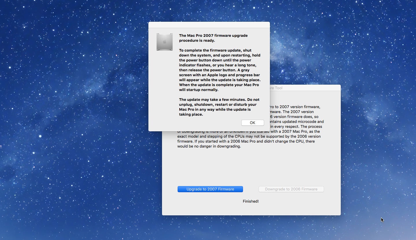

I am running 10.7.5. But I did manage to upgrade my 1,1 to a 2,1 some minutes ago. I will describe it here in case somebody else faces the same issues:

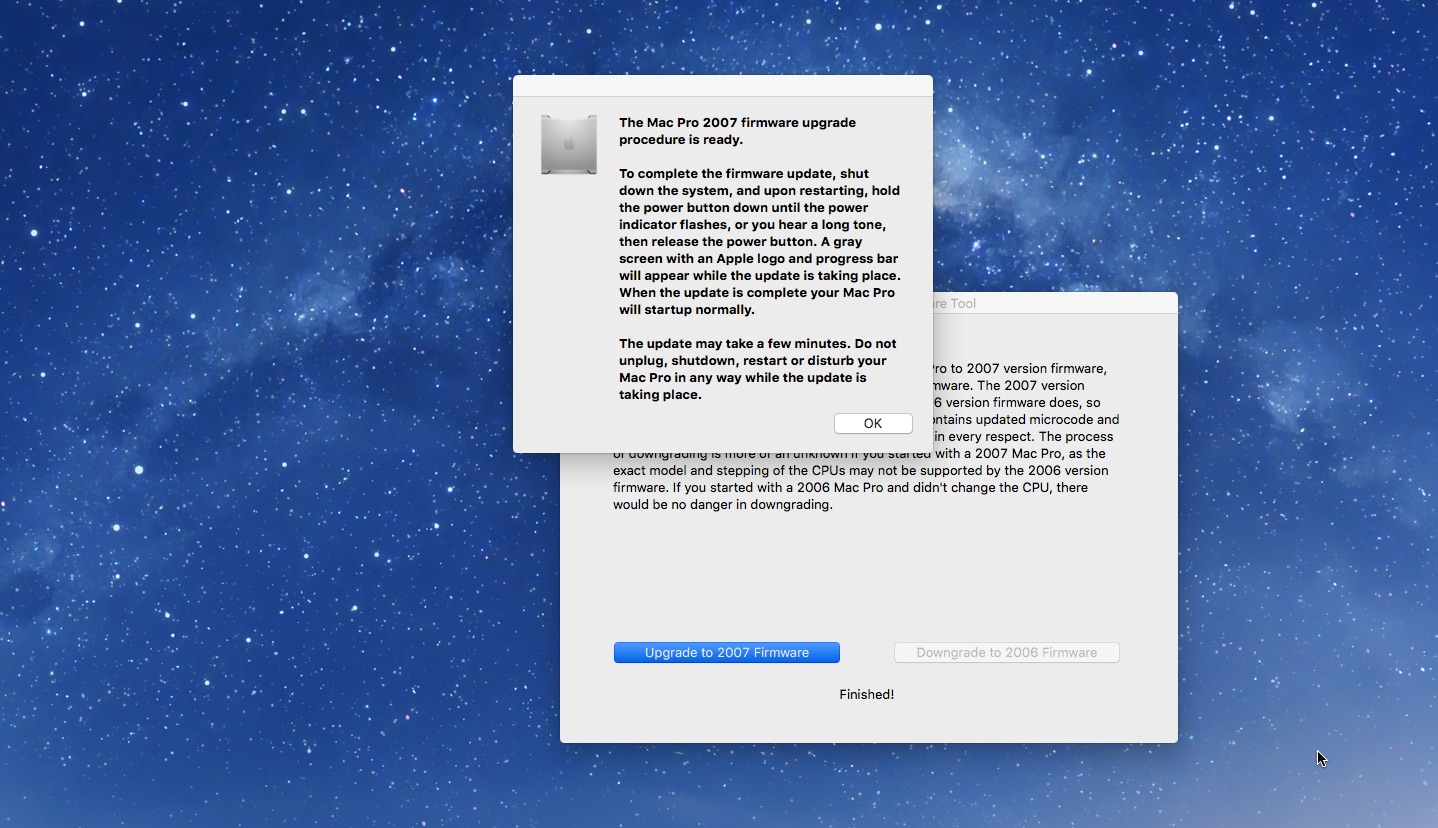

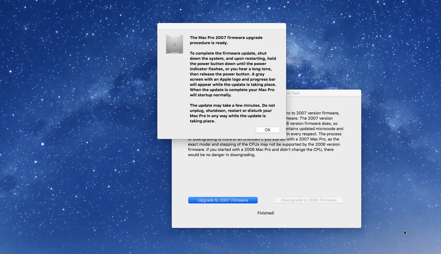

  1. Get the Upgrade tool vom netkas.org via Wayback Machine here as @jbarley suggested or get it from somebody directly like @ColEpsi - thanks!
  2. Download the Apple firmware update
  3. Mount the .dmg file
  4. Use the upgrade tool to create the RAM Disk which in my case directly failed after creating the RAM Disk with the error code 5530
  5. Have a look at the content of the upgrade tool and copy the following scripts from /Contents/Resources to the RAM Disk:
    1. ExtractAndPatchEFIFiles.sh
    2. UpgradeEFI2006-2007.sh
    3. DowngradeEFI2007-2006.sh
    4. MacProEFIUpdater2006.patch
    5. MacProEFIUpdater2007.patch
  6. Open ExtractAndPatchEFIFiles.sh with the editor of your choice
  7. Remove the following lines:
    1. Code:
      hdiutil attach -nobrowse MacProEFI2006and2007.dmg
    2. Code:
      rm -R Expanded
    3. Code:
      rm -R System
    4. Code:
      rm Payload
  8. Save the script
  9. Run it with
    Code:
    . /ExtractAndPatchEFIFiles.sh
  10. Run the actual upgrade script with sudo rights via
    Code:
    sudo /UpgradeEFI2006-2007.sh
  11. If everything runs trough without error proceed with the firmware upgrade:
    1. Shut down the Mac
    2. Press and hold the power button until it blinks
    3. Wait for the upgrade to finish

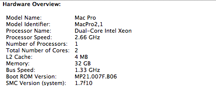

    4. Check the firmware version
    5. Reboot in case it does not detect your CPUs correctly until it does.
That did the trick for me.
Thanks again and cheers,
Robert
>>>UPDATE: 2020-04-22
(EDIT to Entry 11 above)
5. Instead of rebooting through the apple menu just hold down the power switch until it shuts down.
6. Then press and hold the power button until the light flashes and you hear the tone.
7. The dvd/cd trays will eject and you'll see at the apple logo and a loader.

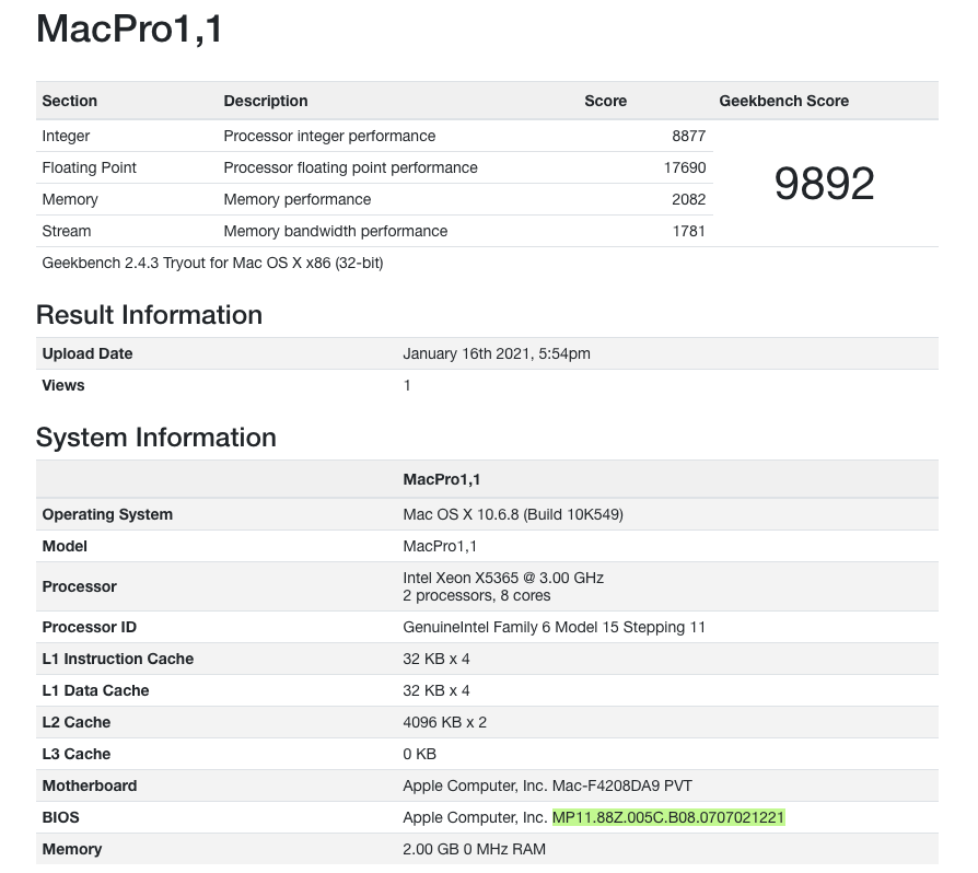

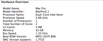

MP11.88Z.005C.B08.0707021221
My Mac Pro had the exact same boot rom. You need to manually modify the patch file with a hex editor:
  • Inside MacProEFIUpdater2006.patch there are 4 strings related to boot rom, look at the 2nd and 4th string, replace with yours. Don’t insert, don’t touch the 1st and 3rd.
So I tried this, it didn't work. And it isn't going to, there are issues.

10. If you upgraded your CPUs prior to upgrading to 2,1 you'll likely need to reboot until the CPUs are recognized in the 'about this Mac' directory. If upgrading CPUs after upgrading to the 2,1 firmware, it should recognize them right away.
11. Faster CPUs, e.g. 3.00ghz will necessitate you download and run the Mac Pro SMC Firmware Update 1.1 which contains the SMC firmware to regulate the new fan speed for Mac Pro 2,1 at the following link...
However, it may already have been installed years ago, as mine was. Check the Utilities folder. I ran/clicked it open again, and received an error message saying it was not necessary because it was already installed.

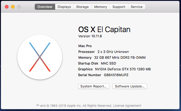

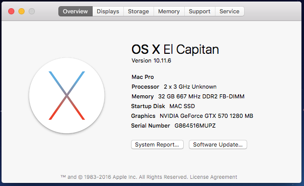

Not here, not on either of the 2 machine's I tried. 🙁
I have tried it in Leopard, in Snow Leopard and in Lion. The bios is MP11.005C.B08 on both machines, both have the genuine apple 7300GT graphics cards, and no other PCIe cards, I've tried a couple of different ram configurations, and I've tried flashing in safe mode, curiously, neither machine would boot into safe mode in Lion. HDD has been tried in slot 2 and slot 3, in case that's relevant to anyone.
When I tried just running the Firmware Tool it created the RAM disc successfully and then gave me the 5530 error.
Quite frankly I'm coming to the conclusion that despite a lot of people claiming otherwise, this cannot be done, not at home by an average DIYer.

Hey everyone, first time poster long time lurker. I have come to a standstill while trying to update my firmware on my 2006 MacPro 1,1 wit 2x 2.66 dual core processors, I just received my x5365s today and have been trying since the early morning to get this going. I was attempting to run the firmware updater through 10.11 with no luck and then swapped over to my 10.7.5 install which is where I have tried to use all the work arounds I have come across. I have tried downloading the Apple FW updater, loading that while trying to run the 1,1 to 2,1 updater, have entered all of the correct commands in terminal and it seems all of the correct files are created. I kept seeing a "Locked" file that pertains to my current bios once the . /Volumes/RamDisk/ExtractAndPatchEFIFiles.sh has been run. I started snooping around in the ".patch" file and noticed that my bios build didn't exist anywhere. I tried adding it in and replacing all of the Mp11 files with only mine with still no luck. I also found in the upgrade.sh file that it says firmware2="LOCKED_MP11_005C_08B.fd".
My bios build is:MP11.88Z.005C.B08.0707021221
Specs:
Model Name: Mac Pro
Model Identifier: MacPro1,1
Processor Name: Dual-Core Intel Xeon
Processor Speed: 2.66 GHz
Number of Processors: 2
Total Number of Cores: 4
L2 Cache (per Processor): 4 MB
Memory: 32 GB (normally 6dgb)
Bus Speed: 1.33 GHz
Boot ROM Version: MP11.005C.B08
SMC Version (system): 1.7f10
Serial Number (system): G87164PMUQ2
Hardware UUID: 00000000-0000-1000-8000-0017F2092764
Things that I have tried as to not interfere with the install
Remove Nvida geforce 8800
revert to stock Nvidia geforce 7300
remove ram down to 32gb
remove all other internal drives
remove all external drives
remove rEFIt

MacPro 1.1 upgrade shows successful as shown on screenshot,after shutdown hold power button shows blinking it not shows any firmware upgrade ,please advice for the reason of not upgrade,am try with minimum ram also same.

I finally got it, had to install 10.6 onto an old drive and follow the directions post by MacCandy on page 2 of this thread. Thanks for sharing your process everyone!
Actually this did the trick. I updated to 10.6.8 completly and then the old Netkas trick worked for me. I followed the Mccandy post but the netkas app didn’t crash. I restarted after firmware update because i saw only 1 proc. And boom!
Took me around 10 minutes or so after 10.6.8 was done Installing. Super easy!

I'm back to 1,1. El Capitan didn't like my memory (i think) and constant restarted. And because i though maybe the 2,1 was causing it i revert back to 1,1 (Don't have new memory and 2,1 cpu's so 2,1 was not really needed) But new memory is on it's way. As is new cpu's. So yes SMC is also the next thing if everything works fine.
Small update: back to 2.1 because the new memory came in. And it works and I could run El Capitan. Also flashed a better then my 7300 gt pc video card. I was soooo happy when i saw the boot screen but next day: green scrambled image. Killed my mood that day.

I've been wrestling with this FW update for several days now and feel as though I've exhausted all possible solutions offered in this thread and on Netkas' thread Here. I'm having the same issue that Bidzer on p. 34 post #3 describes. After successfully running the firmware tool, (I don't get either a 5350 or 5370 error) I reboot, hold down the power button and enter the firmware screen. Then it appears for a flash but quits and the computer reboots again back into MacOS. Following Bidzer's suggestion, followed Hrutkay Mod's Video and successfully updated the SMC version to 1.15f3.
Next, I ran through the steps posted by MacCandy on page 2 of this thread at least a dozen times.
I'm able to edit the shell script, although I have never been prompted to "unlock" the file. The terminal commands all complete without any unusual errors, but upon reboot and entering the firmware updater, I have the same issue where it quits right away.
I'm running a Mac Pro 1,1 with two upgraded quad-core Xeon 5365 CPUs, two original 1GB sticks of RAM, original Geforce 8800 GT video card, OS X 10.6.8, Boot ROM MP11.005C.B08. All internal drives and PCI cards have been removed, and I've tried resetting PRAM and SMC with no luck. I'm banging my head against a wall here. Anyone have any ideas here? Any help is much appreciated.
Thanks
