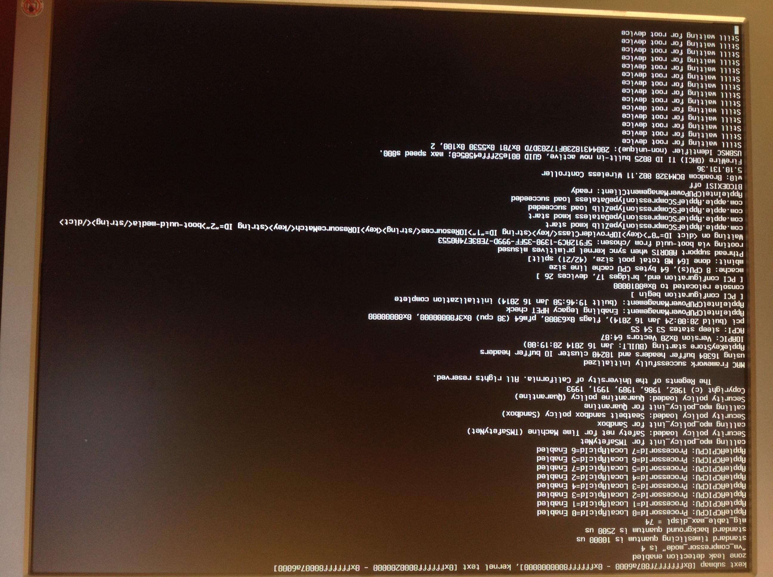

Still Waiting for root device
I followed the directions (twice) and when I try to boot from the usb drive I get to the USBMSC identifier.....
then
Still waiting for root device
so obviously I am doing something wrong...
any idea on what?
thanks

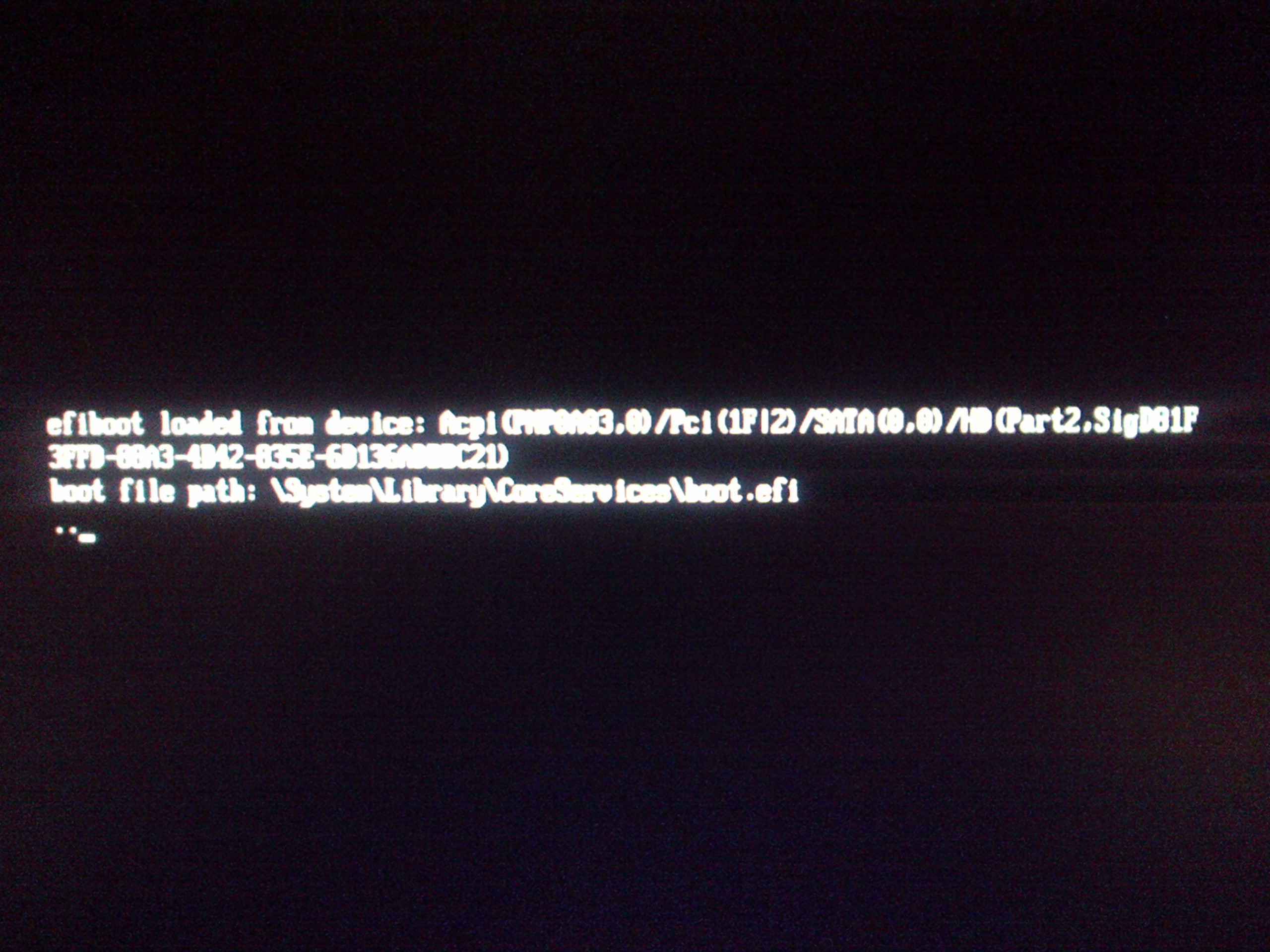

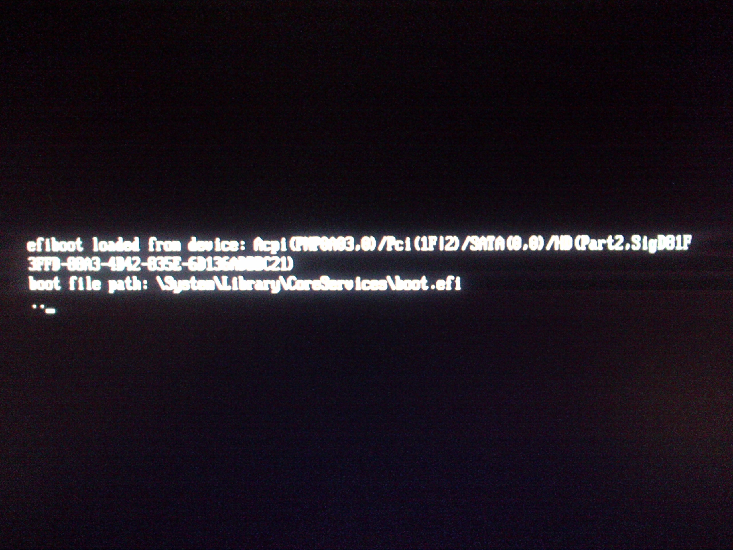

I have also tried creating a install flash boot dive using the SOFTT 64x32 method, however that failed to create a drive, though I will persevere to see if can get it to wok for me.
I have also tried installing both variants of TIAMO boot.efi, the second boot.efi edit date 25 November 2013 time 08:25 does not move past the options screen, when I choose the flash drive install option the screen just hangs.
The first original release edit date 23 November 2013 time 01:14 appears to get me the furthest before the process locks up, the following dialog is displayed:
efiboot loaded from device: Acpi(PNP0A03,0)/Pci(1F|2)/SATA(0,0)HD(Part2,SigD81F3FFD-88A3-4B42-835E-6D136ADBBC21)
boot file path: \System\Library\CoreServices\boot.efi
.._
So to summarise my aim:
1] I need to install 10.8 or 10.9 to run Logic X and Universal Audio Apollo UAD-7.5
2] My hardware is: MP2.1, 3.0MHz 8-core, 16-Gig Mem, 2x 7300GT cards driving three displays
3] I have created an install boot flash drive as guided by tips-and-tricks from the InstallESD.dmg and copying the Packages folder to flash drive
3] I have downloaded and tried both variants of Tiamo boot.efi and replaced those in CoreServices and i386
4] I have inserted board id to OSinstall.mpkg both ways, one with Zack edits and one without
5] I have inserted board id into Installable Machine Property List
6] I have also tried both ways, one deleting kernelcache and one leaving it as is
Any further guidance would be very much appreciated
Thanks in advance
Regards
Paul

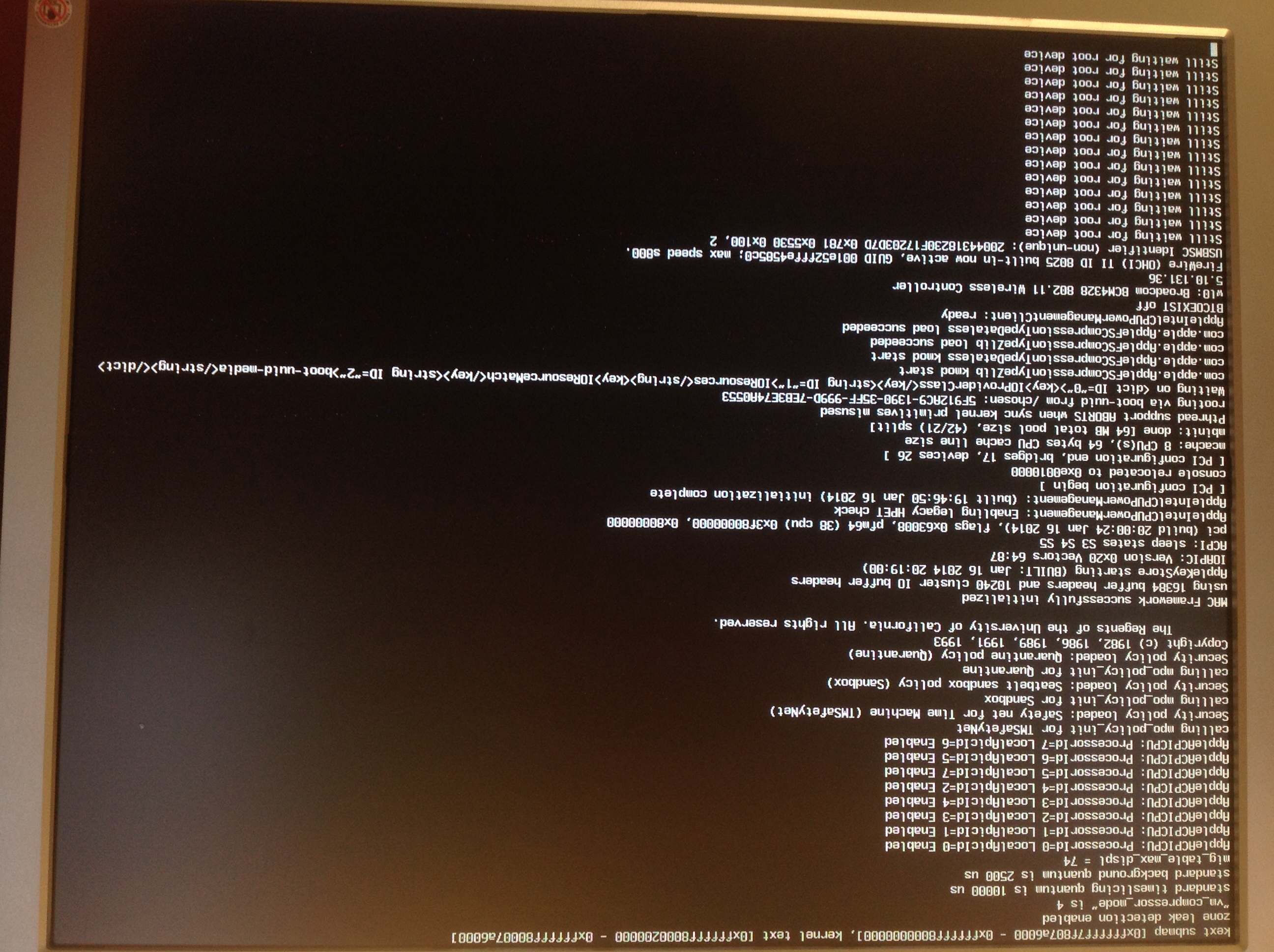

Same Problem
then
any idea on what?
thanks
I am getting this exact same problem.

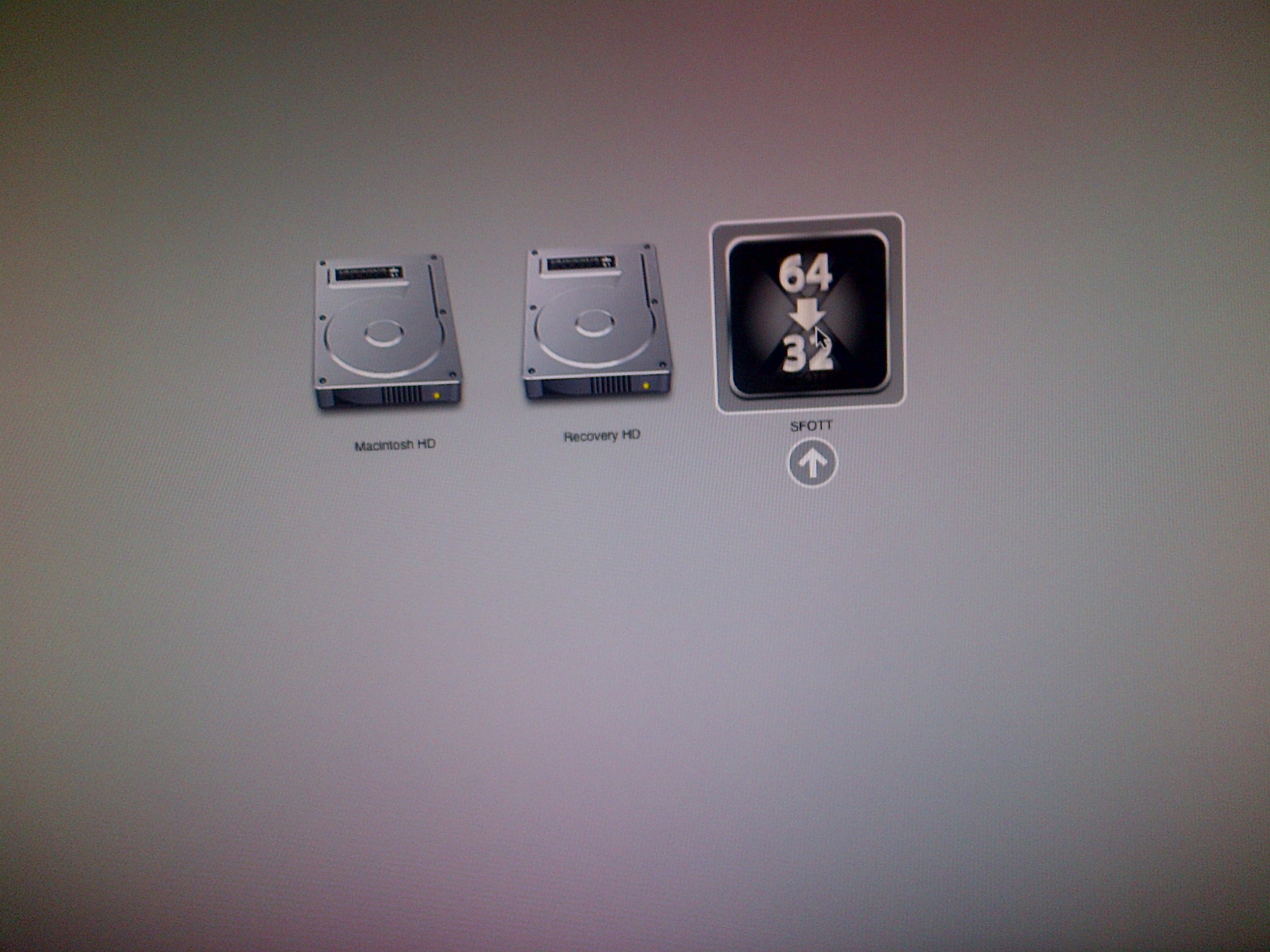

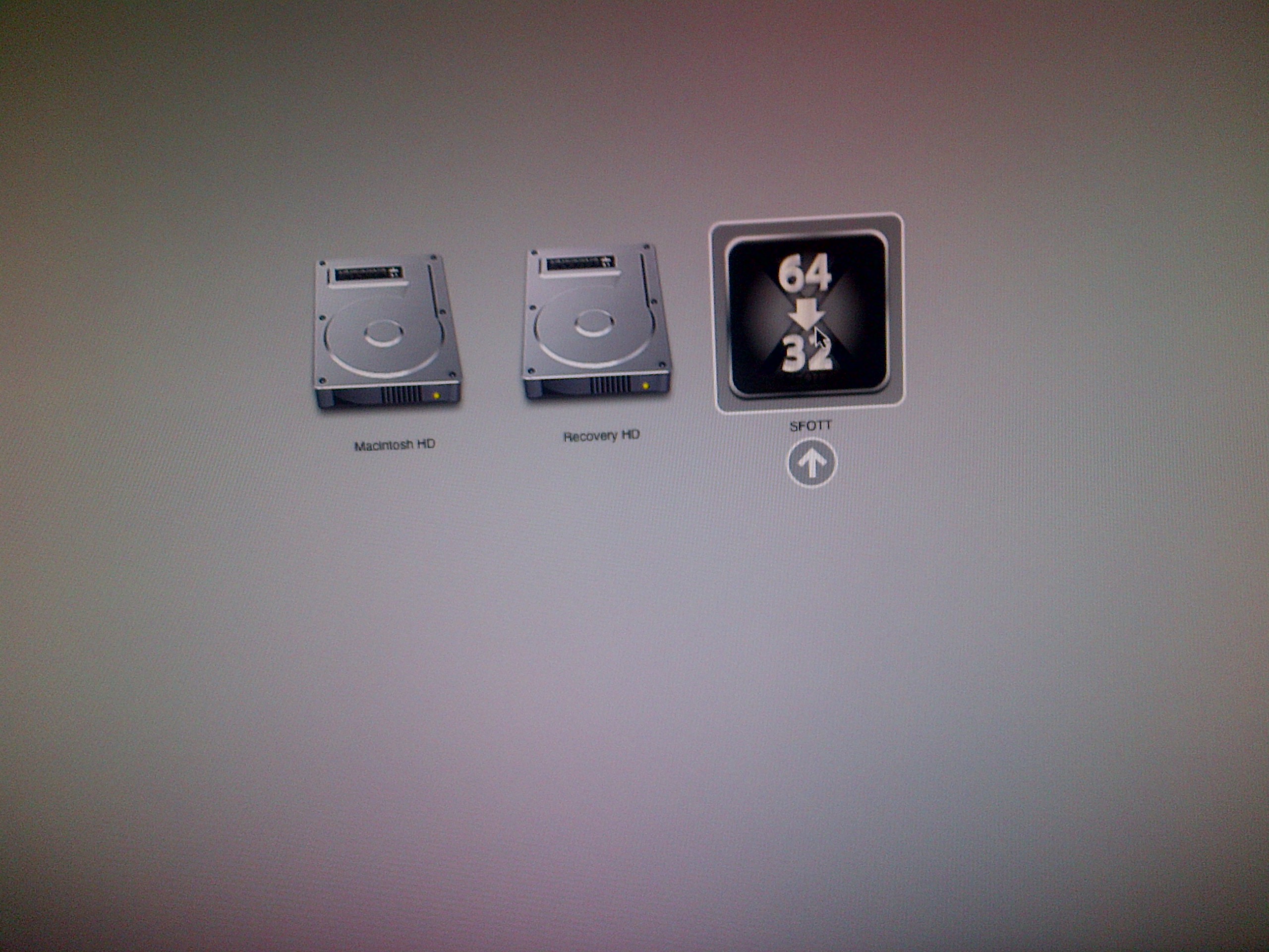

Hi Paul, This ^^^.
I note on your profile there is an MBP if you installed Mavericks on a 3.5" disk in an external enclosure attached to this, and swapped in the Tiamo boot.efi, and whence done, stuck the drive into your MP, it should work fine - it's one of the many methods that I've tested and found to work.
That aside for a moment…
In your attached image of the boatloader with the three disks shown - select the extreme righthand one with the custom 64on32 icon.
-Rob
