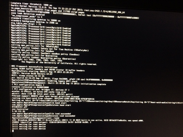

I followed the instructions by tiamo to the letter, I reboot to my usb and get this:
Any advice on how to actually start/finish would be greatly appreciated.
I'm doing this on a Mac Pro 1,1 flashed to 2,1, 16gb ram and Apple 5770.

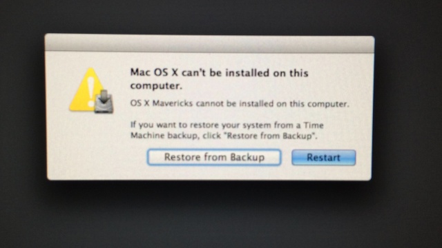

I solved my problem I had yesterday, but now when I get to the install screen I am met by this:
I followed all directions and I'm met with that message box.
