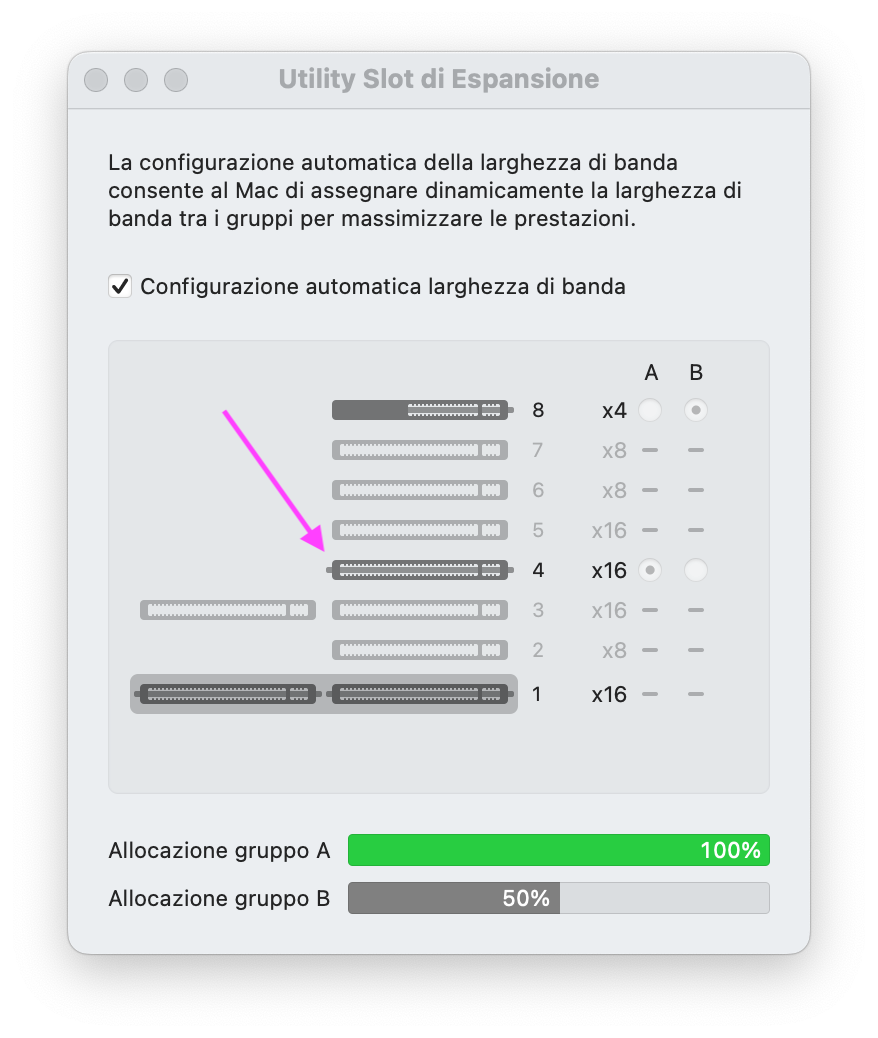

I'm using the Sonnet M.2 4x4 PCIe Card (Silent). As you can see in the screenshot, it is positioned in Slot 4, allocating x16, A option and Automatic allocation of bandwith switched on.
  1. Disk used: Samsung SSD 2TB 980 Pro M2, Samsung 1TB same model
  2. Disk format: RAID 0, done by Disk Utility, the disk is used for stuff storage, not to boot MacOS.
  3. Options: FileVault off, other slots are empty on the machine
No problem at all after updating Sonoma. Hours switched on, switched off, put in sleep, awake... the drive remains active and functional.
AFAIK Slot 4 is fed by the unswitched PCI lanes that are allocated to the MPX slots, which might make a difference. It would be an interesting control to relocate the card to slot 5 and see if it remains as stable.
Prior to updating Sonoma, the pci slot #5 is where the card gave me the problem of random and recursive hd disconnection. During tests, I moved the sonnet card on slot #4. Updating Sonoma now everything is ok, so I’m just a little bit scared about moving it!
If the problem is related to the PCI Switch, it would be a good diagnostic test.
So far so good with my Samsung 970 Evo Pluses in place of the Crucial P5 Pluses (which also seem happy enough relegated to USB-C caddies).
Apologies if I'm talking at cross purposes, but @nopster's screenshot indicates that slot 4 is switchable between pool A and pool B when it isn't being dedicated to MPX.
Reactions: nopster
You're right, my mistake. I had it in mind that all the slots within the two MPX bays were from the unswitched source, but it's only slots 1 & 3 that aren't switched.
Reactions: nopster
