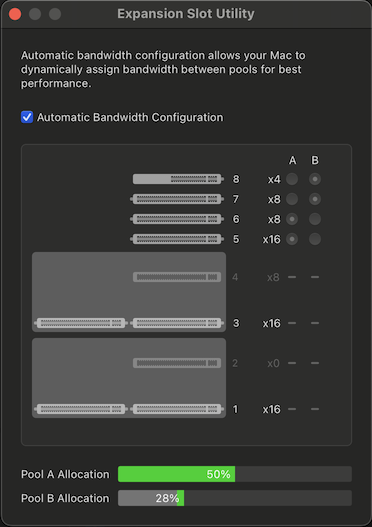

I tried moving my 1M2 cards to slots 5 and 6, and my USB expansion card to slot 7. It's had a slightly curious effect on the bandwidth allocation information reported at the bottom of the expansion slot utility, but hasn't helped with the mounting problem (i.e. it still recurs at a similar frequency).

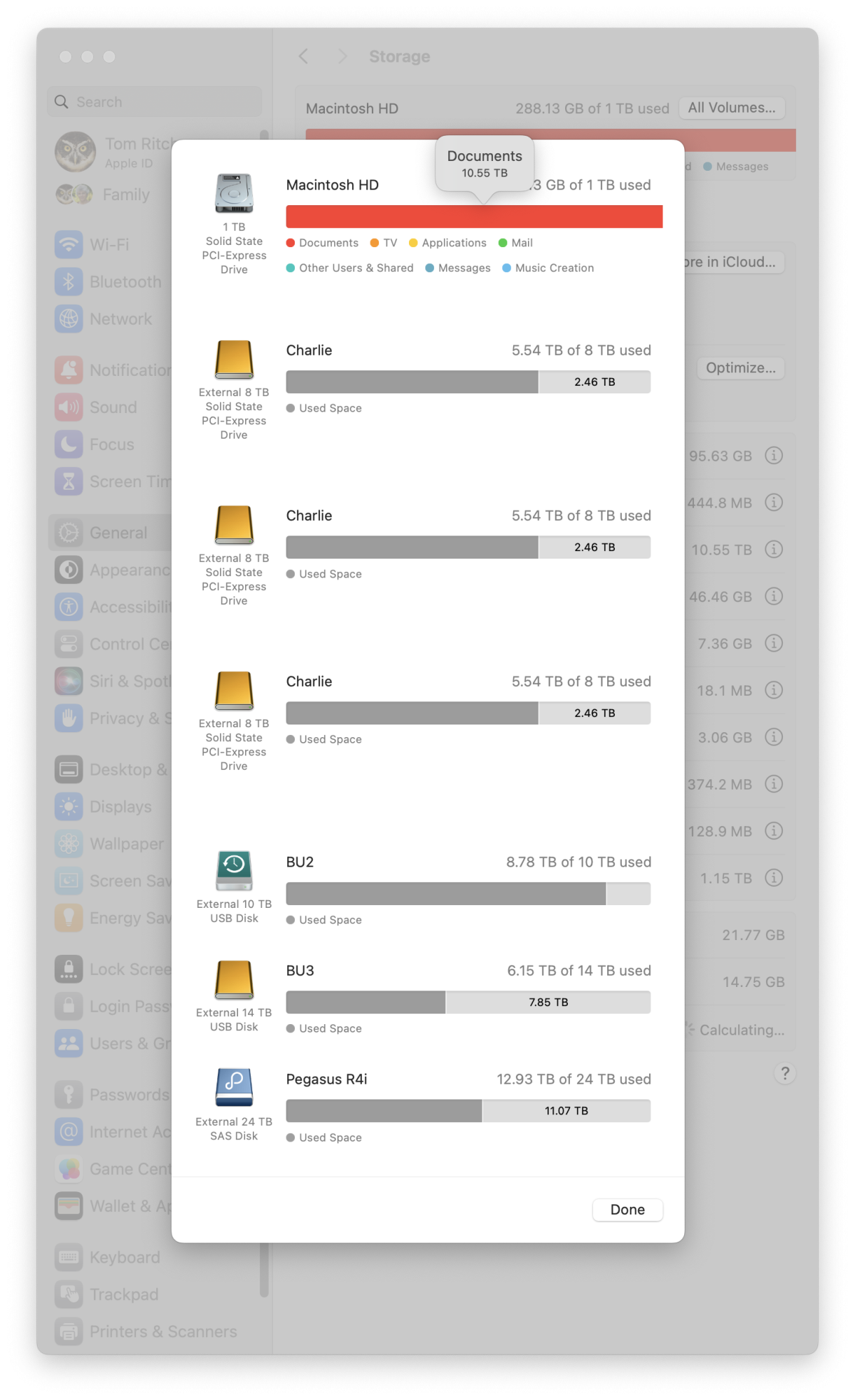

I have a MacPro7,1 (2019) with four Samsung 970 EVO Plus 2TB cards mounted on a Sonnet M.2 4x4 Silent PCIe Card. The cards are running in an Apple software RAID array. I also have the standard Pegasus hardware array. My User folders are relocated to the Pegasus array. As many others have observed, sometimes one or more of the SSDs on the PCIe card do not mount. I have a couple of observations to offer.
When the PCIe system does not load, I shut down my computer. After a minute or two I start it up. When started like this, so far the PCIe SSDs always load and mount as expected. However, if the PCIe system is not working and I do a Restart, the PCIe stuff continues to not work. Looks to me like when started from completely shut down, the PCIe cards work properly.
My second observation is that the system tools Apple supplies to observe how disk memory is allocated show a major problem. Have a look at System Settings / General / Storage Settings. The bar at the top shows memory allocation on the Startup Disk. A note across the top says, in my case, my system takes 288.71 GB of the 1 TB SSD. Under the bar is a key showing color assignments indicating particular uses of disk space, Strangely, the whole bar is red. Clicking the button above the bar shows space allocation on All Volumes. This displays one problem. My PCIe-mounted RAID array, "Charlie", is shown three times. Hovering my pointer above the bar shows another problem. The Settings dialog claims my Documents folder takes 10.55 TB of the 1 TB available on the Startup SSD.
It seems system software does not work properly with memory on PCIe cards, or on the RAID array Apple sells. This suggests the problems we observe are due to faulty system software. This easily observed glaring error tends to verify the lack of quality control in Apple's system software development.
Can anyone reproduce these results?
It seems system software does not work properly with memory on PCIe cards, or on the RAID array Apple sells. This suggests the problems we observe are due to faulty system software. This easily pbserved glaring error tends to verify the lack of quality control in Apple's system software development.
Mine doesn't appear like that, it shows a fan of different colours for different file types. The red one corresponds to 'documents' as yours shows above, but only for the literal drive. Yours appears to be aliasing other drives since your 1TB drive has 10TB of documents....
