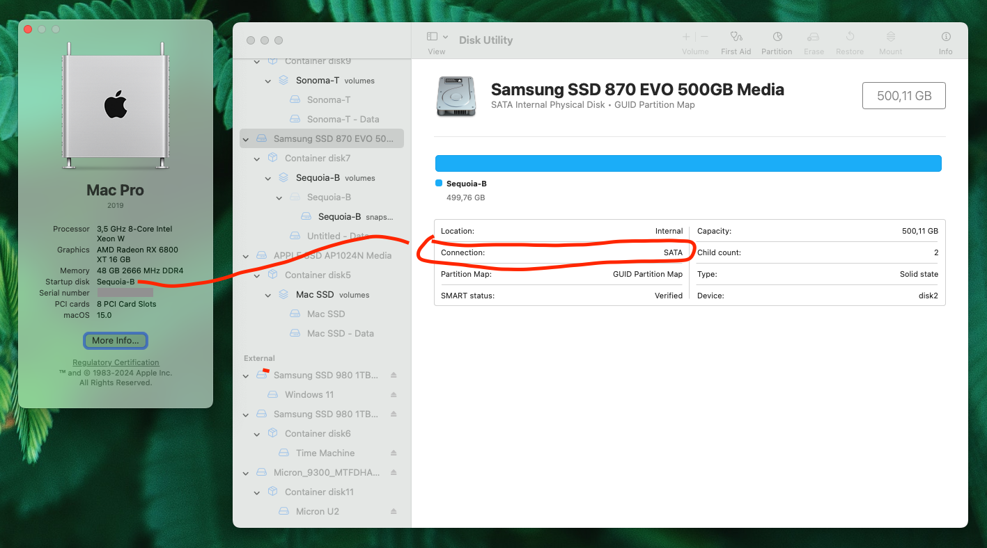

Correct, only to NVMe drives mounted to PCIe cards for multiple NVMes with PCIe switch chips onboard since the Mac Pro does not support PCIe Bifurcation. USB and SATA ports are fine, even the 3rd party PCIe SATA controller cards.
Anyway it will soon be 2 months without sinle mount issue on Sequoia since Beta 1 relased on 30th of May.

Zero cards thar require Bifurcation work with Mac Pro because the machine itself does not support it. Only the first drive will be recognized from those cards. Thats why Mac Pro requires cards with PEX PCIe switch so that it will do the "Bifurcation" role and comminicate between PCIe bus and all NVMe drives separately.
My guess is that most of the problems are due to misscommunication between MP PCIe bus and the card with those chips.
Sure, there are RAID cards which don't use PCIe switch, but those are MUCH more expensive than OWC or Sonnet, but must users in this thread have OWC/Sonnet combination or HighPont with PCIe switch.
