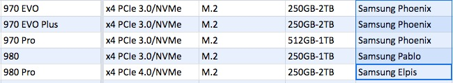

This is a new Generation of the Samsung NVME Series and i am not sure about the Controller they use in this one, so you can have luck and it has not the Problems of the phoenix Controller.
The Problem relates to the Phoenix Controller in combination with the APFS File System ( HFS has no Probs)

There are more Controller on Samsung drives with Problems since MacOS 12 Monterey ( PM981 Panic was also before and persists ) I have only WD SN 570/770/850 Drives and they all work as they should.

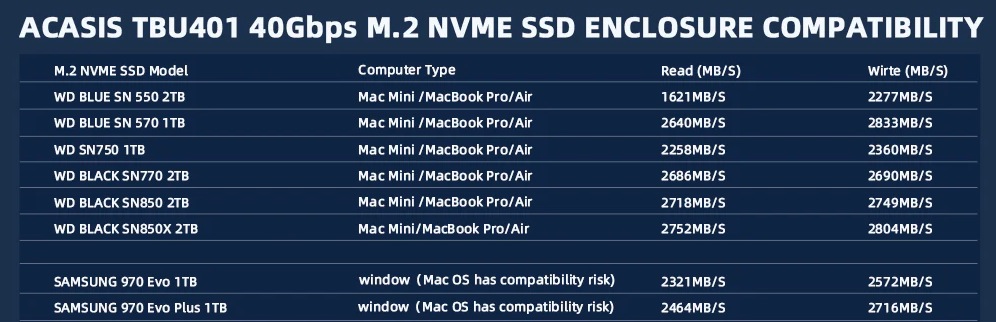

Acasis, who makes Mac compatible NVMe enclosures, warns their customers about using Samsung 970 EVO (Plus) drives with their product. Note that the WD SN570, SN770 and SN850(X) perform the very best of any drives.

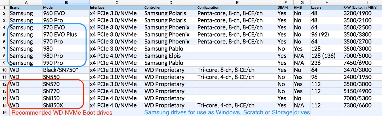

2. Choose a WD Blue or Black NVMe SSD

3. Choosing a Specific WD NVMe Drive
The WD drives are all fast at reading data. About 2900+ MB/s read speeds. The write speeds will vary greatly. The larger capacity drives will all offer faster write speeds than the smaller 250GB versions. Since prices have gotten so low in 2023, no one should be buying a 250GB NVMe for use as a boot drive. Spend a few dollars more and get the 500GB version if you have a limited build budget. Most people should be opting for the 1TB capacity drive.
Another consideration. Does the drive have a DRAM cache ? The SN850 and SN850X do. The other drives listed above do not. If you use your hackintosh for professional video or photo editing, if you use programs such as Logic Pro, you definitely want to buy the WD SN850X because of it's dedicated DRAM cache.

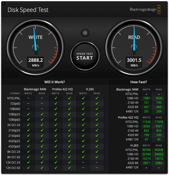

4. What about the WD Blue SN570 ?
This drive is the lowest price per GB of any of the recommended WD drives. It is PCIe Gen 3 and comes in sizes up to 2 TB. If you have an older PCIe 3.0 motherboard (Intel 10th gen or older) and need a large 1-2 TB boot drive, this is a great lower cost choice. With a 500GB SN570 selling for $33 there's no good reason to opt for a Sata based SSD as your macOS boot drive. Everyone with a relatively new M.2 motherboard can afford this.

In Summary: These are the WD Black (Gen 4) and Blue drives to choose from. Ranked from fastest to slowest in overall performance. All of them utilize SanDisk NAND Flash and are fully macOS Monterey and Ventura compatible.
  1. WD Black SN850X (Highest rated performance and endurance)
  2. WD Black SN770 (DRAM less drive that uses HMB)
  3. WD Black SN850 (Older version of the SN850X)
  4. WD Blue SN570 (PCIe Gen 3)

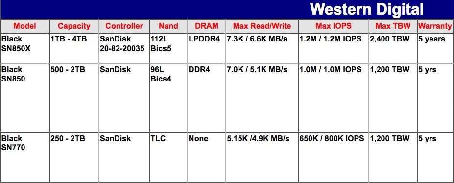

Here's an easy to read chart that compares the top 3 WD Black Drives. The SN770 does tend to perform better than the SN850 in the PC Mark suite of SSD tests even though the numbers from the manufacturer say otherwise.
Same with last year's purchase of an NVMe Acasis case.
The seller assured about compatibility with the 970 EVO PLUS, that they conducted tests with these drives on MBP and everything works fine.
I bought it, the read/write speed in macOS and Windows is 1/3 of the declared disk speed.
An engineer was sent to check. He said that this was the first time I tested Acasis with a MacPro, it was strange that the speed was low, and he advised me to buy a drive from WD.
Again, call me a skeptic, but maybe the problem is Acasis' hardware, not Samsung's - like the way Sonnet claim NVME isn't supported on a 7,1 Mac Pro with any OS later than Monterey, because their cards have issues?

I wrote about Acasis for information so that MP owners do not buy it for the 970 EVO PLUS.
Of course, you are right that the problem may be with the Acasis hardware. I didn't experiment anymore and didn't buy a WD drive.
