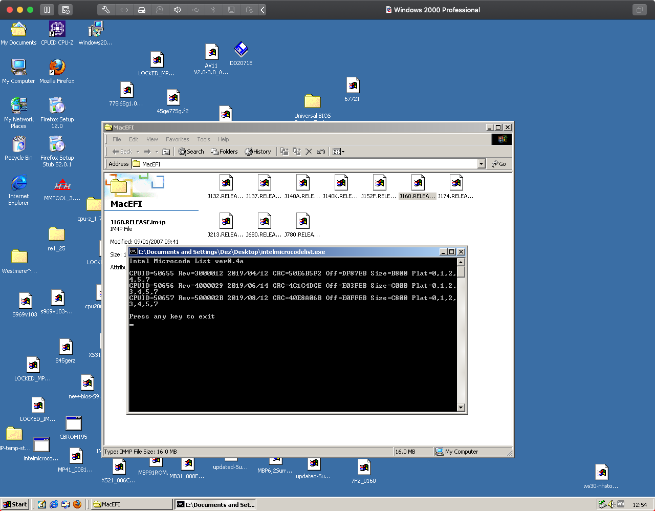

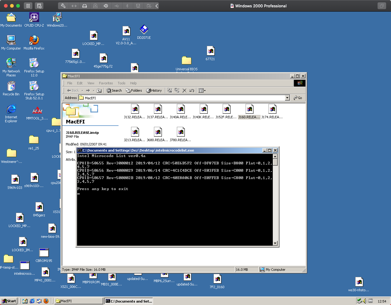

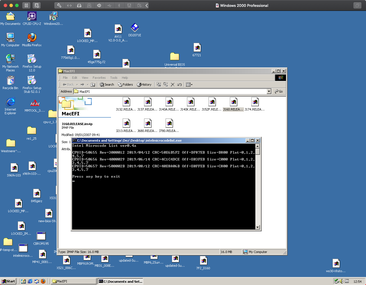

did a bit of digging, as I suspected the MacPro7,1 only contains cascade lake microcodes in its firmware
a good indication of CPU support, but sadly I dont think any skylake CPUs will work (I know a couple people wanted to try the W-3175X but I dont think that will wrok)
(but it is worth noting that skylake and cascade lake share the same Major CPUID only differing on the stepping side of things, so there's a small chance skylake will still work but id not bank on it)
there are some cascade lake ES steppings micro codes in there (50655 and 50656 are ES steppings, with 50657 being the production/QS stepping)
theres actually a GB result of I think a Prototype MacPro7,1 because its a CPU that did not end up shipping in the MP7,1, but its also a ES stepping
