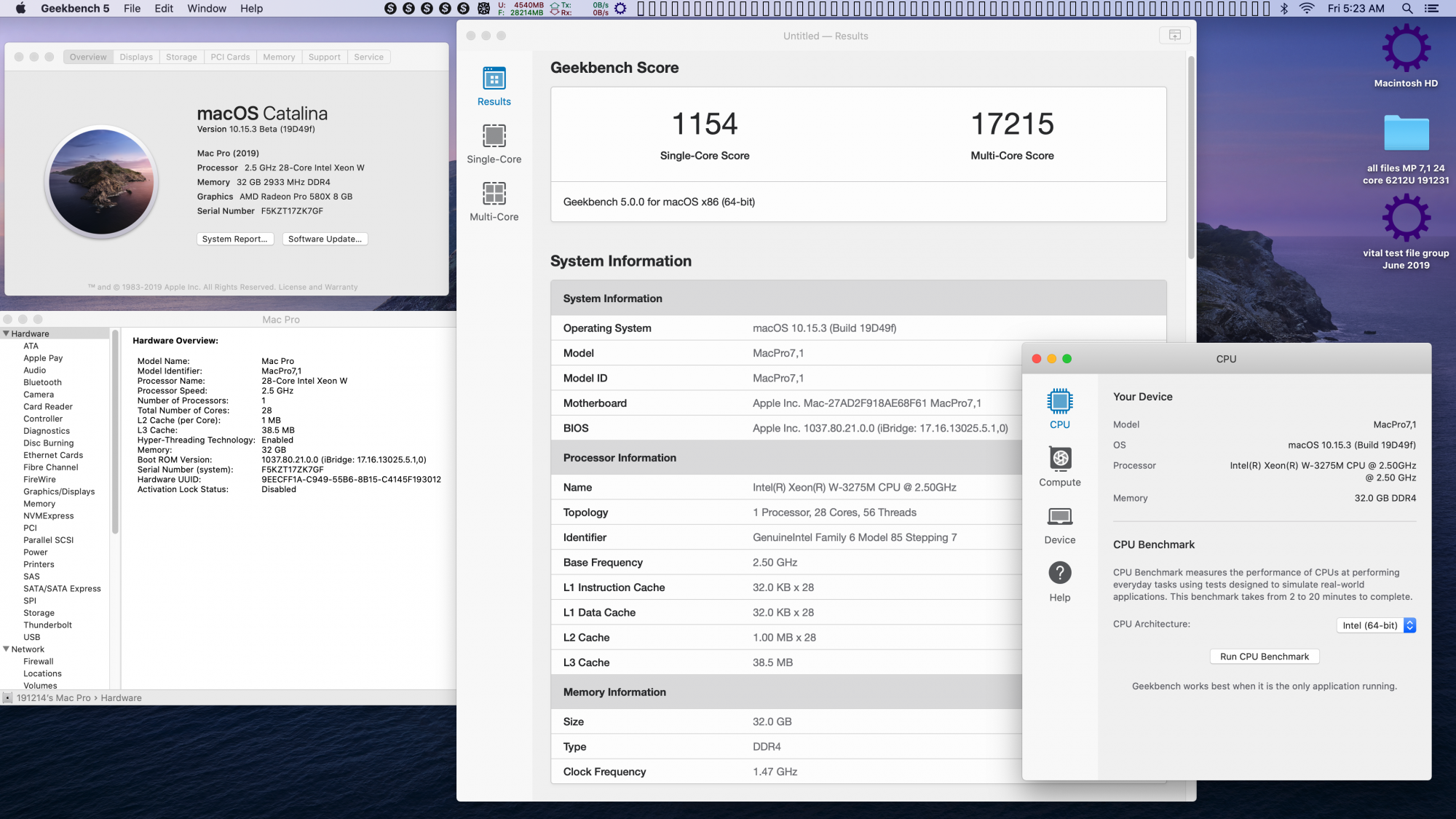

Just upgraded the stock 32GB ( 4 x 8GB ) memory configuration to an aftermarket 96GB ( 6 x 16GB ) in order to activate six channel memory and my processor upgraded 28 Core System performance went through the roof . I finally have a respectable GB5 multicore score . It's actually at the top of the class .
The upgrade modules are Crucial model MTA18ASF2G72PDZ-2G9 .
With the upgraded 96GB ( 6 x 16 GB ) memory :
With the factory 32GB ( 4 x 8 GB ) memory :
There's over a 20 percent improvement in System performance now . Everything else being the same .

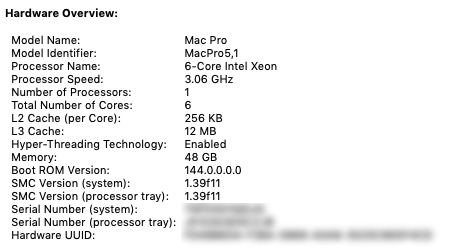

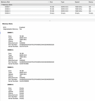

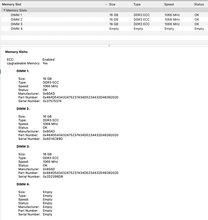

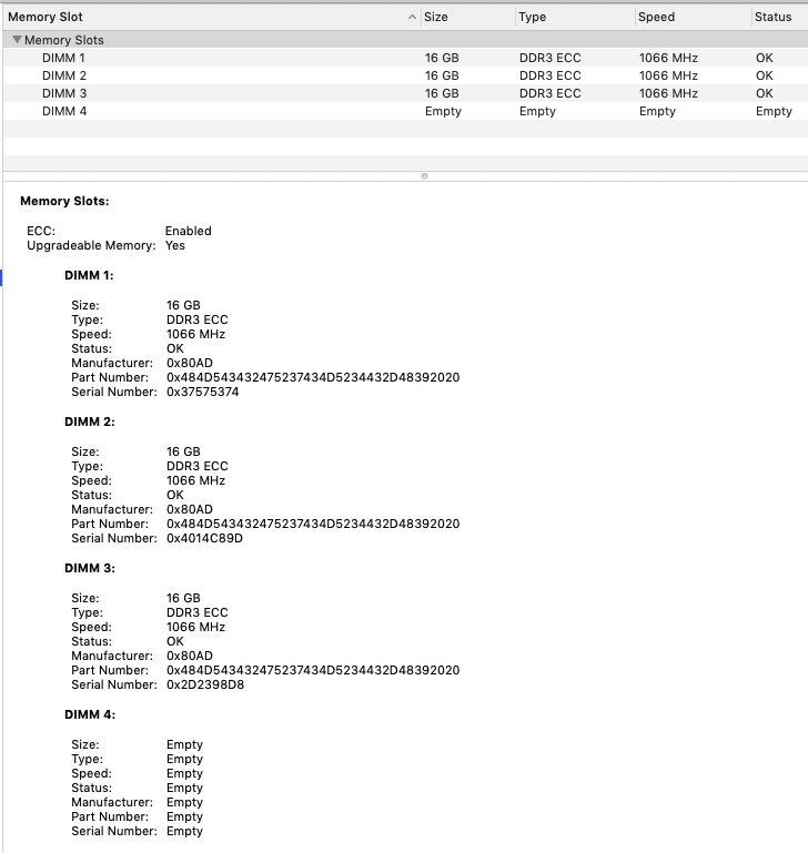

Wow - epic thread - thanks to ActionableMango ! - ... I have owned the base model 2010 5,1 single CPU for 10 years and decided based on the above to "spec it up a little". I chose the X5675 Westmere for it's potential to run 6 cores, 3.06Ghz and 48Gb (3x16)1333Mhz memory and its very low 95W power and heat off-grid reasons - have installed the new CPU fine and runs 20°C cooler than the old W3530 cpu. My Geekbench went up nicely - thanks ! All PCIe slots are full USB3/SSD/NVMe/AMD7970
One issue I cannot solve - is that my new memory chips (Hynix 4Rx4 PC3-10600R-9-12-F0 - Part number
100-562-456) don't want run at 1333Mhz (even after NVRAM reset) but seem only at run (in first three slots) 48Gb @ 1066Mhz? 🙁
I am not sure why? I actually ordered the R memory chips 3x16GB 4Rx4 PC3 -10600R-9-10-F0 1333Mhz but received slightly different Hynix ones 16GB 4Rx4 PC3-10600R-9-12-F0 P/N 100-562-456 - and wondering if these are the cause of my problem and if they really are 1333Hz? or if anybody else has ever tried this combo of the X5675 Westmere with 10600R memory chips?
another factoid - I have a spare 16Gb chip and when I install 4 x 16Gb of these (all slot full) my Mojave 10.14.6 memory speed drops to 800Mhz ? but if I have 2 or three slots occupied my Mojave will only run at5 1066Mhz?
You bought 4Rx4 memory, that's the problem. Westmere Xeons with MP5,1 need 2R4 2Rx4 to work correctly at 1333MHz. Quad rank memory most times don't work or work at reduced speeds.
I'm surprised he was able to get three Quad rank memory modules working in the same bank . The total number of rank positions should not have exceed 8 per bank .
The maximum number of quad rank modules I have ever been able to get recognized is two , per bank , in the MP5,1 .
Theres per channel and per bank limits, and it does work, just at reduced speeds. I have one machine with 96GB as 6x16GB quad rank modules and they run fine at 1066.
if i populate the 4th slots as well with an additional quad rank module it still runs but at 800 as the 3rd and 4th (and 7th and 8th) slots are in the same channel so it clocks down.
