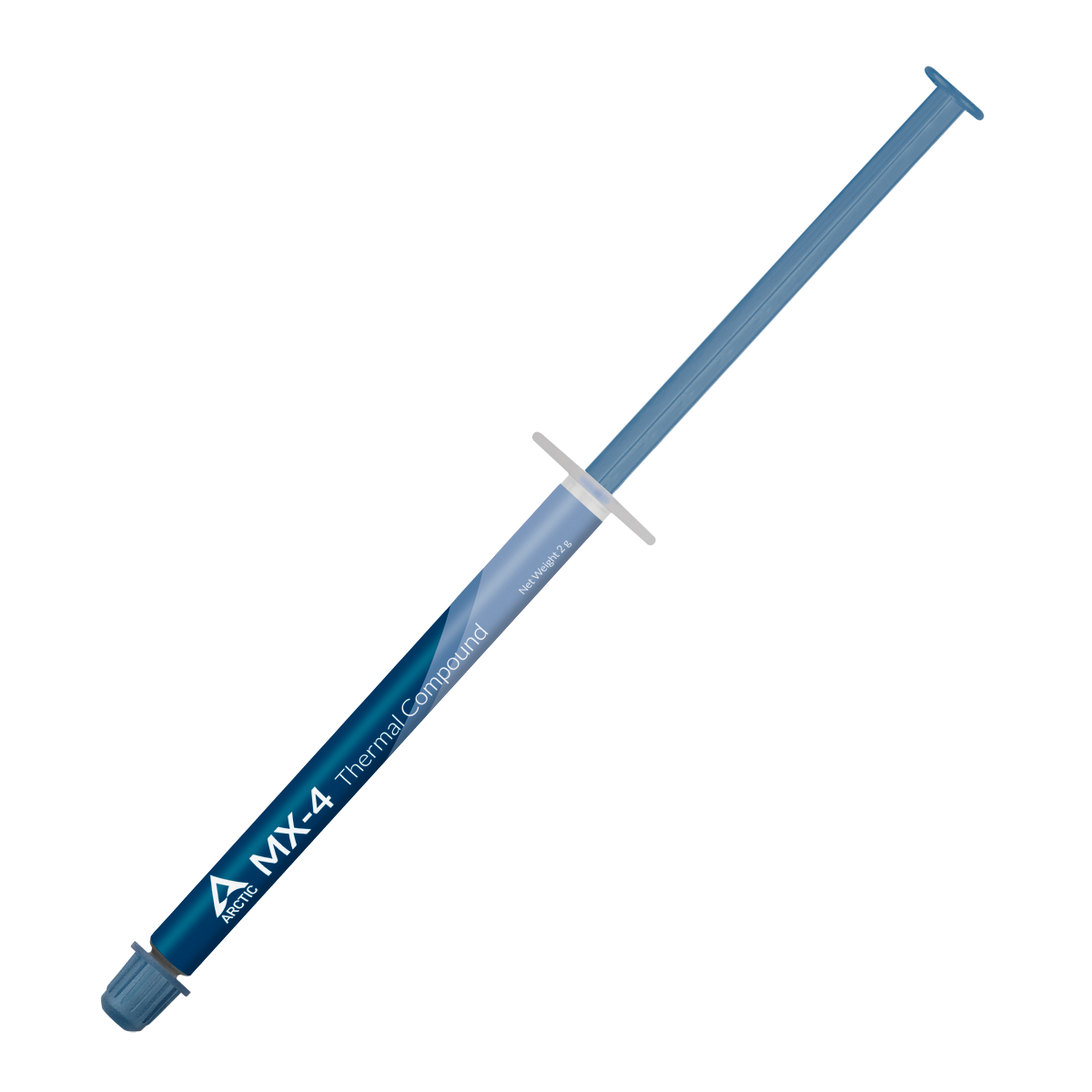

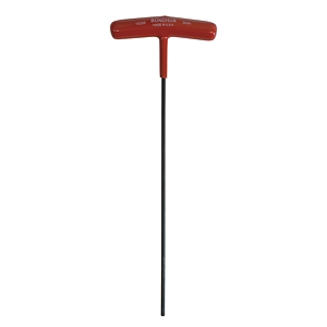

Get the proper tools and some good quality thermal paste. Be prepared to spend some time cleaning the dust when you take out the tray. I found cotton swabs worked well. The instructions are pretty clear in the Mac Pro Technician Guide <-- google search.
Bondhus 15356, 3mm Hex T-Handle 9 inch Length for the cMP 2009-12 CPU Tray Heatsink(s) :
ARCTIC MX-4 for the Northbridge chip , the CPU chips and most GPU chips :
Dynarex Cotton Wood Tip Applicators, 3 inch, 100 Count to remove old thermal paste and generally clean surface areas . These are static neutral because they are made with cotton and wood :
You should also use high purity ( 90-100 percent ) isopropyl alcohol as a solvent to remove old paste and clean surfaces . It dries quickly . I'd provide a link , but the CV scare has depleted all the online stores of alcohol .
