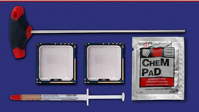

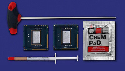

@Superlead
for your 5,1
for your 4,1
I can recommend georg mihatsch shop in europe!
also for samsung memory

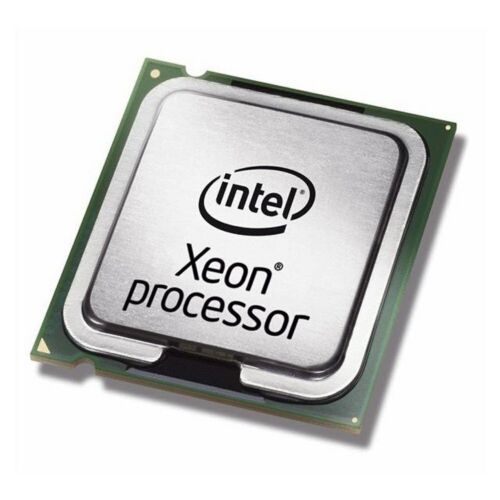

Just an update for anyone trying to upgrade.
Buyed a 2010 Mac Pro and upgraded successfully CPU and RAM. This pieces are hard to find here in Brazil, the CPU I buyed from a server part seller, but the RAM I imported from China.
OriginalUpgraded
Intel Xeon W3565 (4/8) @ 3.20Intel Xeon X5675 (6/12) @ 3.06
8GB (2GBx4) 1066 MHz DDR3 ECC SDRAM16GB (16GBx1) 1333 Mhz DDR3 ECC RDIMM
I use smcFanControl to create profiles on the cooling system. CPU temperature is doing pretty well, even on eventual high CPU loads. The default cooling profile I use is listed bellow, but only with the PSU fan at the lowest RPM possible. The PSU fan it is the most annoying fan in this setup, cannot set it to ~1430 or higher if not using headphones:
Fan locationRPMNoise level (Unit on the floor)
Exhaust~ 1430Low
Intake~ 1430Low
PSU~ 1430High
PCI~ 1430Very low
